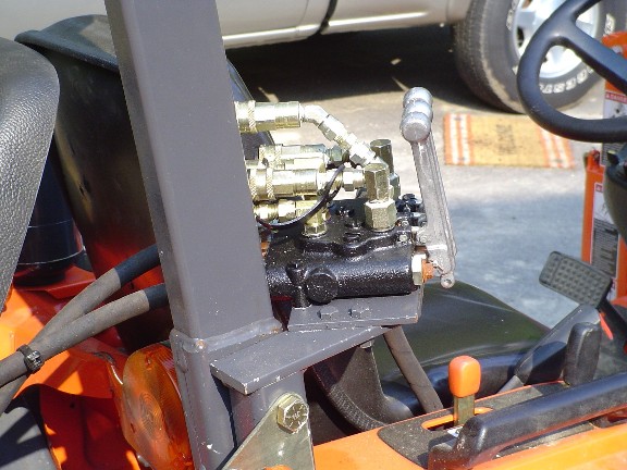

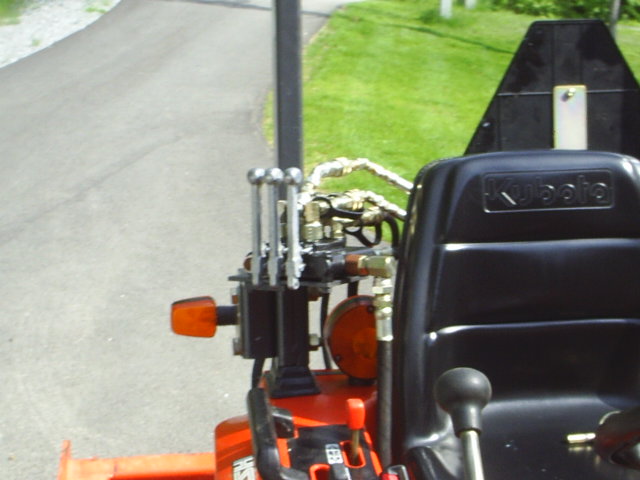

I have the 3 spool Eaton Cessna on mine and have been very happy with it. Let me know if I can help you with anything on it.

Hey 8561, that's a nice custom mount you have there on the ROPS for that valve. Even from the scrap bin I don't think I could have designed one better myself.:D :D :D
   / I think I understand hydraulic basics now #5
It's all in the engineering...;)...Actually, after having lived with it for quite a while, it really is perfectly positioned for my needs. When turned in the seat looking back at what I'm doing, with my arm laid on top of the seat, my hand falls perfectly on the handles. :D
