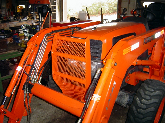

Hi Modn,
I have a grapple and was afraid I would put a limb thru the radiator while pushing debris. I got some expanded metal and welded it to the brush guard. In the months since I made it, I have seen dents in the expended metal...so I know it has done it's job.

Redbug said:
Hi Modn,
I sure am glad to hear that as I just got done welding and painting mine with expanded metal I had hanging around. I was wondering if the expandable metal would be enough as I basically pushed this limb until I heard the fan hitting the radiator...(didn't see it) but I figured if welded/bolted enough that the tractor would spin before it perforated it...hopefully!! I would rather bash some expanded metal than replace a radiator. I was designing a bolt on and just figured I should just do it permanently as I would probably need it when I least expected it. Did you put yours behind the tubes? That looks like a nice job. I never thought of that but mine turned out fine and will be totally functional also. I sure do not want to spend $500ish every time I go into the woods as I will be broke in no time....like I am now!!!

My method for those of you that want to do the same thing. I unbolted the brush guard from the tractor, and postioned it on the shop floor. Then I "C" clamped the expanded metal to the guard and traced the outline I wanted with a magic marker. I cut the metal, reclamped it to the guard and welded it to the frame and tubes of the guard. It probably took a couple hours futzing around to get it done. Then I painted it.
Modn, I welded mine to the front of the tubes and guard.
