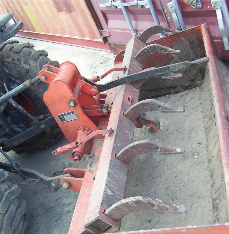

My L35 has a 6 foot gannon, heavy as hell. It has a handle that you pull up and drop and lock the scarifers.
