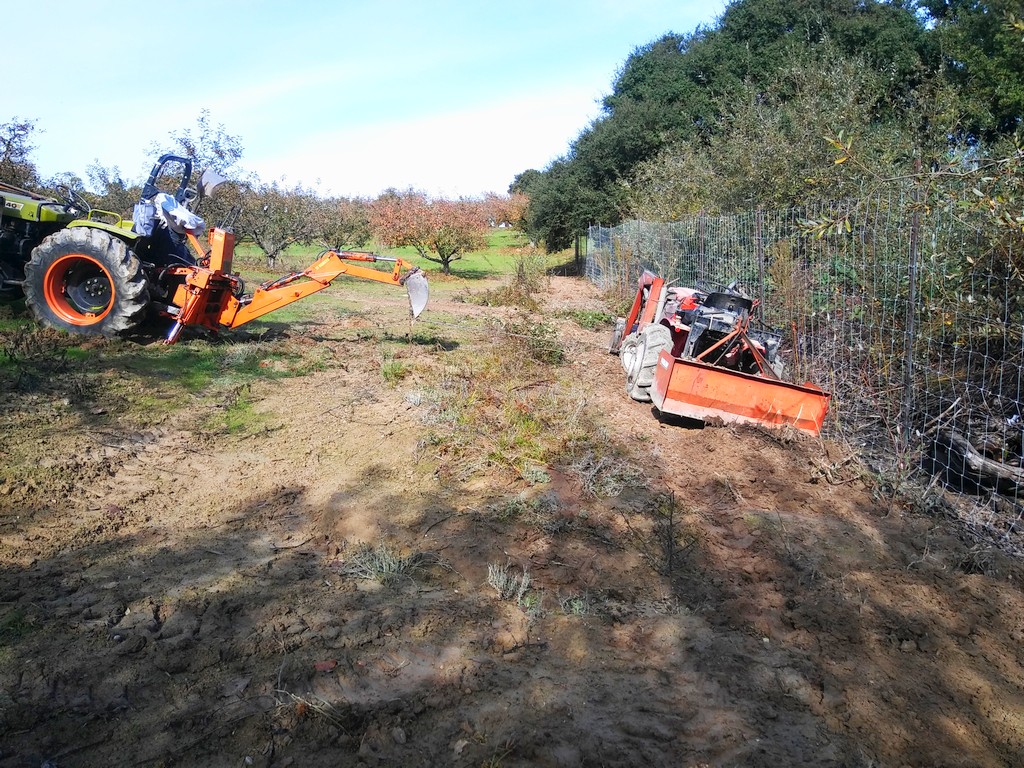

If you are thinking a 3-point hoe for your Yanmar, it will be so small as to be very limited. I think useless to trench with the tractor parked at a right angle to your trench. Or to dig to the side of the tractor. (I bent a 3-point arm doing that. BFH got it back to straight again).
I have the ARPS 3-point backhoe that was sold as OEM for my YM240 and it was also sold as OEM by Kubota dealers back then, 1980. My primary use is removing orchard stumps (photo) and I've also used it to grub out blackberry jungle, and to pop out scrub oaks that have roots intertwined with orchard trees. (photo). For orchard stumps, digging an excavation the size of a dinner table is the practical limit, any deeper and there's no reach so you have to move many times. At 750 lbs this BH is the limit of what my Yanmar can lift, the relief valve squeals as I drive around.
That Hoye link emphasizes that a subframe up to the loader structure is essential to get the severe stresses off of the transmission housing and bell housing, whether frame-mount or 3-point.
I think the Case has spoiled you to what a real backhoe can do. A little one just isn't the same thing.
Here's one to avoid. The US dealer claims 6 ft depth while the mfr brochure says only 4.6 ft.
And a photo just for fun, using the BH to tug the second Yanmar sideways, where continuing to struggle would have destroyed the new fence. After it was free I drove the little guy out still attached, like a pendulum, so it couldn't slide into the fence again. No fence damage at all.
