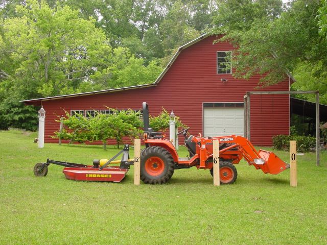

Here's a front view of the 24x36 (original) my 13 year old son and I built in 1973. Later another son helped add the shed additon another 24x36.
Bought "salvage" metal for roof.
