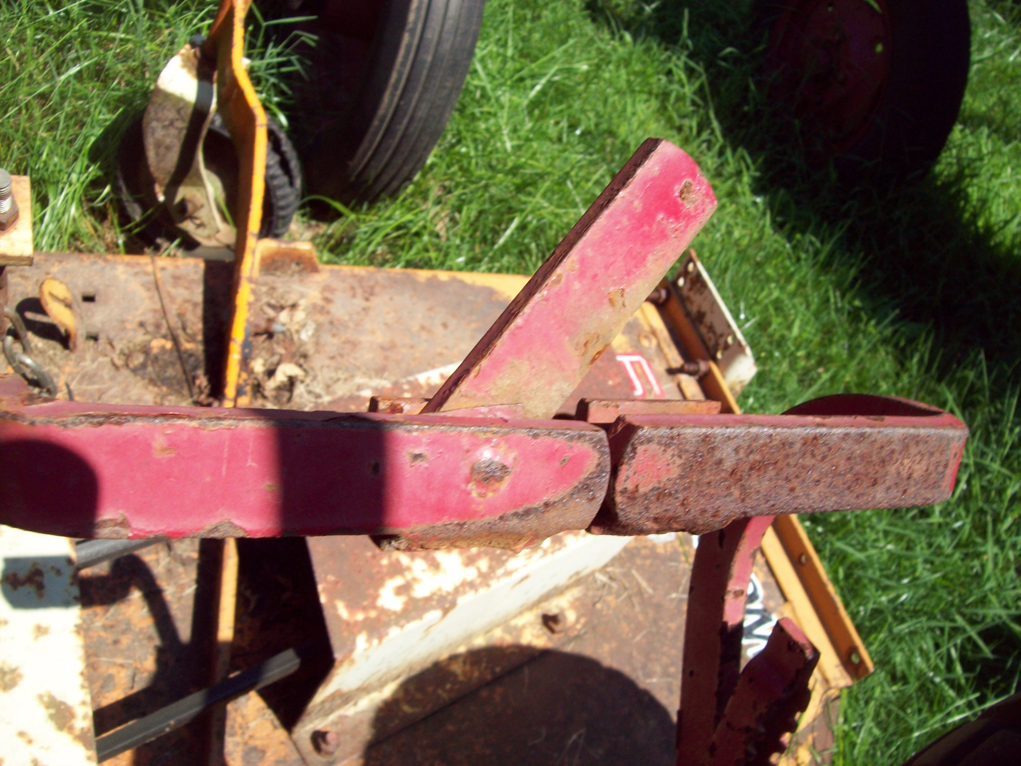

I use a Ford 660 tractor for club tractor rides and I would like to temporarily tie rear brake pedals together whenever I am on the road. I was wondering if anyone has done this before, so that I don't have to reinvent the wheel. Thank you in advance. Klink

Like this?
All of my tractors have a lever behind the brake pedals to lock them together.

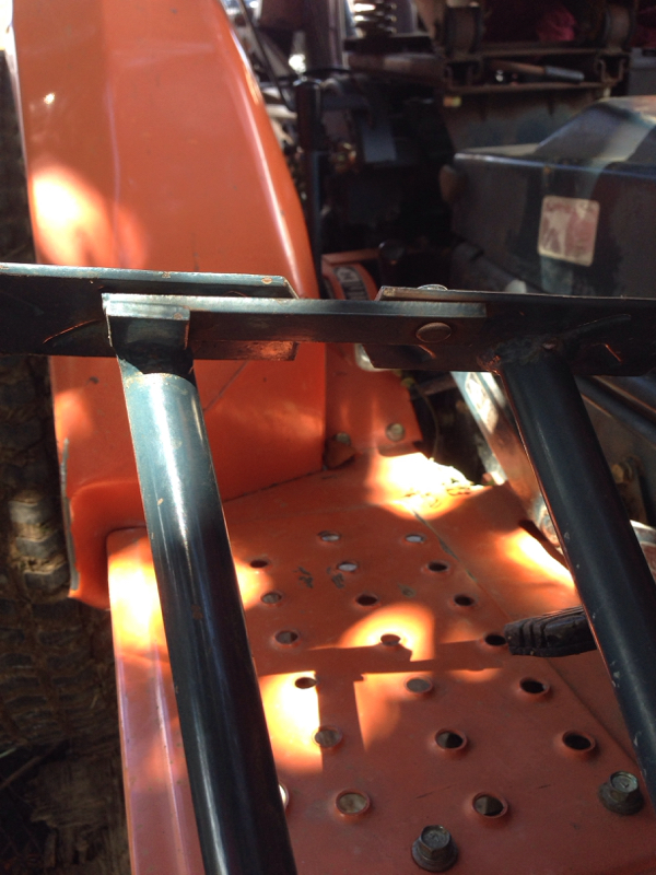

You can add a piece of steel that flips over when you want to use both together and flips back for separate use when you don't need it like on my farmall cubs. I know one of your pedels are angled, not straight across for one another but it still can be done. You will probably have to grind part of the hump under the pedal to made it flat. Another option may be to add a barrel bolt lock like on the later ford square nose tractors. I don't have anything past '65 so I can't help you with a photo.

I grew up with a Jubilee and a 600 and I don't think you can do what you want to do. it would be easy to tie the pedals together but you will still be hitting only one brake according to what side is adjusted highest. Those tractors had one week link and the brakes are it. Ed
