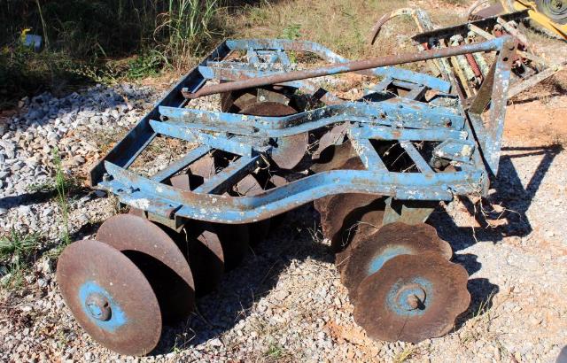

Hi guys. I've been needing a heavy disc, known around here as a "bog disc" to try to level out about 2-3 acres of my back field. This one came up on auction locally and looks like it might fit the bill. Especially if I chain down about 1,000 lbs of tree trunk on top.
Anyone recognize the maker? Any opinions about the sturdiness of it's construction? I'm not too sure about the "serpentine" frame. What do I need to check about it's condition other than the disc and bearing/axle condition?

Keep looking, waaaaay to small and light duty. If you put 1000lbs on top, I venture to say that you will have scrap metal in a very short amount of time.
Keep in mind that light duty implements are not intended to be heavy duty implements and are not structurally built to handle such tasks.
If you need a 1500lb-2000-lb set of disks, that is what you need to buy or rent.
Also remember, with bigger tractors, bigger implements are typically also needed. They sort of go hand n hand.
Good luck

I concur with Brian.
Disc Harrows are secondary tillage implements, originally designed to follow a plow, smoothing plow furrows.
As tractors have grown from 25-horsepower in the late 1930s, when tractor drawn, Three Point Hitch mounted Disc Harrows were designed, some Disc Harrows have become heavy enough to accomplish primary tillage. This category includes Offset Discs and Tandem Disc Harrows with 24" diameter pans.
Assuming you have 4-WD, your L4330/HST can pull a Box Frame Tandem Disc Harrow with 20" diameter pans in HST/MED and 4/5 throttle, through previously broken ground. This is not really heavy enough to provide primary tillage. You will likely have to use another implement to make the initial soil cuts. A plow would be ideal. Improvisations include a Subsoiler or Middle-Buster. For your three acres you could also use a PTO powered roto-tiller if the soil is soft and you have time. Georgia red-clay is tough.
To improve cutting ability of a Disc Harrow, shorten the Top Link. This lifts the rear, smoothing gang; shifting weight to the forward cutting gang.
http://www.tractorbynet.com/forums/attachments/308251-disc-harrow-selection-18-45-a.html?highlight=
Bog Discs, a small category, "normally" have only the front 'cutting' gang of pans, the rear 'smoothing' gang is omitted.

Nice antique disc. A good restoration project, but not what you want for your job.

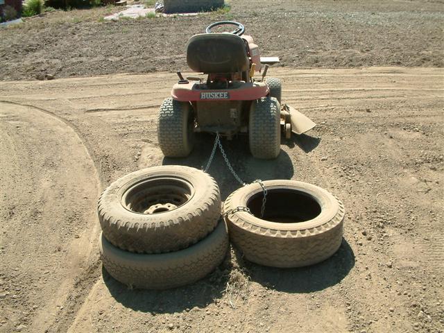

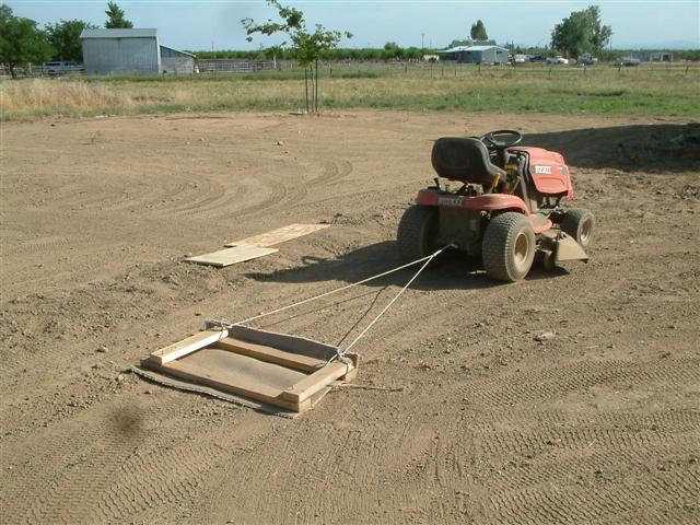

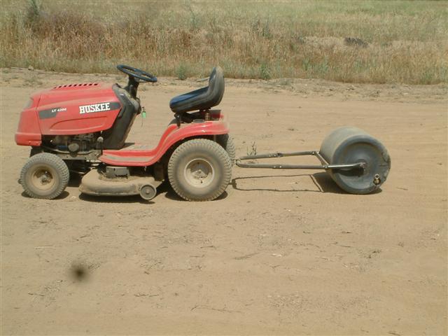

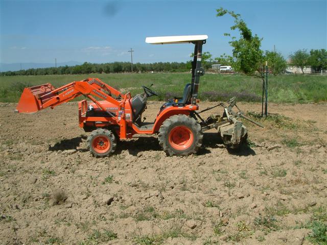

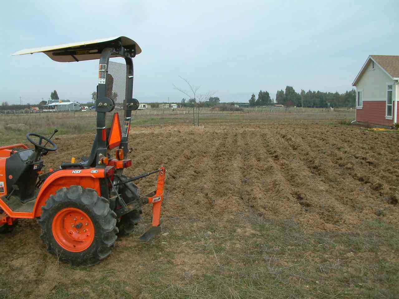

When I put in landscaping (about 1/3 acre) at my ranch 11 years ago, I had a new 2005 Kubota B7510HST tractor (21 hp engine, 17 hp pto), a King Kutter combination middle buster plow/subsoiler ($150 from Tractor Supply) and a 48" Yanmar RS1200 rototiller ($250) from my local grey market tractor dealer.
Use the subsoiler first followed by the rototiller. To smooth the soil I just used my Huskee riding mower with a water-filled roller and several DIY drags.
Huskee roller.JPGHuskee tire drag.JPGKubota rototill-1.JPGKubota-middle buster-1.JPGHuskee carpet drag.JPG
You don't have to spend a lot of $$ for a job like yours. Just use what you have and improvise a little.
