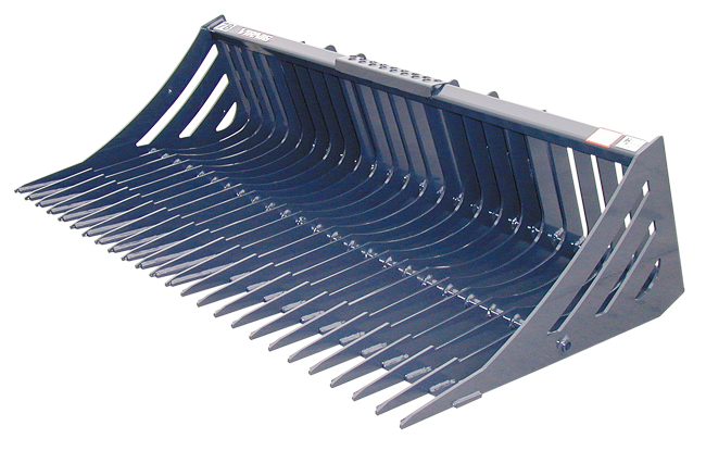

   / Ideas for a rock picker #6
I almost bought a rock bucket. If I didn't need two different interface changes at about 1.5k I probably would have done it. Here's the one I looked at.
   / Ideas for a rock picker #7
I bought a Bradco Bradco rock bucket at an auction for $1K. It included the mounting brackets. The brackets had to be modified to fit my tractor, $25 but it was a bargain. They retail for between $1300 to $1500, don't know if that includes the mounting brackets. Look around, you'll find what you need.
