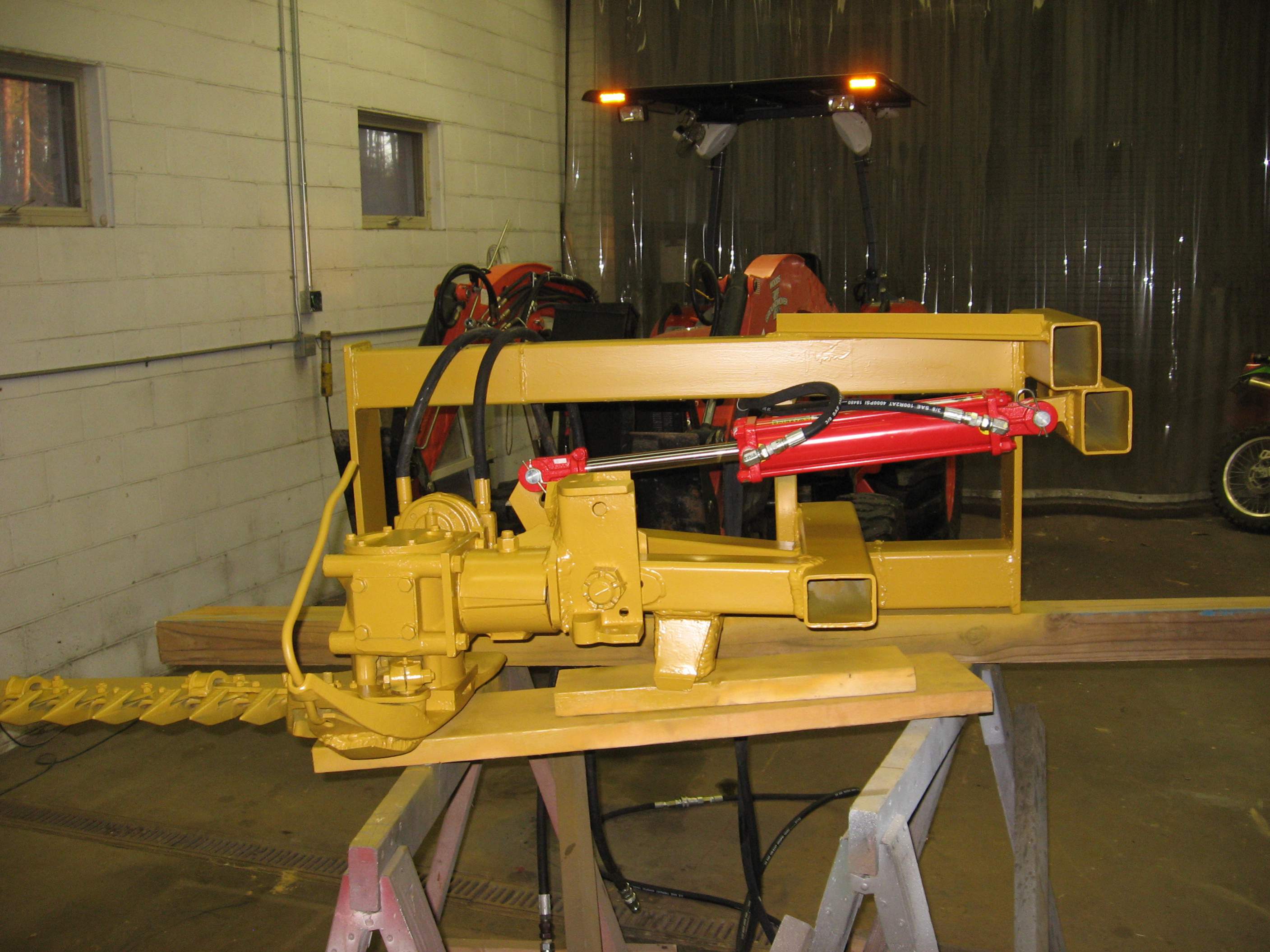

I want to build something that I could mount to an ATV or ATV trailer or small tractor that would cut the branches that grow into the local trails, mostly spruce 3/4" diameter max. Is there anything like this that exists I could copy. I have seen snowmobile trail groomers that have an old style hay mower mounted vertically. What would cut best, rotary blades such as a bush hog, flail mower, hedge trimmer style?

There's one that looks like a sickle bar mower that is upright, but the name escapes me. (Sabre or maybe Samurai?)

Yeah that sabre samurai looks like what I want, I will look into it further.

The samurai is listed at $1450.00, that is more than I wanted to spend but if it works I will pay that. I was going to try and mount a ride-on lawn more deck vertically to my fel and maybe power it with a cheap 13hp engine or hydraulic motor, but this seems much simpler.

I made this it will cut 3/4 hardwood branches and pine around 1 inch or more. It will cut in vertical position as high as 12 to 13 feet. Before I made it I cleared 2 miles of horse trail with my 4 in 1 bucket. Anything small the side cutter on bucket will just cut it off large stuff can be pulled off or broken. Bucket is not as fast as sickle mower but will get the job done. I looked hard at samurai before building mine. Some old posts about breaking and gears being destroyed plus cost sent me in this direction.
