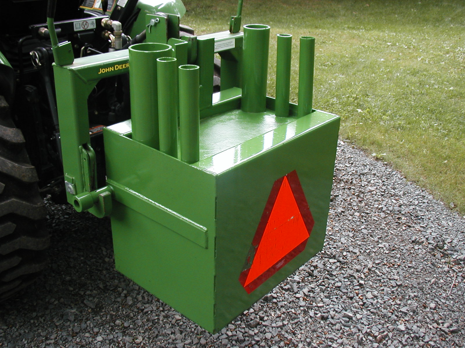

Hi all. After reading the 100 or so posts on Ballast Boxes, I have decided to make my own... The $200+ JD ballast box is good looking and functional, but being a carpenter, I decided to make my own forms and pour concrete...
Now the question: I am going to end up with a big peice of rock. besides adding PVC tubes and a recess for tools, painting JD green etc... I was thinking of using one of those aluminum 12x18 embossed signs (you know nothing runs like a deere + JD logo) to spice it up. if I put my sign in the form, it should come out in the concrete right? my neighbor thinks It'll never come out right... if i tap on the form (aka vibrate) it should look great right?
Any thoughts, suggestions, alternative ideas etc?
   / Ideas for my new Ballast Box #2

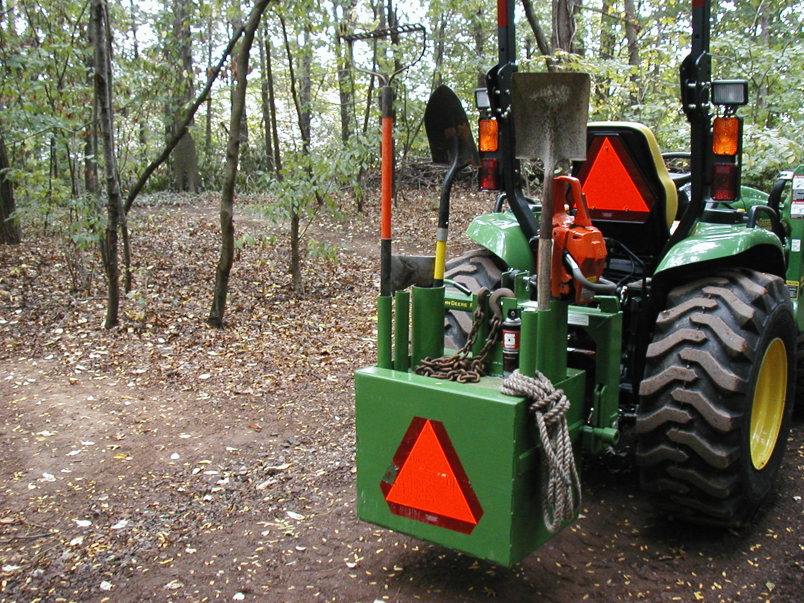

Yes, a couple of thoughts, first don't use pvc, if it breaks your kinda stuck, I did mine with pvc and after realized I should of used steel, put a couple of 4" pipes and a couple of 2" pipes, with the larger pipes you can put a chain saw in or a hand held leaf blower.
Also maybe a receiver tube, not for serious towing cause then you wouldn't need the weight but just for moving something around the yard, plus there are so many acs now that go in the 2" receiver.

Great ideas! yeah the steel pipe will add lil more weight too! thanks!

Good work, looks good. By the way, is that Shindaiwa chain saw I saw in the second pic? If so, how do you like it. couple of months ago I bought one, it well built and actually spec better than Stihl in my opinion.
JC,
   / Ideas for my new Ballast Box #6
How ya doin JC,
No it's a little husky I inherited from my buddies dad, this one is a little temperamental and tired but still runs decent, I have heard good things about the Shindaiwa. I'll tell you if I had to get a new one I would stick with these little saws, they can handle most everyday tasks perfectly fine and they're so light, I have a fairly large husky (just below serious lumberjack status) I acquired thru a barter with a husky company representative that I worked for, didn't really need it and have hardly used it but I couldn't pass up the deal, he gave me all kinds of goodies with it, like extra chains and bars plus all kinds of safety gear and oils. it's kind of a shame it just sits on a shelf.
