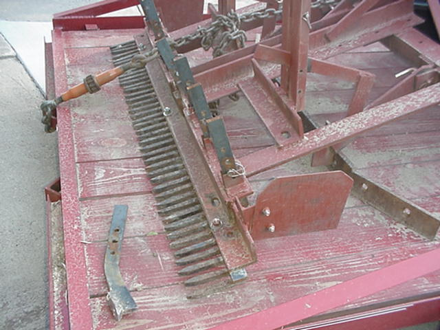

Here's what I call my LS1( A.K.A. tr3) IT works great

A couple of questions on your LS1 please:
Your scarifiers are near the rear. I'm assuming you can't back up and move dirt without raising them, correct?
I don't have rear hydraulics (yet), but I would like to build mine so that I could raise/lower the scarifiers by moving one lever. Any thoughts?
The TR3 has gage wheels that control the depth. Have you noticed a need for them?
THKS.
Ron

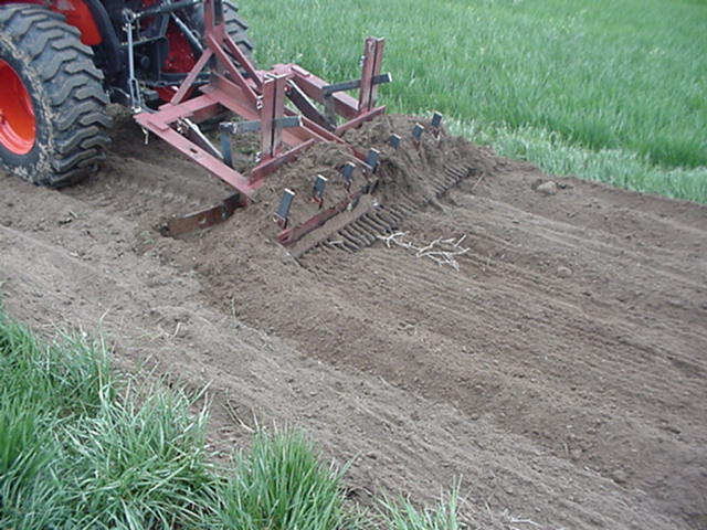

   / Ideas for Seedbed Preparation Implement #7
I think the gage wheels are used for back filling dirt(so the fingers don't dig in to much). The ripper blades are drilled for a depth setting of 0 or 2 or 4 inches, only takes about 2 minutes to change the depth. The back end (right in front of the fingers rides on top of the ground) the buildup of dirt by the rippers helps break up the clods. I don't plan on putting gage wheels on, I do lock down the grader blade an use it like a box blade some times. If you do build one I think the weight should be around 400 to500 LBSof this size. I pull mine with a 7510 Kubota 4x4

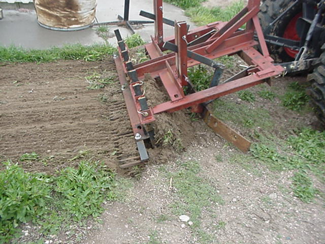

   / Ideas for Seedbed Preparation Implement #8
I did trash two ripper blades the other day doing a new yard. Going to fast, glade the blades bent and not anything on the tractor broke. BIG ROCK
