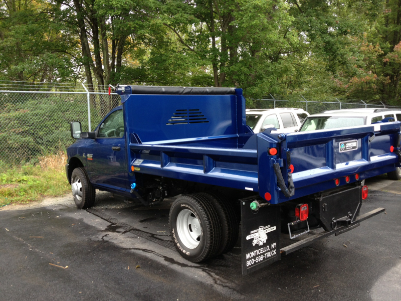

Hi guys,
My dad just picked up a 2011 dodge ram 3500 w/ a dump on the back. He made a comment about wishing it had a nice place to put his tools. I was wondering/hoping that some of you guys have a similar rig and have come up with some ingenious storage solutions.
If you do have suggestions links and pictures are greatly appreciated.
Attached is a picture of his new truck!

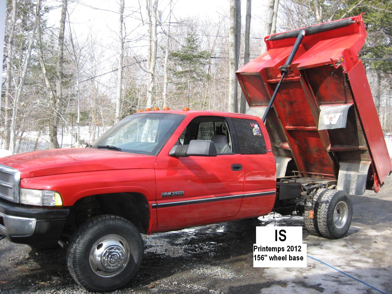

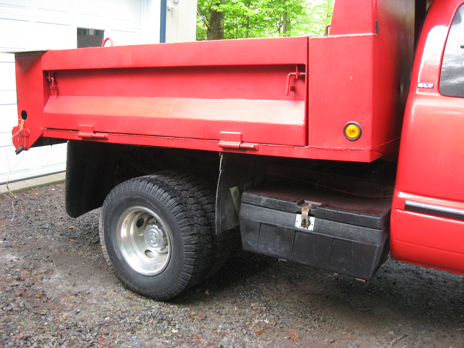

Yes, I have one similar truck and a plastic box under the dumper does the job(2X-2x2''L'' shaped angles) bolted to frame at each end of the plastic box does the job.
