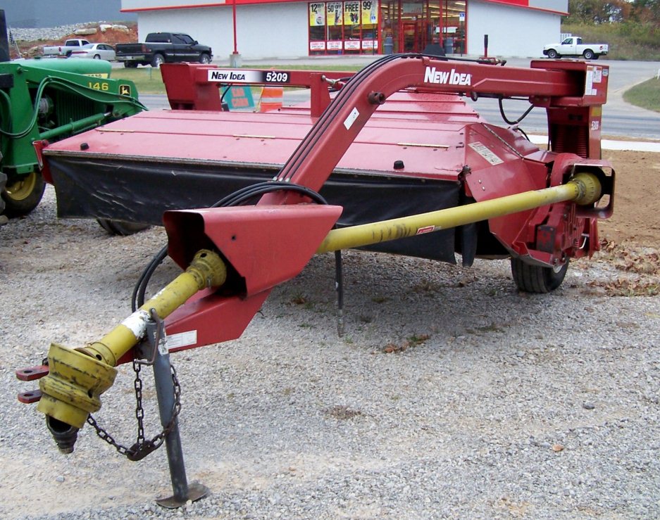

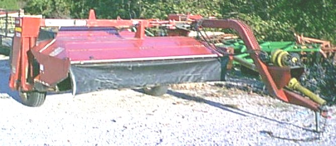

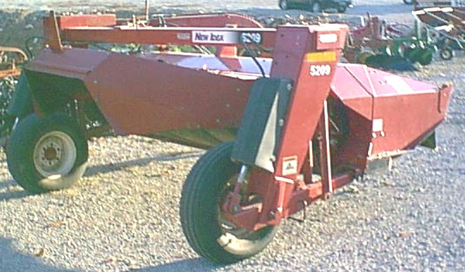

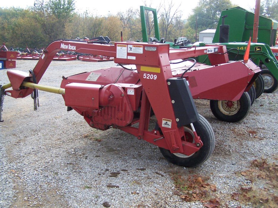

The New Idea 5209 is the most common around here for Alfalfa. We have a nice one for $8500. Ken Sweet
