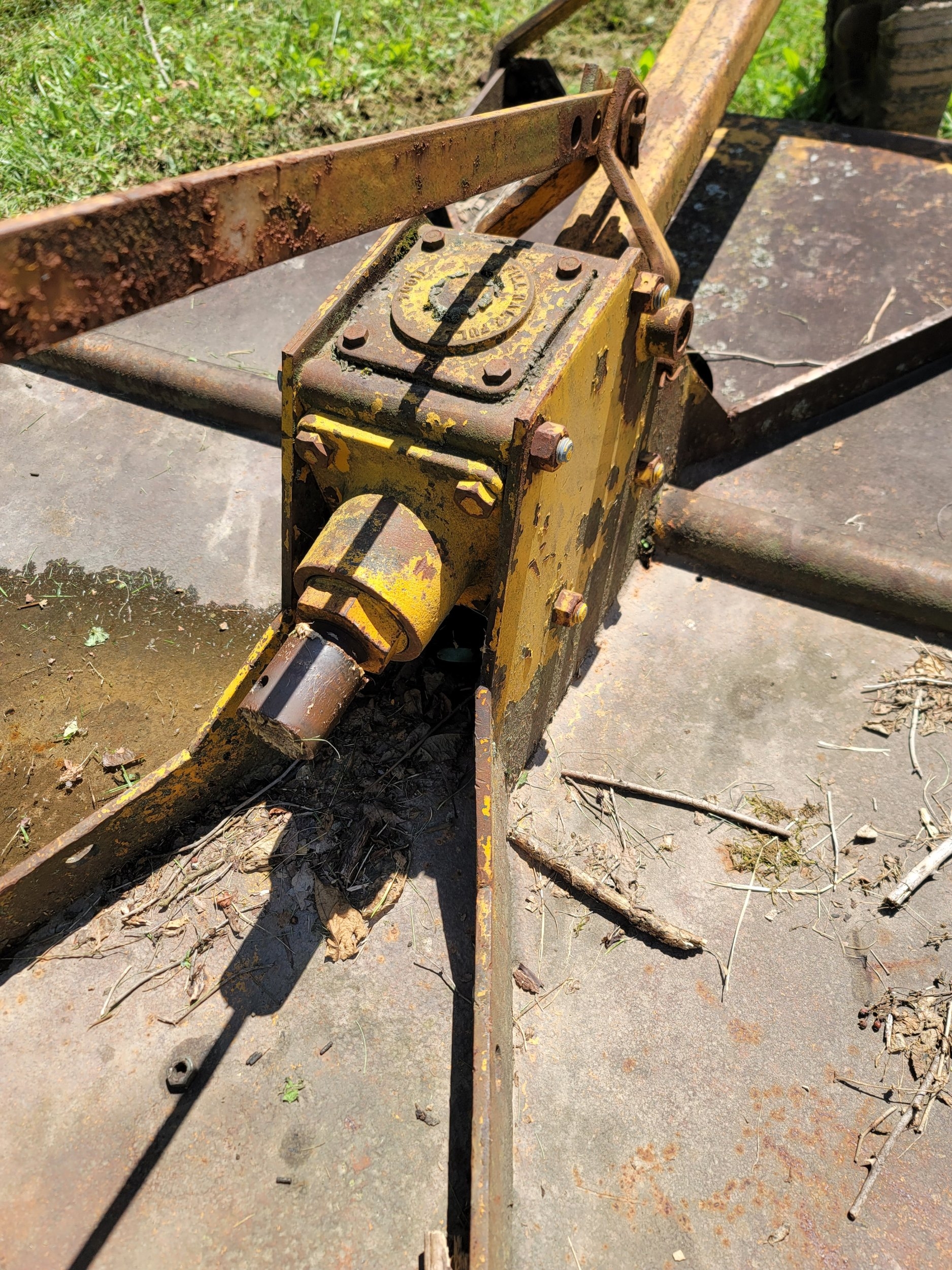

identify old brush hog/looking for pto shaft

this pto has a smooth yoke at the mower deck end that measures 2.110 ID

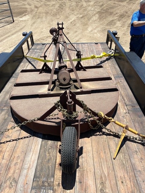

Nice HD unit. Love the construction of these older mowers.
I recently picked up an old Brush Hog model 12. It's built like a tank like yours.
What is a 2.110" ID? ID of what? Did you mean OD? Looks like some sort of sleeve or shaft remnant that should come off first, to me. Maybe not, is that a shear bolt hole?

sorry thats the ID of the yoke that broke. Which yes would make that the OD of the gear box on deck. And yes that is a shear bolt hole.

You can buy a new yoke, if that's all you need. TCS has/can order them too. The trick (for me anyways) has been to figure out what "series" the u-joints are...

unfortunately that's not all I need lol. I wish. But where it attaches with the shear pin that part of the yoke broke.
