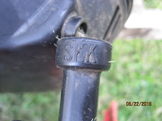

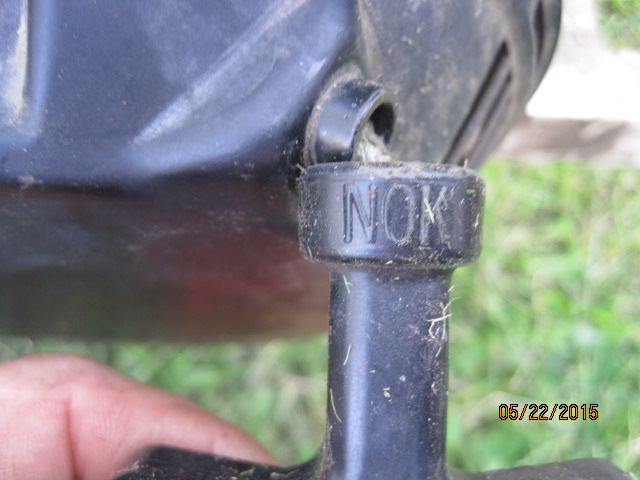

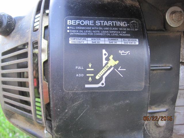

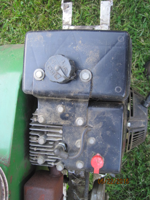

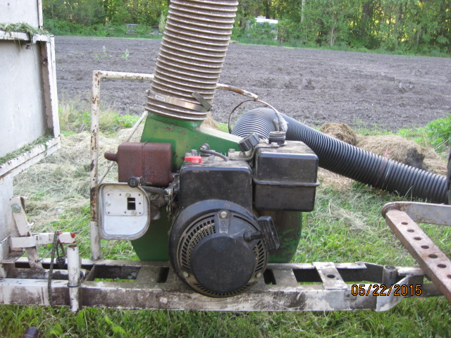

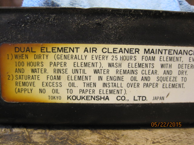

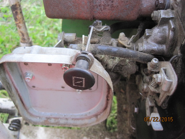

This engine is used on an older EZ rake or Trac vac. I do not know if it is a replacement engine or not. there are no markings on it except the pull cord has SSK and NOK on the handle. I am concerned because the gas cap is marked with a fuel to oil mix of 50:1. The air filter is by a Japanese firm: KOUKENSHA. It has oil ports on the bottom of the engine. I inadvertantly have been running it on regular fuel and then I noted the marking on the top of the fuel cap!!!! I am afraid to ignore or use the 50:1 ration mix.
Any info would be helpful....
Thanks...rockydocky

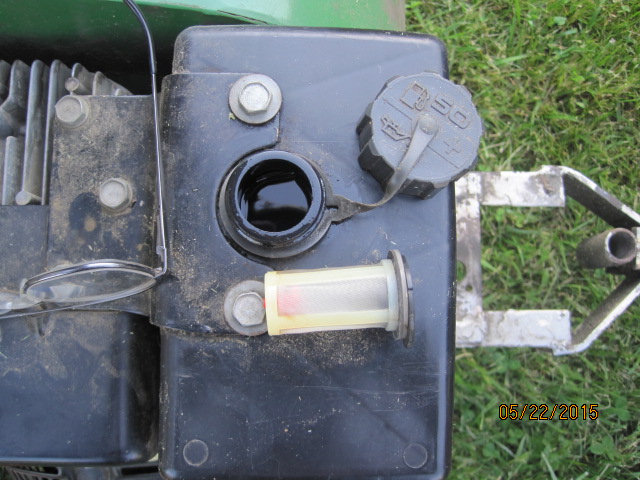

Someone replaced the fuel tank filler cap with an inappropriately marked piece.
The engine is a four stroke with oil in the crank case that full fills all lubrication requirements.
But don't forget.. " engines run better and last longer with Marvel Mystery oil in every fill up!"
   / ? Identify this 1 cylinder 4 stroke engine that requires 50:1 fuel/oil mix? #3
what Calg said. Cap looks plastic and the original cap was metal. Good engine though.
   / ? Identify this 1 cylinder 4 stroke engine that requires 50:1 fuel/oil mix? #4
Yep, some goomer put a two-stroke fuel cap on a four-stroke fuel tank! Reminds me of people that converted those early GM diesels to gas engines but left the diesel stickers on the fuel filler. :rolleyes:

Do you see a place to add oil??
I don't know about your engine, but I have a Still FS 90, 4 stroke weed wacker that requires a 50 to one mix. They call their motor a 4 mix.
It has valves just like a four stroke but holds no crankcase oil.

Gentlemen: thank you for the quick responses. BUT....the gas tank is plastic and match for the plastic gas cap. Have you encountered a Briggs/S or Tecumseh that has a Japanese air filter? Could this be a Japanese engine? The SKK on the pull start matches a Japanese motor bike company but i could't find any 1 cylinder engines on their web site. The small filter that fits into the top of the gas tank is also unusual to what I have ever seen with B&S or Tecumseh. Any clues here?

Pull the plug and check compression to tell if it is a two cycle.
There are larger two cycle engines that have a separate crankcase.

I have an old Kawasaki FA210D that has the same muffler and red switch,but the carb and tank are like an old 5hp Briggs.The motor looks the same otherwise.

Pull the muffler and see if there is a valve behind it. I think it is a two stroke myself.
