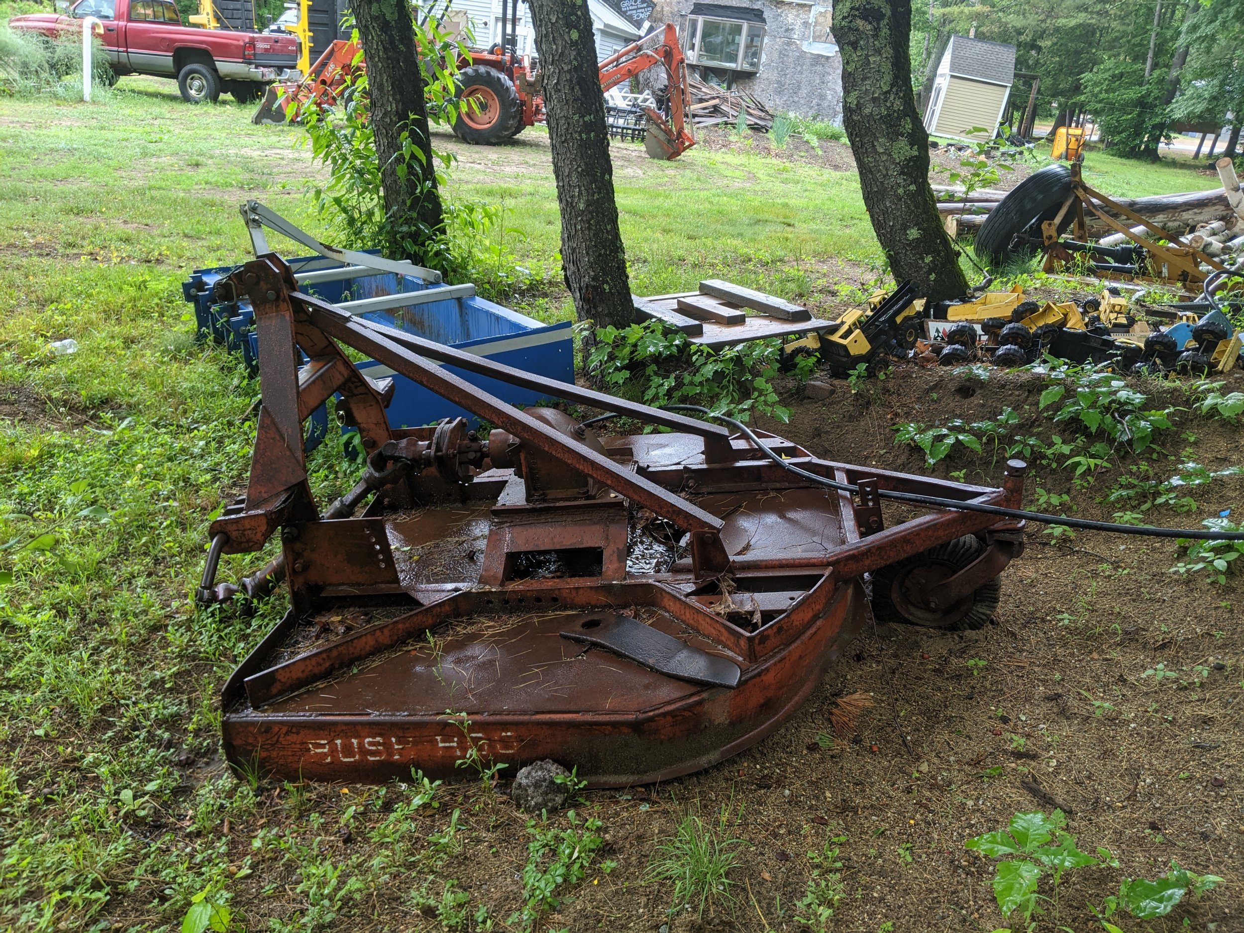

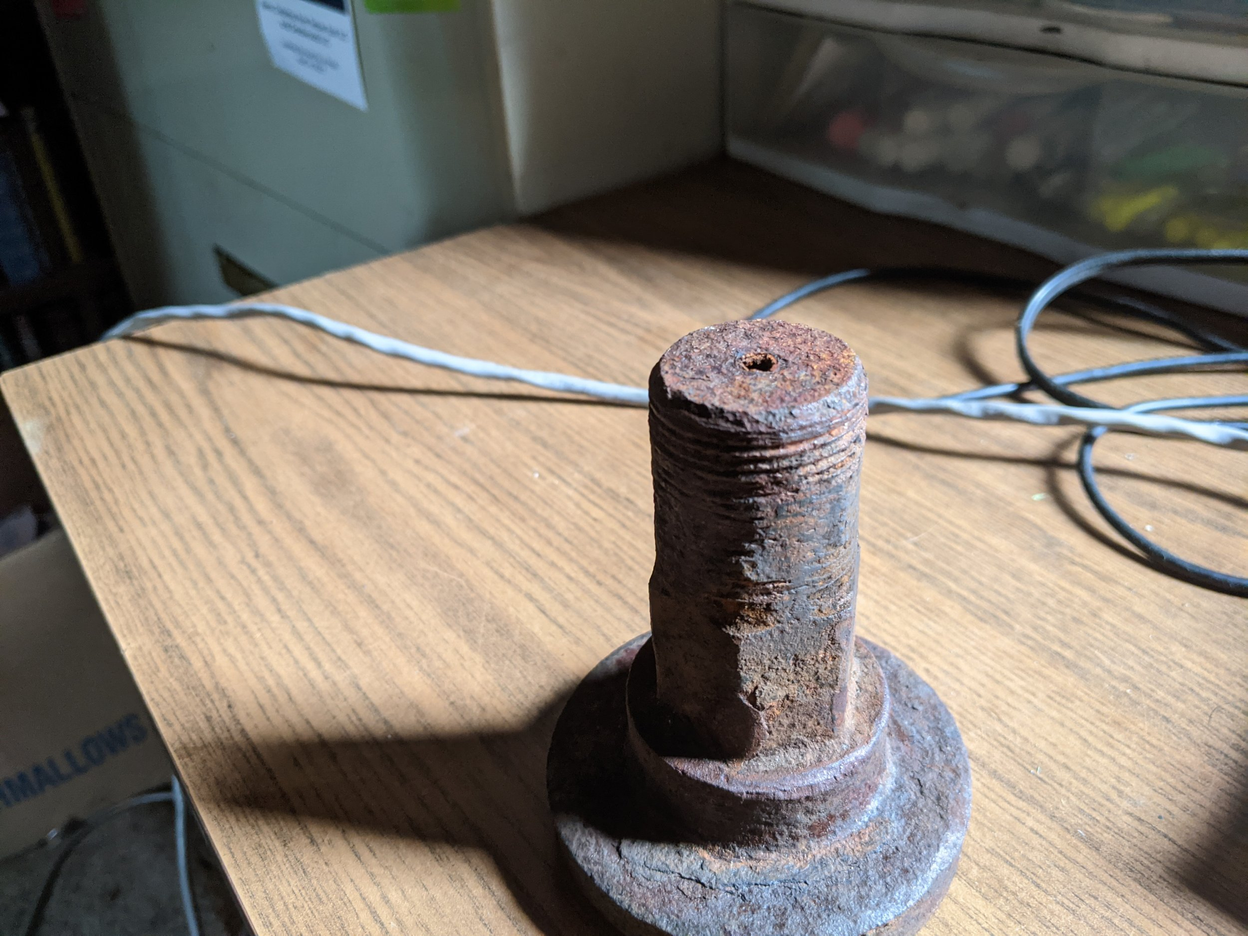

I have a Bush Hog brand Rotary cutter I bought off a guy used. One of the Blades came of last fall when I was using it. I found the blade and Blade bolt but not the nut. Needless to say I need to replace the whole assembly the threads on the blade bolt are too beat up at this point to hold a nut. Called around to all the bush hog dealers without a model number no one has any idea what the blade bolt number could be. The rotary cutter is a 60" diameter. The blade bolt is 3 3/4" in diameter at the head and the threaded part is 1 3/8" diameter fine thread (12 TPI). Any thoughts would be appreciated.

63607 is a 6 piece blade bolt kit that most any Bush Hog dealer will stock. It contains 2 each of blade bolts, lock washers and nuts. Fits all but a handful of Bush Hog rotary cutter models built in the last 60 years. Absolutely will be correct for yours.
   / Id'ing a Bush hog Brand rotary cutter #4
63607BH contain 1 1/8" - 12 bolts w/ keyway. His are 1 3/8" hex.
