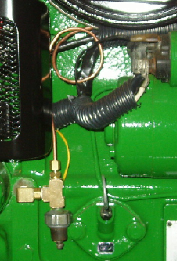

I have a 1500 (same engine but 2wd) and replaced the gauges with Sunpro 1 1/2" set...work GREAT. I needed the metric adapter for both the oil and temp gauges.
Before you cut holes for the new gauges make sure your old sending units come out without problems.
For the temp guages just screw the correct metric adapter (2 or 3 options in the Sunpro adapter kit) in where your temp sender was. Then screw in the new temp sender included with the guages.
For the oil pressure I and others have placed a "T" (also available from Sunpro or NAPA/Autozone/etc) to allow both the pressure line and the old oil sender with idiot light for a backup. You can use the supplied nylon type tubing for the oil pressure or use copper (yes...another separate kit from Sunpro). This sounds like a lot of extra 'kits" but most of them are only a few dollars each. When you put in the metric adapter and put together the other parts DO NOT USE Teflon tape...it can clog the ol ports/passages inside your engine and cause BIG repair/rebuild problems...or so I hear. Use the cream/paste type stuff in a tube...it is usually good for up to 500 degrees.
I have included a couple pictures of mine so you get the idea. Ask if you need more help. It is really an easy project.

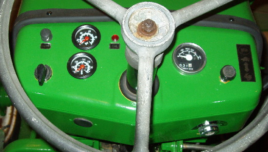

This is how I did my dash...one of many options. Many mount below the dash to avoid cutting into their metal instument panel/dash. Cutting these hole was by far the hardest part! The red light is the idiot light next to the oil guage...just there in case and for extra margin of safety.

When running my temp runs 160-210...I believe the temp idiot light was set to come on at about 235 degrees.
My oil pressure runs 20 - 45 when idling to working....maybe a lot higher when cold and over 100 RPM
