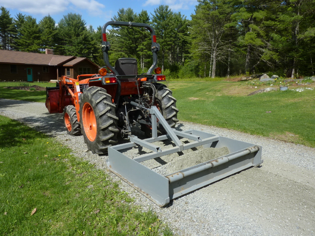

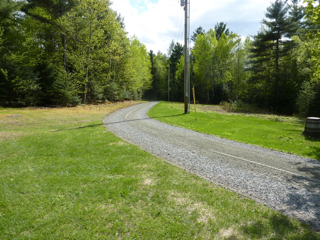

If you have a long driveway to maintain then a Land Plane Grading Scraper with Top and Tilt will certainly help you do it.
I graded today for the first time this year. It is so enjoyable to use this equipment. Some how I forget over the winter how easy it is to do a good a job.

Sweet rig, nice gravel you have there too ! :thumbsup:
   / If You Have a Long Driveway to Maintain ...... #3
So that's what a lane looks like without weeds growing in it! :thumbsup:

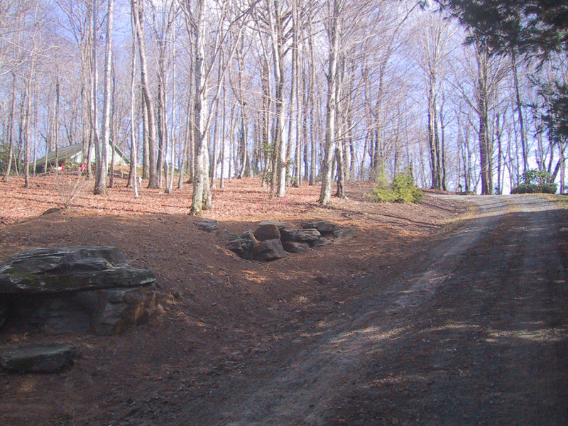

Can someone help me understand a question that's been bothering me for a while? I see lots of members here who really like the use of land planes or box blades for maintaining gravel driveways. But it seems to me that what either mainly does is move gravel along the length of the driveway, as show by the OP's first photo. That would be good for filling potholes or washboarding, I'd think.
But that's not my problem. I have a quarter-mile driveway, fairly steep, in the mountains of western North Carolina. Here's a photo of a part of it.
My problem is moving the gravel back on the road after it's thrown to the side by traffic or plowing snow. I find an angle blade works well for that, once one learns how to use it. I'm having trouble seeing how a land plane or box blade would work as well. What am I missing?

You are dead on - not missing a thing. I also use a blade. It is a great road tool. If you want to chage the road contour or move material across the road a blade is the way to go. Just like you said.
But once the road contour is set you can maintain it very easily with the land plane. The secret is to not allow the contour to get ruined by rain or plowing. In the winter I never plow down to the gravel. I keep the plow up until a solid packed snow road is formed. I actually make the snow road much wider than the gravel. With the solid snow road I don't throw gravel off to the side when I drop the plow. I guess we are lucky we can do that because things freeze up so well here. Handling runoff on a steep road can be tough. It seems some time along the line there is always a storm big enough to cause trouble but if you can get your drainage set for the vast majority of storms you won't have so much blade work to do fixing washed out gravel and the land plane can then become the go-to day in day out road tool.

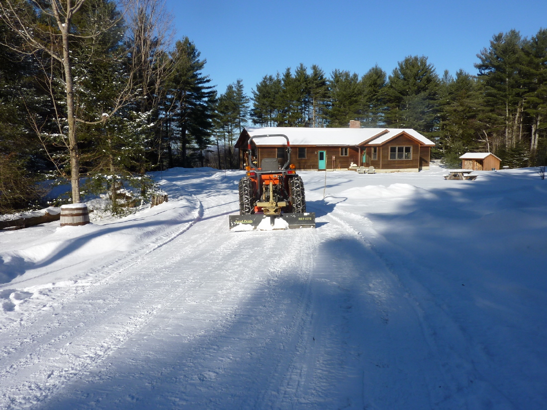

Terry, your drive is long enough that if you can at all afford it, you should get yourself a (LPGB) land plane grader blade. Each implement has it's purpose and excels at what it is designed to do. You need your rear blade to pull gravel back onto your road. But once it is there, it is tough to beat a LPGB for simple maintenance. The other thing that you will find is that the grading time is quite a bit less, and with it taking less time, you find yourself doing it more often. When you do it more often, the road simply never gets bad. So what ends up happening is that you need the other road implements a lot less often than you do now.
This is what has happened in my circumstances and of course everyone's conditions are different, but sort of like grapples, there are NO BAD ONES
and everybody seems to be happy with what they have. Zero complaints.
Just my :2cents:
Thanks for the reply, Gordon.
We are at 3500 ft. so it gets cold enough to snow enough to plow several times most winters. But we are on a long narrow mountain range in the midst of southern lowlands, so we generally get periods with above freezing night-time temps in between. As a result, we often have plowable snow when the ground isn't frozen. But for the same reason we can't leave the snow above the gravel - it thaws enough to freeze to ice, which is a real issue with a drive with an average grade of 14%. As long as there is some gravel poking through the ice we can get up with no problem with 4-wheel drive, but if it gets above the gravel we're done until it melts.
The result is unless the ground is frozen I can't avoid pushing some gravel off the side as I plow. I suspect the grade also encourages vehicles to throw gravel, especially pickups that don't have or refuse to engage 4-wheel drive. UPS trucks are the worse - they use the little ones with single rear tires here and they really tear up the gravel. We have pretty good ditches, so only rarely does rain runoff carry enough gravel off to clog the ditches.
