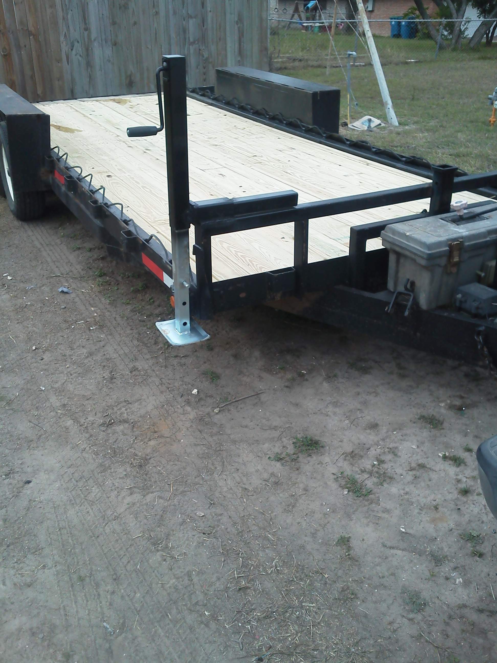

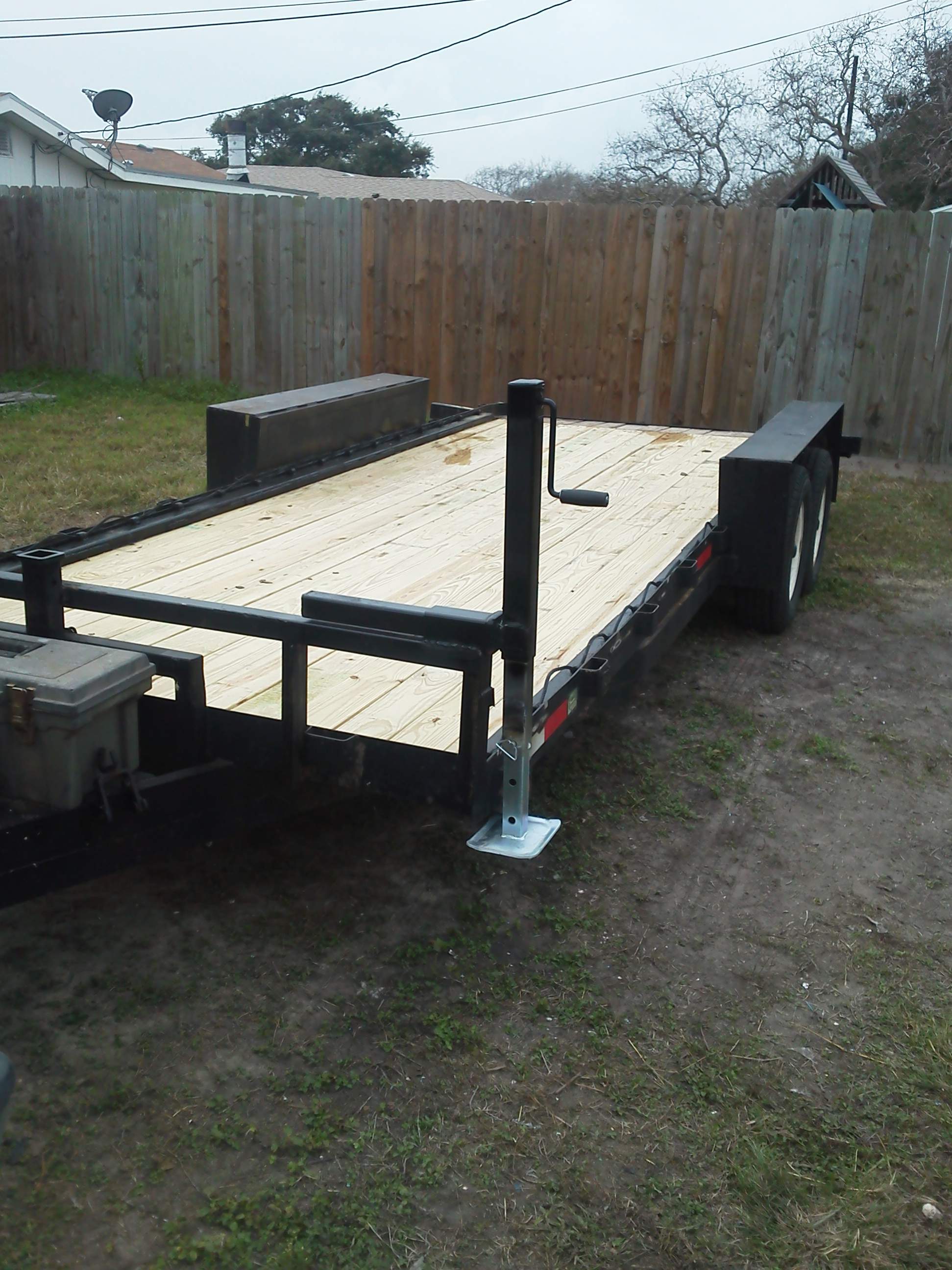

not haveing the bed flush with the sides is an issue for me. from the looks of it the floor should sit ontop of the beam on the sides then the decking would be flush with the outer edge.
Not a fan of the jack setup. You might get $1800 for it if it had a HF winch on it. otherwise its a solid $1500 IMHO
Are the fenders bolt on? those fenders make it useless to haul cars on. youll be climbing out windows like the Duke boys

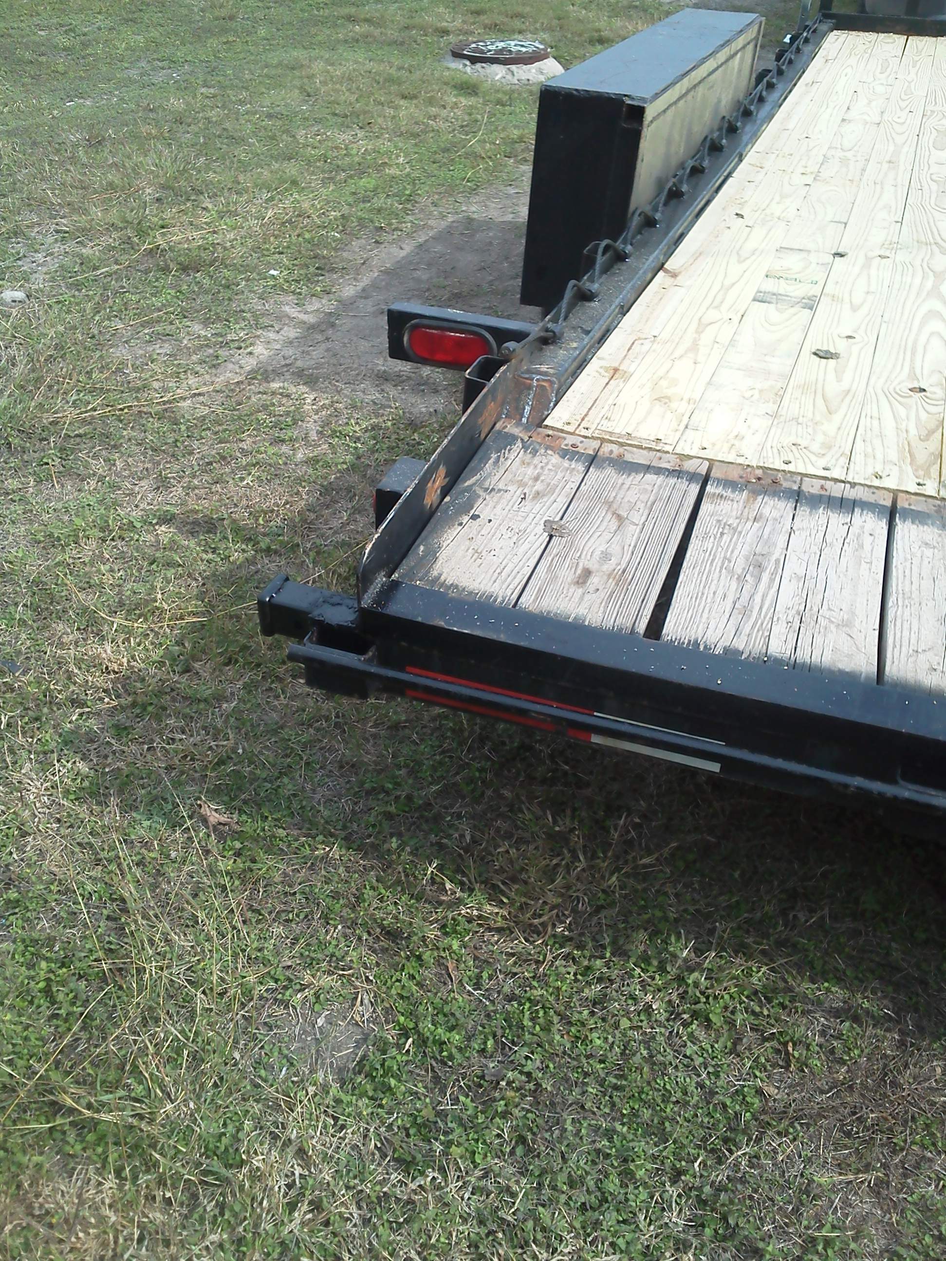

Fenders are welded, 1/4" plate. You are correct about Duke Boys on compact to midsize cars- to get load balanced correct, doors will not open. Full size Regular, ex-cab and crew cab trucks,Broncos, Blazer not a problem. On the flip side you can haul round bales 2 wide with bales sitting on the fenders and not have a problem. I have also hauled 8' wide frames sitting on the fenders with no issue. Not an option with standard trailer fenders. The jacks... I am not really wild about how I have them stored on the front. I could not really come up with a better place to store them other than my truck. I like them wide so when loading tractor with 8' wide disc, the jacks are for enough out they are not in the way when you lower disc and tie down tractor. I like them being moveable because when you have a flat on the road, stick one under frame at flat tire and jack it up, no crawling around under trailer placing a jack.
I too really did not like the bed not being flush, thats the way it was designed by the Mfg. Only time it really got to be a PITA for was hauling pallets and using a forklift to load/unload from side. But its better than having sides on a trailer, which is something I am going to have to get used to with my new trailer.
