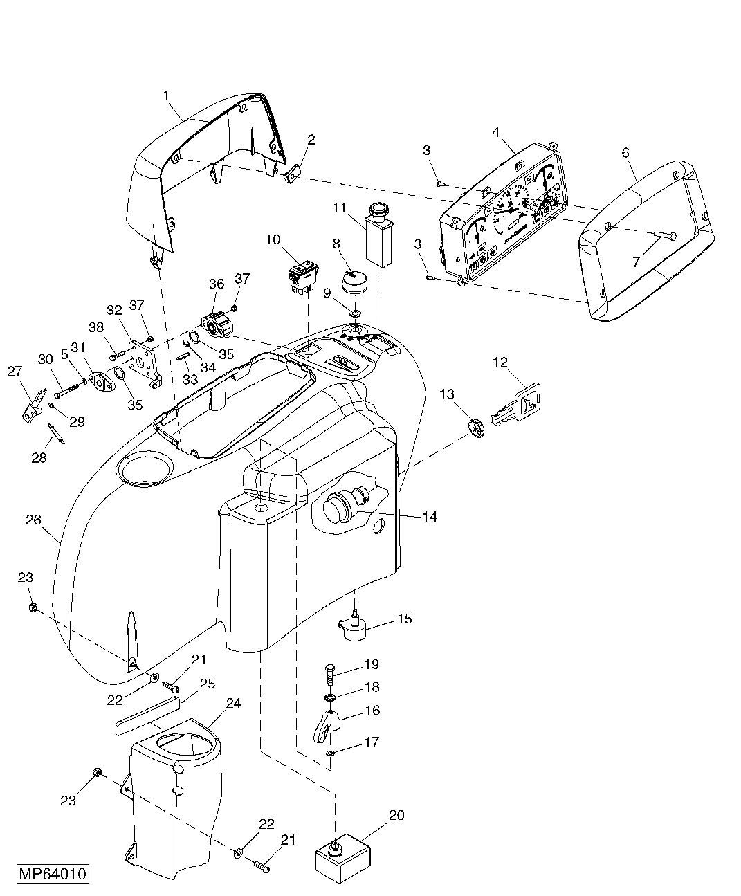

Does anyone have experience with changing the ignition switch on a Deere 110TLB? Our key is requiring giggling some time to start the machine. How hard is it to change this? Does anyone know the Deere part number?

Try part number RE61717. I suggest you talk to your dealer. They can guide you better.

From www.jdparts.com
Control Console And Switches
Cart key PART NO. PART NAME QTY SERIAL NO. REMARKS
1 LVU11990 Cover 1
2 M135748 Nut 4
3 37M7181 Screw 8
4 LVA14375 Instrument Cluster 1 (WITH LVA10960 HARNESS ALSO ORDER LVA12505) (WITH LVA12530OR LVA13010 DO NOT ORDER LVA1 2505)(SUB FOR LVA10945, LVA12576 OR LVA12811 )
LVA12505 Wiring Harness 1 (DIAGNOSTIC INDICATOR LIGHT) ( USE WITH LVA12576 AND LVA10960
5 24M7138 Washer 2 311000 - 5.300 X 15 X 1 mm
6 LVU11991 Bezel 1
7 21M7327 Screw 4 M6 X 35
8 R111632 Knob 1 HEADLIGHT SWITCH
9 R44165 Lock Nut 1 HEADLIGHT SWITCH
10 LVA12403 Toggle/Rocker Switch 1 CREEPER (INCHING DIRECTION SWITCH)
11 AM118802 Switch 1 PTO
12 RE183935 Key 1 IGNITION
13 R44342 Nut 1 IGNITION SWITCH
14 RE61717 Rotary Switch 1 IGNITION
15 AM124875 Switch 1 HEADLIGHT
16 M134145 Knob 1 TURN SIGNAL
17 R56410 Nut 1 19.050 mm TURN SIGNAL
18 12H233 Lock Washer 1 1/8"
19 21H1372 Screw 1 1/8" X 3/8"
20 AR64422 Turn Signal Controller 1
21 21M7310 Screw 8 M6 X 25
22 24M7054 Washer 2 6.400 X 12 X 1.600 mm
23 14M7397 Lock Nut 8 M6
24 LVU12811 Cover 1
25 LVU12861 Pad 1
26 LVU11119 Armrest Console 1
27 LVA11109 Lever 1 PIOTENTIOMETER
28 LVU12864 Extension Spring 1
29 A4365R O-Ring 1
30 19M8834 Cap Screw 2 M5 X 45
31 R86457 Support 1 PIOTENTIOMETER
32 LVU12003 Bracket 1 PIOTENTIOMETER
33 34M7031 Spring Pin 2 5 X 24 mm
34 R72653 Snap Ring 1
35 P48347 O-Ring 2
36 RE261355 Sensor 1 - 310999 PIOTENTIOMETER, (SUB FOR RE30295)
LVA13773 Sensor 1 311000 - POTENTIOMETER (85 DEGR EE), (SUB FOR LVA13514)
37 14M7265 Lock Nut 4 M5
38 19M7373 Cap Screw 2 M5 X 20

We are going to take a crack at this...has anyone removed the armrest console? The rear bolt is covered in the wheel well by some type of duct - so I'm not sure how to get to that...
You have to pull down the channel and sneak a 7/16" wrench up in there, lay it flat, it's not easy but doable, the bolt below the throttle lever is also difficult. You don't have to remove it completely to change the ignition switch, just get all the bolts out and it will lift up enough to work under it.
