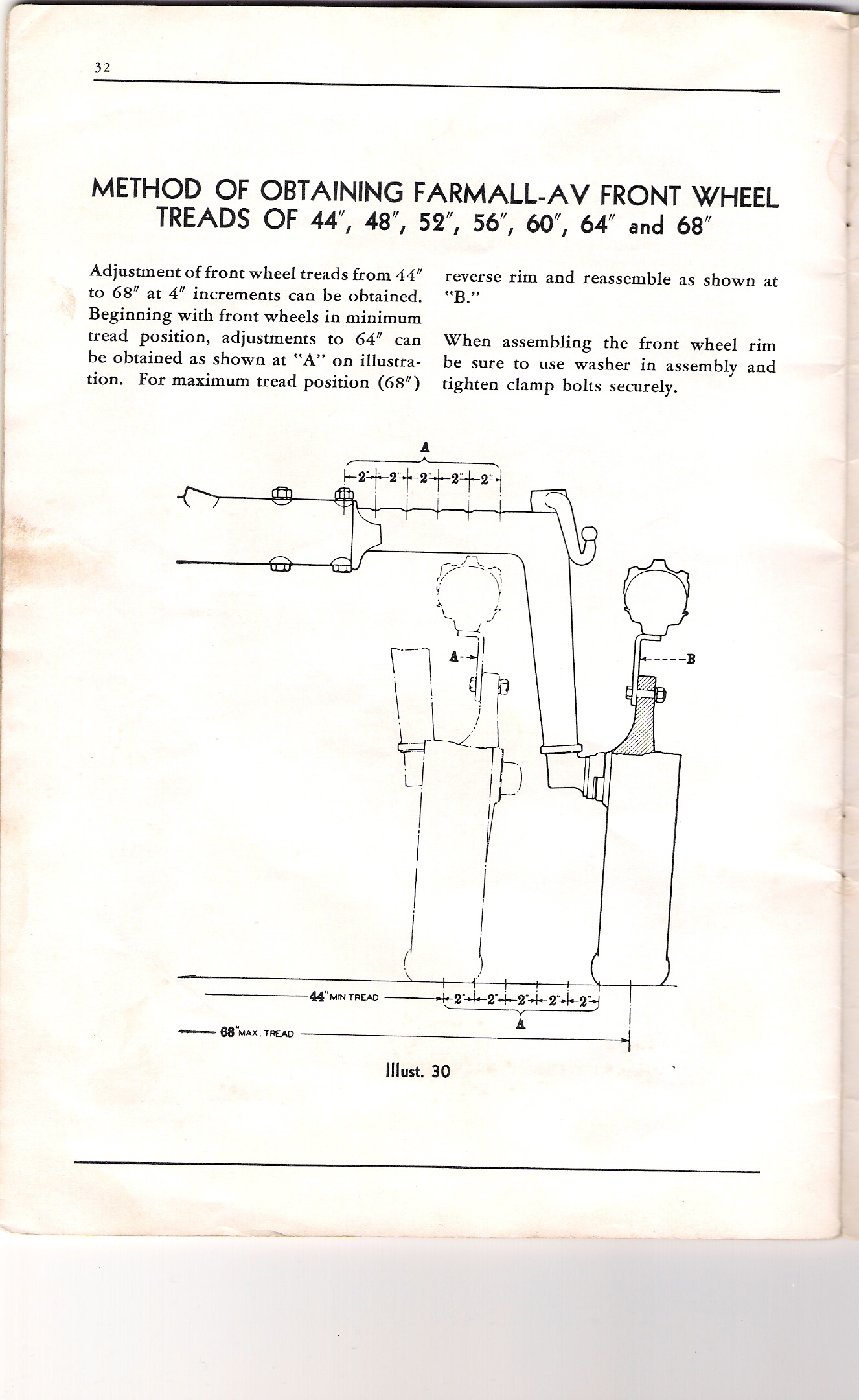

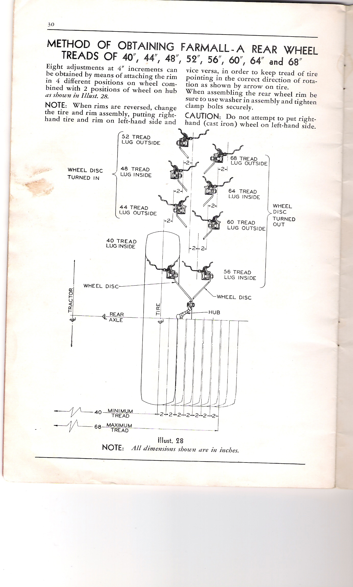

Hello, I just bought a IH 140 Operator's Manual. The pages that provide wheel info are missing
can anyone provide that info, thanks

Do you mean the wheel spacing info, as far as row width set-up..?? If that is the case, I do have one for the A, and it should be similar. But it is at the other farm, and may be a few days before I go back there. If that is what you are looking for, I'll try to remember to pick it up next trip.

Yes, that would be geat,

Finally picked up the manual for the A, and got the pictures I think you want scanned, and posted.
Hope this is what you were looking for.
