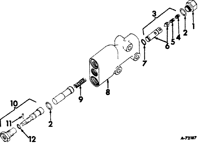

IH 2606 Industrial
I bought this tractor at an auction.It did not run,and the front tires were turned all the way to the left. I got it home got it running.The hyrdrualics would not work,it was low on fluid. the thing had been sitting for over 8 years. So I drained the fluid openned the right side filter housing and cleaned the mesh screen,and changed the canister type filter behind the loader valves. I filled it full of fluid,now everything works accept the power steering. but if I use the loader to get the wait off of the front wheels the steering works. Also when I do the loader creeps down. I've changed the hand pump with a used one the seemed to be in better shape. Any advise?

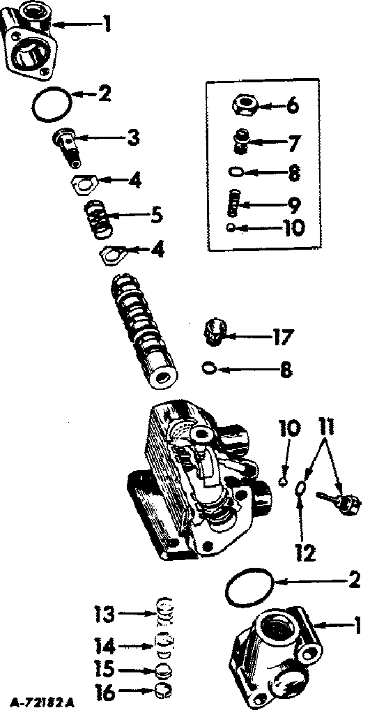

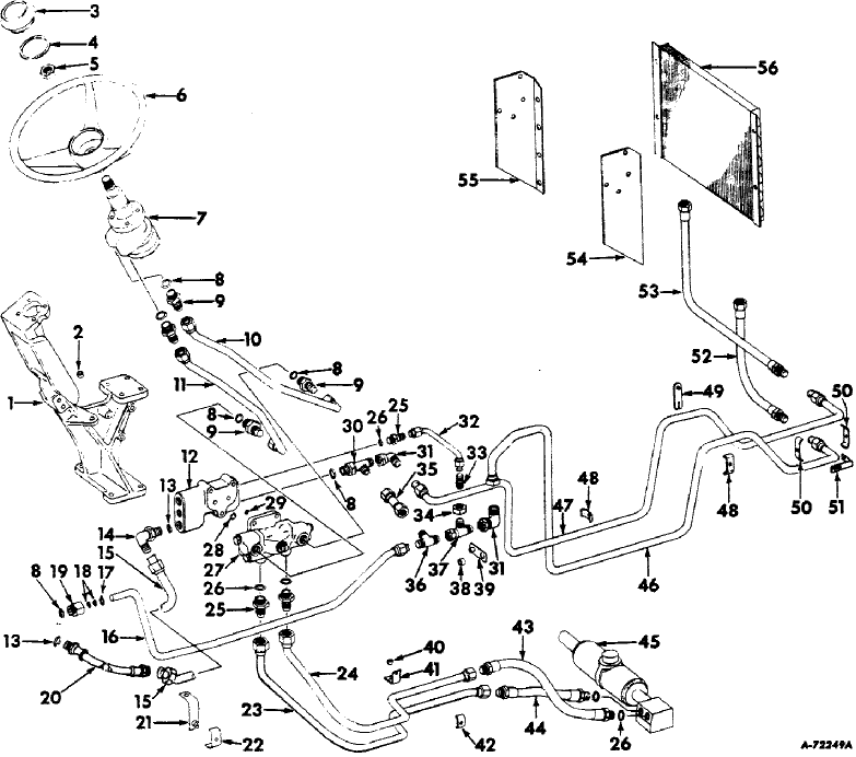

I copied some exploded views of the 2606 power steering mechanism from Case/IH. Almost sounds like the flow divider valve may possibly sticking. Also included an exploded view of the pilot valve. These pics will help you locate these valves, and if you decide to open them up to clean, you'll know what to expect if you tear them apart.
Hope this helps..!!

Oops, forgot the exploded view of the flow divider. In the system exploded view, #12 is the flow divider, and #27 is the pilot valve.

I took them both off and apart yesterday,but didn't find anything unusual.I'll get new orings today and put them back together. I suppose my next step will be the steering cylinder?
   / IH 2606 Industrial steering problem #5
Normally the hand pump goes, your case I'd say it's the steering cylinder.
