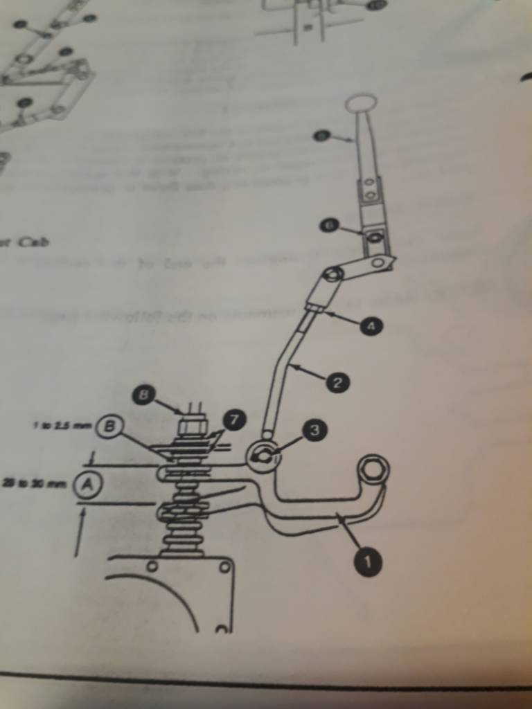

I just purchased a IH 574. Should the pto turn when my tractor is not running? It turns almost a complete turn. If it's engaged or not! When I start the tractor it will not turn. Even when the lever is engaged.

If you start the tractor and engage the PTO lever, the PTO shaft should turn. If it doesn't, something is wrong. With the engine off and the wheels blocked and the parking brake engaged, move the range selector around back and forth between L, N, and H ranges back and forth several times. Put it in N. Then move the PTO lever back and forth several times, then leave it in the disengaged or OFF position. Start up the machine. Move the PTO lever to the engaged or ON position and observe the PTO shaft. If it still isn't moving, I'd first turn everything off again and start looking at the linkage for that lever to make sure it hasn't become disconnected from anything. I'd have to look at my manuals to see how its connected.
