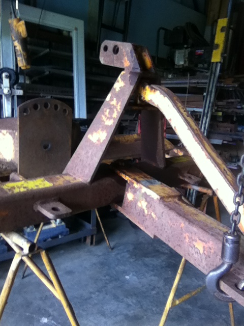

Some pics:
It looks like it maybe angles.....but that cylinder that is attached is for offset. Was really hoping someone knows what it weighs.

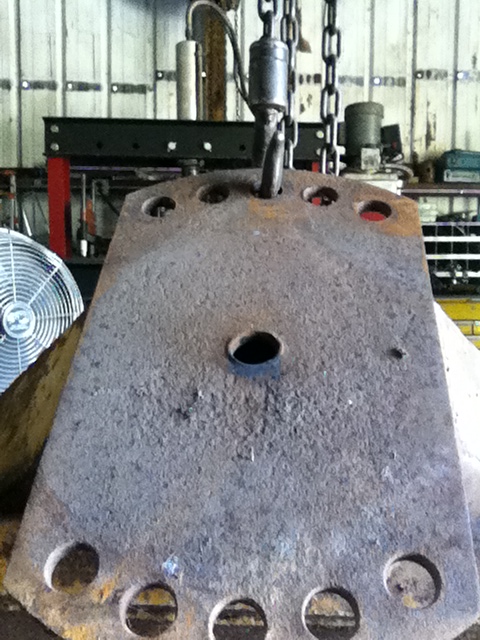

That back blade appears to be a Gill/Woods HBL-96 or at least its built the same. The blade looks and is shaped different than the Gill but it may have been replaced. Anyway I have a HBL-84 7 footer and it weights 560 lbs without any hydraulics. It is capable of 3 way adjustments but only the offset has the ears for a cylinder. I've seen pictures of modifications for all hydraulic adjustments.
When I bought mine used I thought about installing all the cylinders but don't have the setup on the tractor for it and after using it I don't think I would ever need the hydraulics. If you were using it at different locations and a lot of different jobs it would be necessary. I'm just using a turnbuckle for the offset and the tilt and angle have pins which are standard.
It's a well built blade and suits my needs and the replaceable cutting edge has two edges with holes in the center.
The weak point of these types blades is the pin that holds the blade onto the angling box. It's a 1" bolt and nut through the plate and into the blade holder. It gets wore out over the years and I installed a bushing in the plate and reinstalled the bolt to tighten up the slope. Here's the plate after removal:
