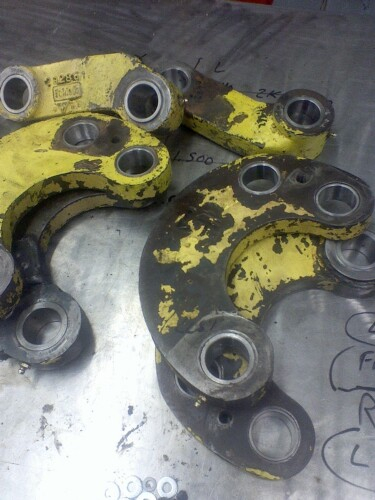

Hello, I am looking for an opportunity to buy rear bushings (or one bushing) for an IHC 3500A backhoe loader. Rear boom swing actuator. If anyone has an idea where I can find it, please let me know....Best Regards

Is there something special about this bushing? OR is it just a typical pin bushing thats wore out?
With decades old backhoe's, most parts are obsolete, and even if they werent, You'd probably be shocked at what a dealer would gouge you for on prices.
I had a ford 5500 TLB. And the swing on it was rather complex with lots of pivots. It had a total of 12 bushings on the swing arms that were all nominal sizes. 1.5" ID x 1.75" OD x 1" long.
Surprisingly I could still get them from ford, but $104/bushing. I wasnt about to spend $1200 so I made my own
You may need to visit a local machine shop.

What is special in that cans? The bore in that cans are not centered ,the hole is eccentric the offset of the hole is a few millimeters from the center. (Someone from Poland promised me to measure but since we have winter, he doesn't want to dismasch backhoe) Such a measurement would solve the problem

Any pictures? I cant picuture the purpose of an offset/eccentric bushing on a swing mechanism of a backhoe....especially such a small (few millimeter) offset

Eccentricity makes it possible to move the comb with teeth away from the rack of rotation. If you make centric friction on the cylinder on the opposite side of the rack will be so great that it tears the inserted sleeve ... That's why they recommended me to buy the original sleeve (even just to measure)
