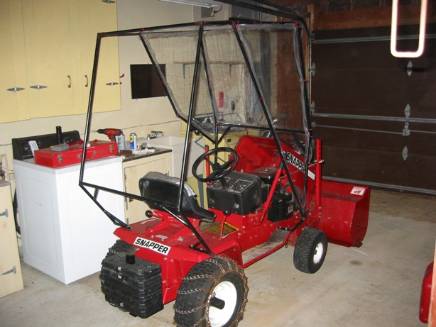

I did something similar on my '87 Snapper LT16 - I welded up a rear-mount square post and stack plates from an old universal gym.
