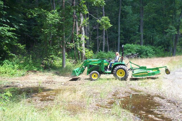

My tractor was delivered yesterday at around 10am. After climbing on and getting aquainted, it was time for some serious brush hogging.. Our property is horribly overgrown with 10 foot tall pricker bushes, saplings everywhere....Its just a mess. I worked slow, but made some good progress in the 6 hours I was on. A tiltmeter is the next purchase, for sure. I had a few scary moments as the back tire sunk down in some soft rotting earth (maybe an old rotting stump). Since this is my first exposure to using a loader, it will take some time getting used to, but I was happy with how I picked it up. Some more seat time will hopefully make using the loader second nature. Hopefully by then the 4 in 1 bucket will be delivered (they say it should be in by next week). More controls to get used too!!
Now, for just a couple of questions....
1) Is there any harm in engaging and disengaging the PTO many times in the course of work? A lot of times I was concerned that a sapling I just ran over was too big, or I was driving in an area that didn't need cutting and didnt want the risk of blades hitting something, so I disengaged the PTO. Is this a problem, or should I be planning better where I am going??
2) Is there a problem with backing up with the PTO engaged (with a rotary cutter)? Some areas were just easier to cut by backing into them and lowering the cutter.
3) Is it a big problem if I do knock down a big sapling (say 3-4 inches) then run it over with the cutter raised a bit, just to give the sapling a haircut? I did this a few times and it seemed to work quite well, though i was concerned about wear and tear.
4) Is it normal for a 31 year old to smile for seven hours straight?
Here's a pic too...

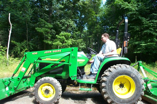

Here's another pic...
Amy swiped some seat time...

ADEGIULIO , I hope to have my new 4310 ,loader and 72" mmm by the end of next week along with the big smile that goes along with it. I am waiting for the 430 loader with hd bucket to come in .I currently have a 755 4x4 with a 60" mmm and a 4' jd brush hog. I mow my fence and property lines with it backing up into it. I go in raised and come out with the mower lowered. I have cut some very large stuff with it over the years without problems. the hydro is great for doing this.
Its not a problem if you turn off the pto if you don`t want to cut a spot. All of the newer tractors shut the pto off if you back up or raise your but off the seat anyway. /forums/images/graemlins/cool.gif

I back into a lot of stuff when I am brush hogging. We have lots of blackberry vines that I go in and cut. Raising up the cutter and backing into and plopping it down. Works great, I can see places that haven't been visable for 20 years or more!
