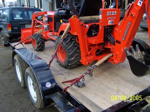

Although you folks have been dieing for me to test my chipper,i have been spending my time, gathering up materials ,and doing research on how to anchor down my bx-23.If you recall i posted a thread on how i hauled BOTA with heavy duty ratchet straps,and would have probably have lost her,if i had many more miles,the threads were ripping right off the hooks.then and there i decided to use chain binders.
First stop MAINE STATE POLICE BARRACKS in AUGUSTA.The officer that helped me,explained my BOTA had to be hooked down on all four corners,the bucket had to be hooked down,and ANY attachment ,in this case my hoe.IF i were to have my chipper on or any other attachment it also had to be hooked down. He said it would be ok for me to ,run the chains over like i did,because it was anchoring the four corners down.
I have been also nervous about,being stopped,because i have heard DOT is really clamping down lately,and the fines are stiff.
tell me what you think,am i doing it safe?

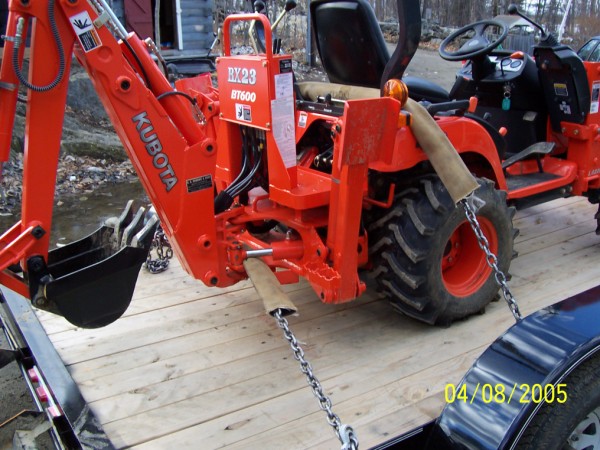

ANOTHER

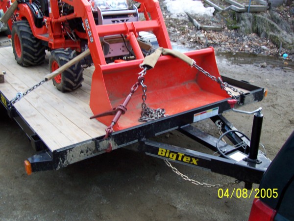

LAST ONE

I'm no expert here - but it looks like you have some nice beefy chains there for the FEL & tractor.
On the second picture - any chance the strap behind the seat could "slip" forward or backward & damage something?
Does it make sense to drop the BH & throw a chain across the bucket too? Any room to drop the stabilizers once she's on the trailer?
Only other thing: is it possible to run the chains at the CUTs "corners" - to the corners of the trailer? Even though the chains are "tight" to the sides - I could imagine that there *might* be some forward movement if you were under hard braking. I think going to the corners would prevent any front / back as well as left / right motion.

Alan,
Looks like you got it! The only thing I might add is one more chain from the draw bar to the back of the trailer to stop any forward momentum in the event of a head on collision. I admit it is over kill, but nice to know it won't be be hitting you in the back of the head if you have to stop quick!

Love that trailer... is it just an individual preference the way you hook to the chain... I've been dropping the chain through the pocket and hooking it to the top part...
Pete.

DAN THERES THICK FRAME WORK BEHIND THE SEAT,I CHOSE THIS SO NOT TO BEND THE FENDERS,ITS NICE AND SECURE CANT REALLY SEE ANOTHER GOOD SPOT TO HOOK HER,CHAINS WONT GO AROUND THE TIRES..MY HOE HAS TRANSPORT PINS I PUT IN SO IT CANT SWING AROUND,OR DROP WHEN MOVING.GREAT THOUGHTS,THANKS

DAN i forgot to reply to your last comment. i originally had the back chains hooked to the back stake pockets,but it put alot of stress on my blinker lights on bota,thought i was going to break them.i see what you guys mean about in a head on,bota could go forward.have to give this some more thought.aint this firehose great stuff..cuts hard as heck cause,its so thick.

I didn't know about the locking BH - makes sense they designed it in! /forums/images/graemlins/crazy.gif
I looked at your pics again - I was worried that the one behind the seat could cause a problem if it slipped FORWARD - but that would mean the BX slipping BACKWARDS off the trailer. So I retract my concern! /forums/images/graemlins/grin.gif
Another way to think of my comments about the "corners" - imagine - looking at the straps from the side of the trailer...
currently your straps look like this: | | (connected vertically)
but if you could "kick the bottoms out a little" - so they look more like this: / \ ("angled away")
then I think you'll get more of the forward / backward security I was thinking of.
All that being said - I think you should be fine - looks like you have plenty 'o chain on that BX!
Cheers,
Dan
