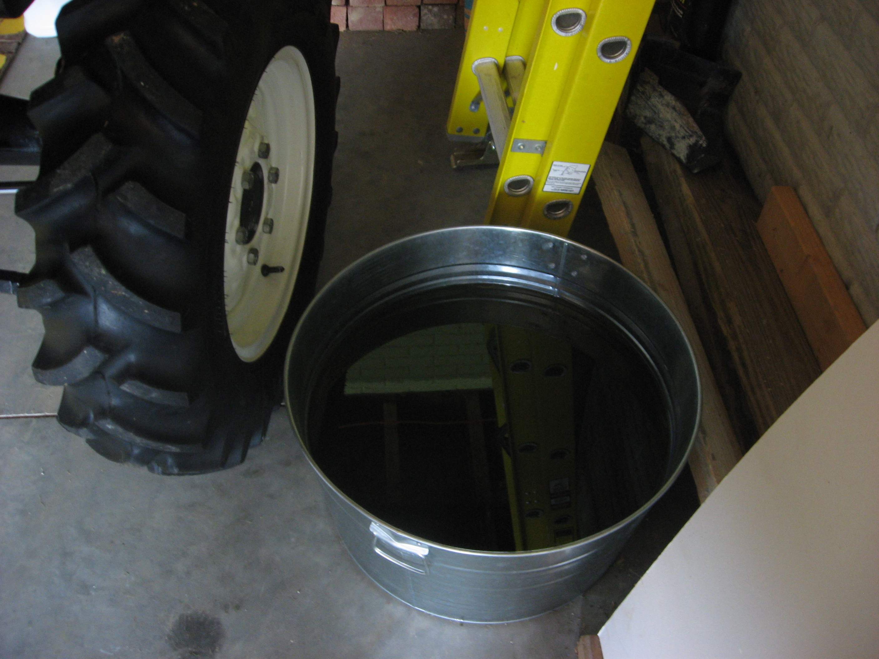

But the vent-plug/dipstick showed beautiful, honey-colored oil right up to the higher end of the "full" range. It looks like it just came from the factory, two and a half years after I bought it, and who knows how long the previous owner used it for. Things like this make me nervous.
The hydraulic oil on my tractors dipstick looked crystal clear also at 185 hours but came out looking like this.... it was filthy.
I really doubt if 99 of people ever change the gear oil in the gear box of their brushhogs though but I will probably change mine. I do not think mine has a drain plug but I will end up buying one of those reverse suction type grease guns.
If your BH sits outside all the time or operates in very dusty environments you might want to change it.
