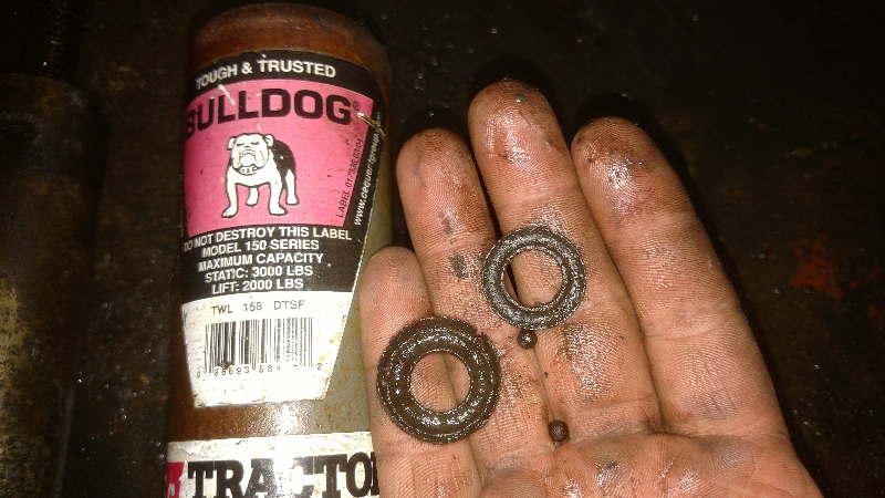

Oil? Never heard of it. Tell me more. Does it float on water? Because without a cover my jacks fill with water. They don't come with a drain hole and when I have added one ants and other things find a happy home even when it sinks into the soil and no longer drains. The thrust bearing on the top tends to fail even when the screw is free. I have rebuilt many by machining the screw to take a tapered roller bearing to replace the failed thrust bearing with bb sized balls that fall to the bottom of the jack as soon as there is no pressure to hold them in.

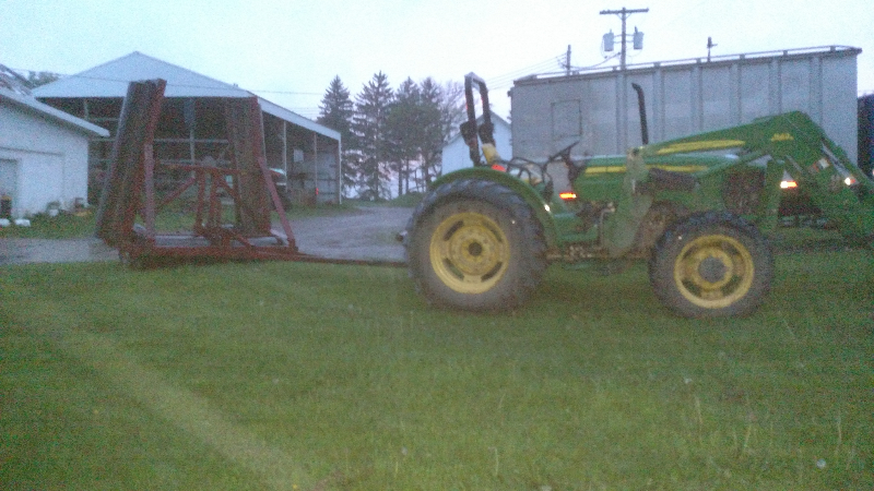

My equipment is a bit heavier than the average. The jack that inspired this post was for my roller. A 30 foot roller. What do you roll with in Texas? I heard it is bigger there. Would you like pictures of said roller and water/rust filled jack? I'll trade if you show me this magical"Oil".

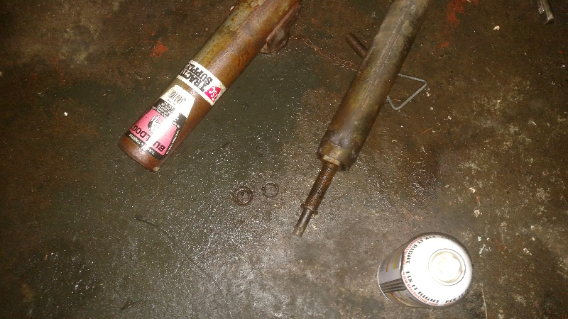

The puddle of water has dried up a bit.
Back to my original request. Does anyone make a jack with better material? Because this one is three years old and was submerged in used hydraulic fluid (hy-tran) and covered with a spray jug for a year. It sat for two more and this is the result. I got my butt chewed for putting a new jack into a trash bag and drowning it in used oil..er..hytran (again not this Texas oil you speak of) until I got the last air out of it.
I've used never seize on new bulldogs but I can't say I got any better results. They are disposable.

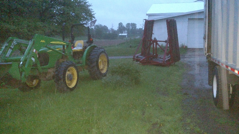

Yes I have buildings. Not enough buildings of sufficient size. I had finished using the roller and it is parked to be washed with the hot water washer behind the door in the background. The rollers will get paint. Everything greased after it dries.
