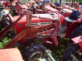

   / Implement to ground
Hi Mark,
As matter of fact it’s a valve (looks like a gear). The same type (with small difference), use to control the FEL (plse see photos in attach). This valve blocks the hydraulics from the pump which comes from the motor side. So it must be open if you want to work with the 3 point arms.
