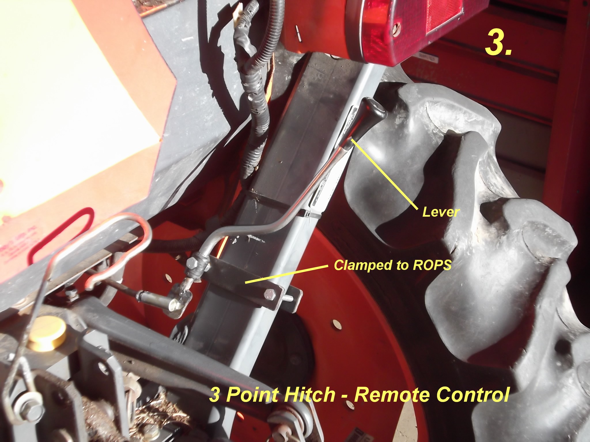

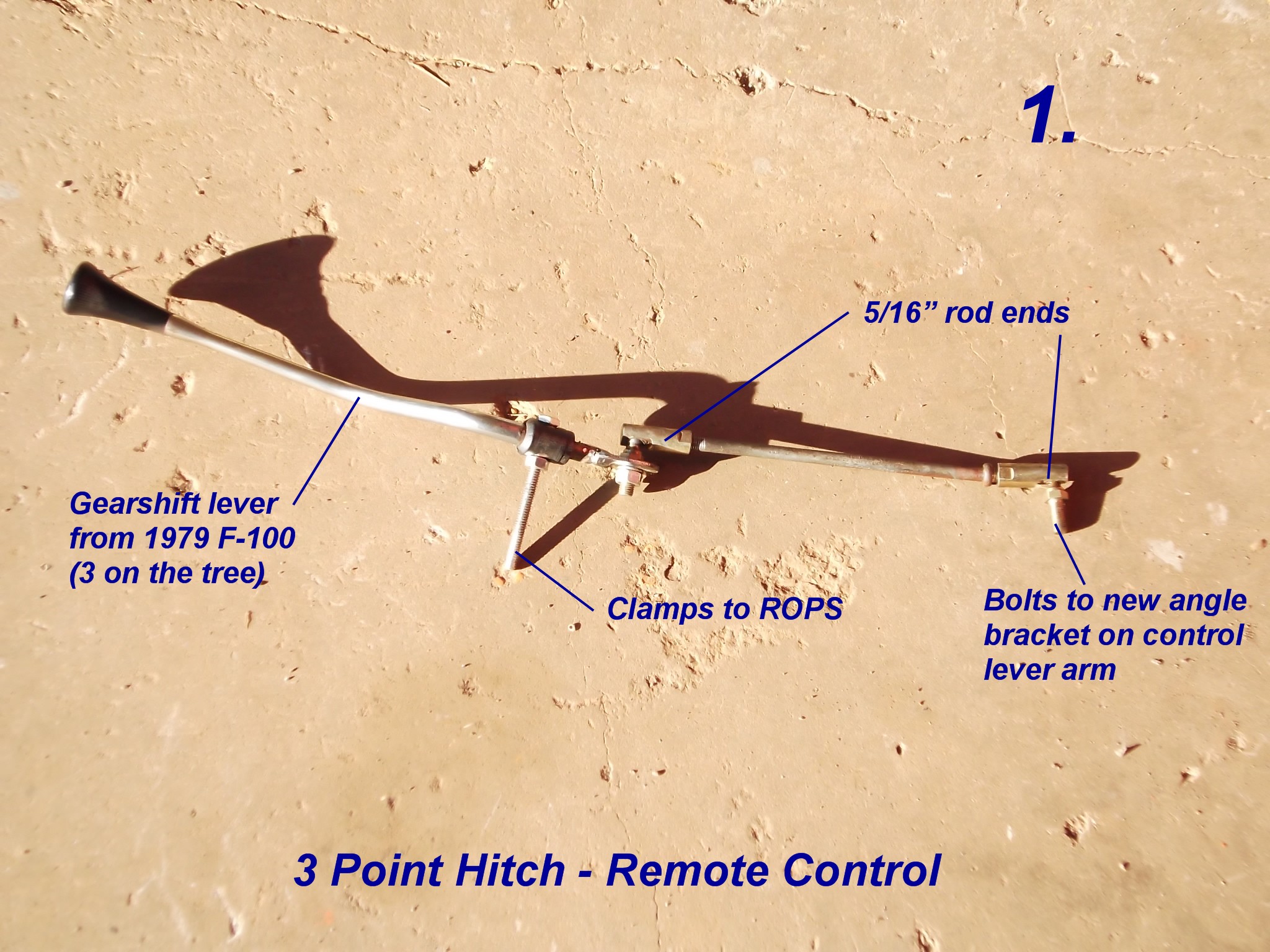

Here are three simple (and cheap) improvements I have made to the 3 point hitch on my Kubota B7800. I built all of these from material I had laying around. (Never throw anything out!) I got all of the ideas from fellow TBN'ers.

3. TPH Remote Control
With the cab I built on the tractor, while changing implements it was impossible to raise and lower the TPH and watch the hitch position without climbing in and out of the cab. I'm getting way too old to be doing that, so I just installed a TPH control lever that I can operate while standing on the ground beside the tractor where I can see what is going on. Since the lever is connected to the existing linkage right at the transmission case, it can only activate the famous 1/4 inching function - no high speed movements (since they require moving the lever in the cab to bypass the 1/4" detents).
My thanks to TBN members who posted these ideas over the years.

That remote TPH comntrol is a great idea - I need to copy that one.

I like the turnbuckles mod! that looks like exactly what I want to do to my kubota! The 3pt remote control is a good idea for a larger tractor - but would scare me on a smaller one like mine. thanks for posting.

Wow, fantastic ideas. Thanks for posting. Come spring I will try & set up a remote 3 pt hitch remote like yours.

Thanks for posting the detailed pictures of your remote 3PH lever.
I recently traded-in and got a L3540 which is a bit taller and the main 3PH lever is located more forward than my old tractor - I didn't realize until now how much I relied upon being able to reach up and work the 3PH when hooking and unhooking attachments.
It's great to see that a solution can be made. Whether I'm skilled enough to make it will be the next quandary to solve.
   / Improvements to 3 Point Hitch #7
Be careful when moving the lift arms remotely while standing between the tractor and implement. I have almost got caught in that area several time over the years. Ken Sweet
Yes, be very careful if you do this. I set this up so that I can operate it while standing off to the side. In my case, with the way it is connected to the TPH control linkage, it can only activate the 1/4 inching function, which is very slow. Ken, I'm glad you brought this up. Thanks!
