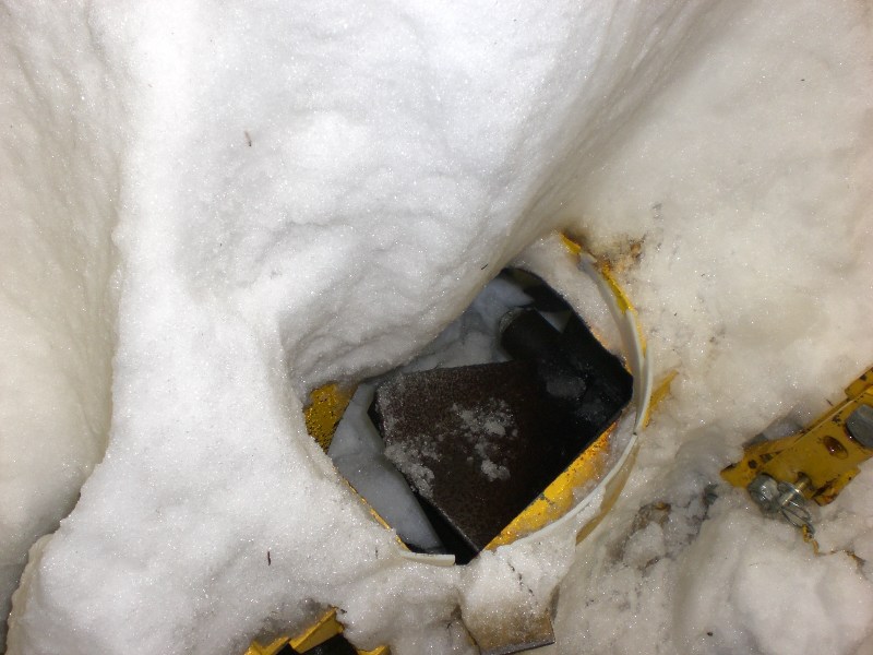

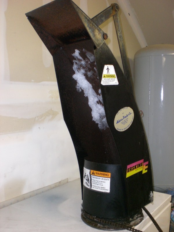

I tested in 2ft of slush and found that I could only throw about 4' and the chute cylinder would clog within about 10ft. I did this 4 times, then tried the same with 12 inches of slush. I made it 15ft.
Since the hangup appears to be in the impeller/chute tansition...let pull the chute and take a look...pics.

What do you think would be the best tolerance between the impeller blades and the drum? Mine currently appear to be 1/2-3/4in.
In the picture above the cylinder portion seem very tall compared to some pictures I have seen on other blowers. There is also surface rust that is catching and holding some snow.
Next test...run the blower in 24in of snow without the chute attached.

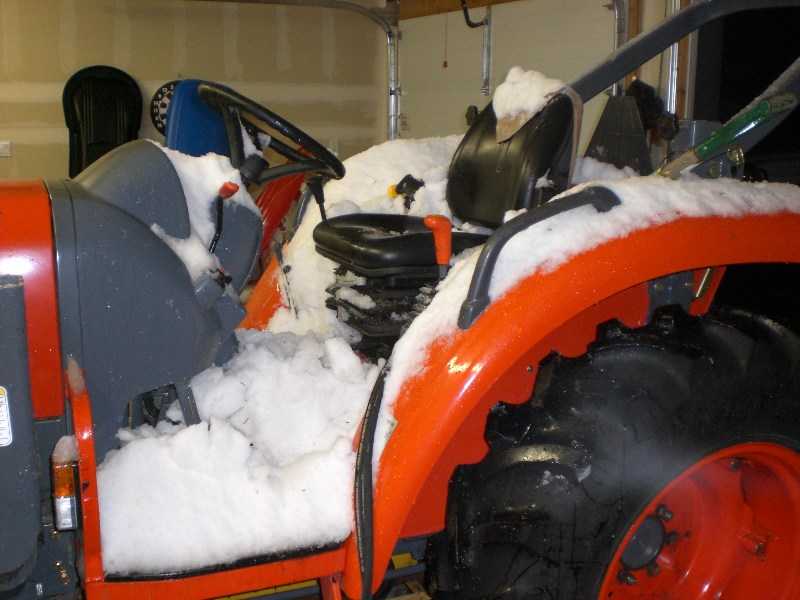

4. A mortar shooting snow which accumulates at a rate of 12 cubic feet per linear foot travelled is a heck of a lot of snow. See pictures.
5. Snow coming from a blower packs down like ice, when you raise you legs to hit the clutch and brake you will find your boots pinned to the floorboard.
6. Snow and ice thrown from a blower without a chute will find it's way into your underwear even though you are wearing a Carhart suit...mysterious.

   / Improving Snowblower performance
Another key point shown in the snowblower opening above is that the plastic sleeve is mostly missing. I may replace this with a section of 5 gallon bucket to get the slick surface area back.
So, do I try to sand, paint and lube the original chute or fabricate a better design.
It seems to me that cutting a trailer fender in half and mounting the cut half down on the chute would make a short and extremely smooth path to redirect the snow. Wonder if it would work.

   / Improving Snowblower performance #8
I had some commercial plastic (PVC) sheets that I cut and trimmed to make a liner for a shute once. Worked very well.
PVC is easy to fold and with heat of a plumber's torch can be moulded to fit inside the shute. Attachement need only be at the bottom of the shute as the blown snow will keep it erect.
One observation I made is that while considered cheap, the walk behind blowers with plastic shutes clog much less in wet snow than metal ones thus confirming the theory.
Another observation is the transition point from where the shute starts as round base (needed for rotation) and becomes a 'squarish' shute deflector is where the voids start the accumulation of wet sticky stuff thet simply builds up and clogs.
Like carb iceing!
What the PTO blower indusrty needs to do is mould a nice smoothe HD plastic shute to best handle the wet stuff. Probably won't happen.
Wonder if pickup truck liquid 'bedliner' might do the trick? Wish it was available in quart size as I'd be tempted to try that.
A freshly painted shute stick much less than worn 'sand blasted rusty' one, however a painted shute only lasts all of about 1/2 of the first snow event.
In northern Canada aircraft that operate on skiis always have a PVC liner rivitted to the ski bottoms to prevent sticking. Known as LDR bottoms. (low drag resisitance)
A later inovation was paint on or bond a urathane coating and oddly they discovered that rough brushed on was better than spray coated. (ever look at the bottoms of cross countyr skiis?)
