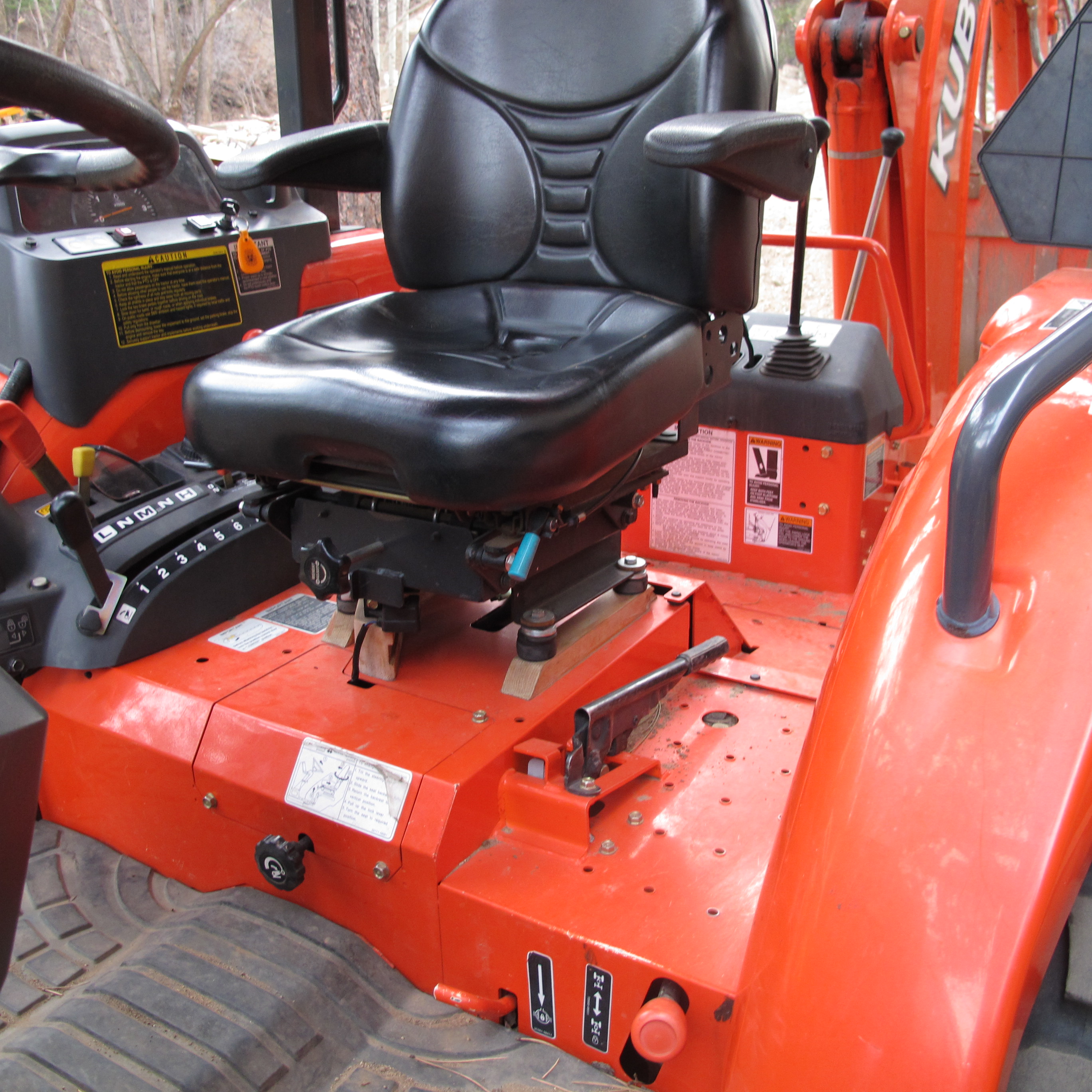

It's was easy to make simple improvements to the Kubota seat.
The original seat was low, tilted too far forward, and rode too stiff. It made for a jolting ride over small bumps, and bottomed out over large ones.
The nice thing about the original seat is that being so simple makes it easy to improve.
The cost in time & money to improve the seat was near nothing, and the improvement was dramatic.
The downside is that it's now enough better that I haven't spent that $1K to buy the air ride seat I originally promised myself.....

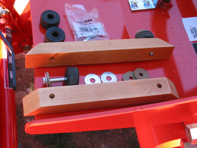

The bolts are from Home Depot's metric assortment, and the rubber spacers from the junk box. HD or the local hardware store probably has something similar.
If not, Mcmaster.com has a huge assortment of rubber spacers & bumpers. Search under their "rubber bumpers" for the perfect part, but almost anything works.
Oh... also.....In the center of the front of the seat you can see a wood block I added to raise the seat safety switch to the new level.
Knowing what I do now about the M59 and it's peculiar pedal layout, I should have simply defeated the switch by plugging the wires togther.

Same issues with the M59 seat. I need to do something like that. The wood strips tapered to level the seat?
   / Improving the Seat & Ride
I beveled the all the ends of the wood strips at 45 degrees just to make them look better. And varnished for the same reason. Isn't that new shiny tractor beautiful! It sure doesn't look like that now....
I guess I could have also tapered the wood strips to level the seat, but I didn't think of doing that. And also I wanted to be able to easily make some small adjustments because I didn't now how much adjustment it would take.
Leveling the seat front to back was done over a period of a couple of days by unscrewing those front mounting bolts so I could slide in some more of those big diameter galvanized washers that end up as my leveling spacers on top of the two thick rubber spacers at the front of the seat.
So that photo is probably day 1, but I think I ended up with a total of 3 more steel washers on top of both the front rubber spacers. I remember that I would have added one more, but that would have meant another trip to Home Depot for bolts a little longer, so I quit there. The rear spacers I just left with one washer apiece because it needs one washer to protect the top of the thick rubber spacer from the slightly smaller seat frame.
Mounting that way means the stress on the four rubber spacers is ever so slightly uneven front to back. But there is enough elasticity in the rubber spacers so that that heavy seat frame isn't under any stress from that. The thick rubber spacers soaks up the uneven loading and the seat frame sits nice and flat on those steel spacer washers.
How hard you tighten down those 4 long bolts is a sort of crude preload adjustment. After I was satisfied with the front to back leveling I took out those 4 bolts one at a time, put loctite on the threads, and tightened them down about one turn past finger tight. That was done not just to preload the thick rubber spacers but also to put enough tension so that the seat mounting would stay firmly in place and the bolts not back out. It's been 12 years now, without a change.

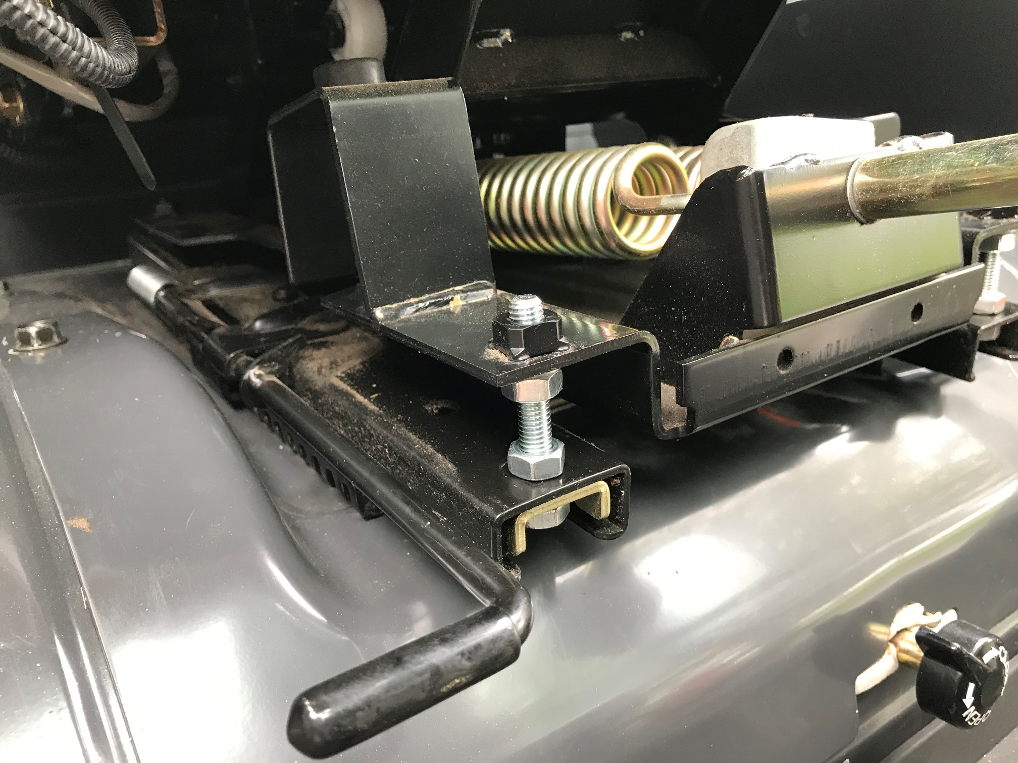

All three Kubtoas I've owned felt like they wanted to dump you forward and out of the seat. Used longer bolts and double nuts and dialed it to where I wanted it. Seat was OK for comfort with the factory suspension.
