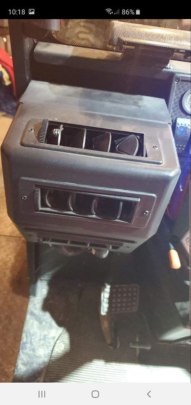

In today's episode of 'what did you fix on your Massey GC2400 today'......
The rear facing heater vent always falls in. I even switched it with another location, same problem.
Today I beat it into submission.
2 tiny holes drilled and 2 tiny screw/washers installed, all you have to do is dremel a little where the screw holes are in the heater body.
I win.
That and 2 more shearbolts, stupid unpaved parking lot has more rocks than snow.

I have a GC2410 and I'm trying to figure out where a heater vent would be on this series...

just above the brake pedal

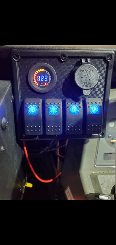

also a good spot right beside the heater for front light switch, rear lights, interior light and acc with a volt guage
