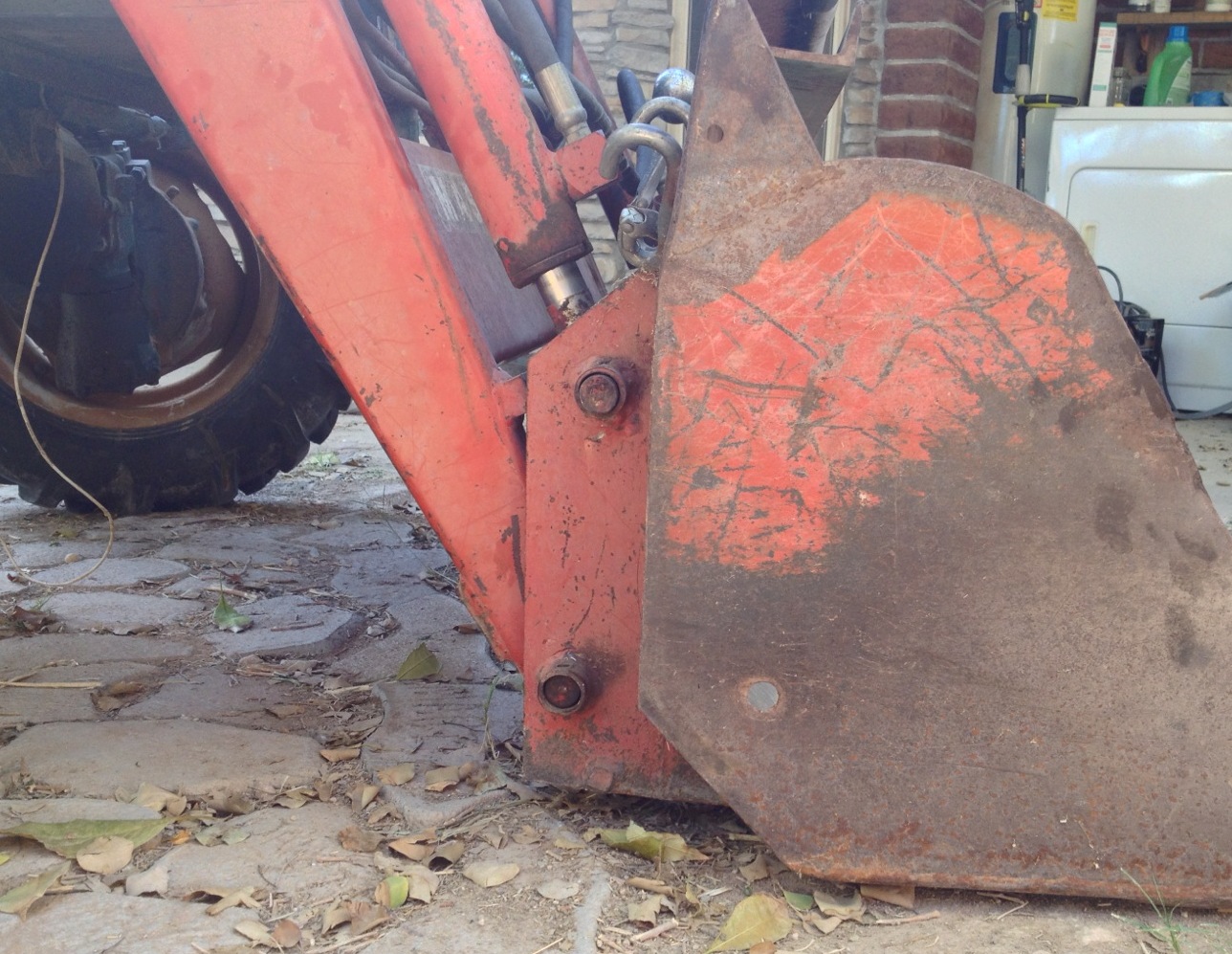

How could i increase the curl by changing the pin holes here? anyone done this?
Also.. any danger in welding on the underside of the tractor (back axle)?

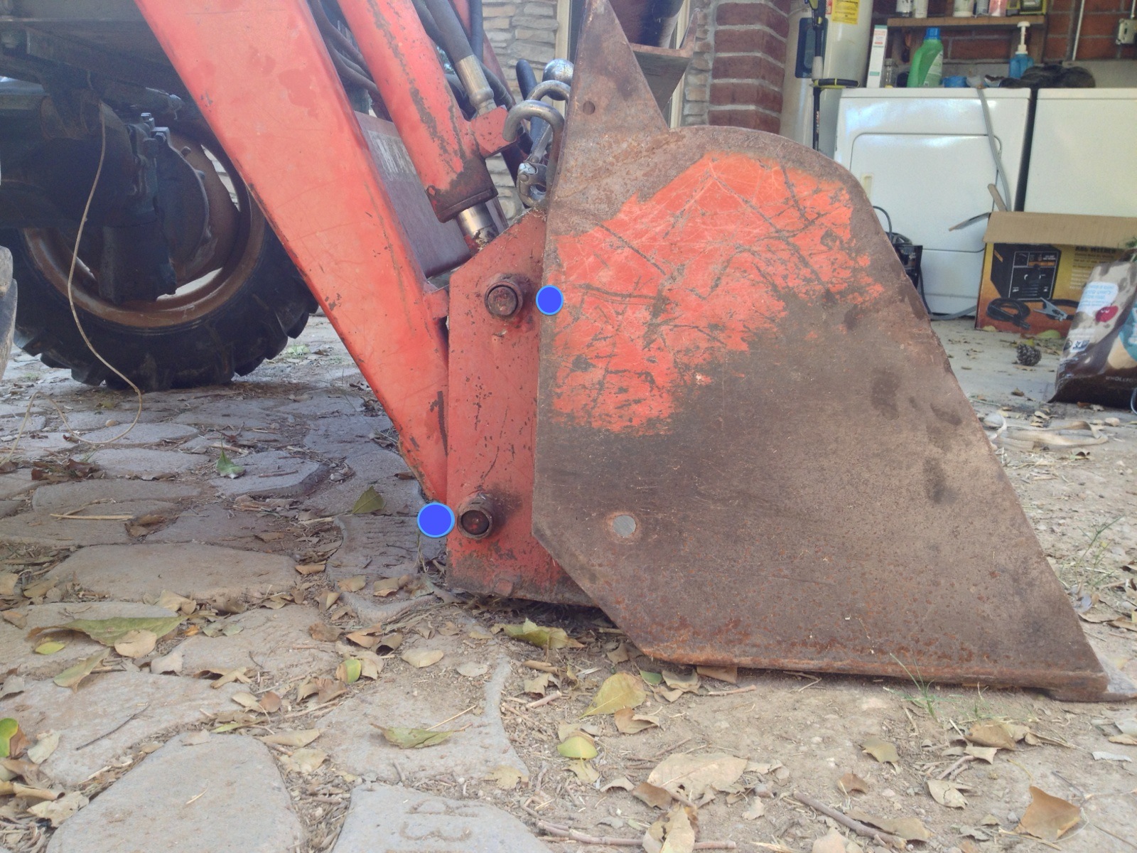

   / Increasing bucket curl (rollback angle)
LOL

Update: That didn't work. Looks like the cylinder hole needs repositioning too. Will try this setup.
   / Increasing bucket curl (rollback angle) #6
If you want more rollback the lower pin needs to go forward but if you change it to much it may not go to vertical in the dump position.
   / Increasing bucket curl (rollback angle) #7
It looks like the bucket doesn't extend very far up/forward. If you increase the rollback, it may take a little more attention to the bucket position when lifting a load high to prevent dumping material off the back and onto your hood.
   / Increasing bucket curl (rollback angle) #8
Have you thought about converting to a 4 link at the bucket? They give more roll back AND more dump angle too.

Hey JB- thanks for that i never even heard of it. i'l check it out.
I did try the repositioning of the holes like the first pick and it works much better about 5 inches back from the original.
