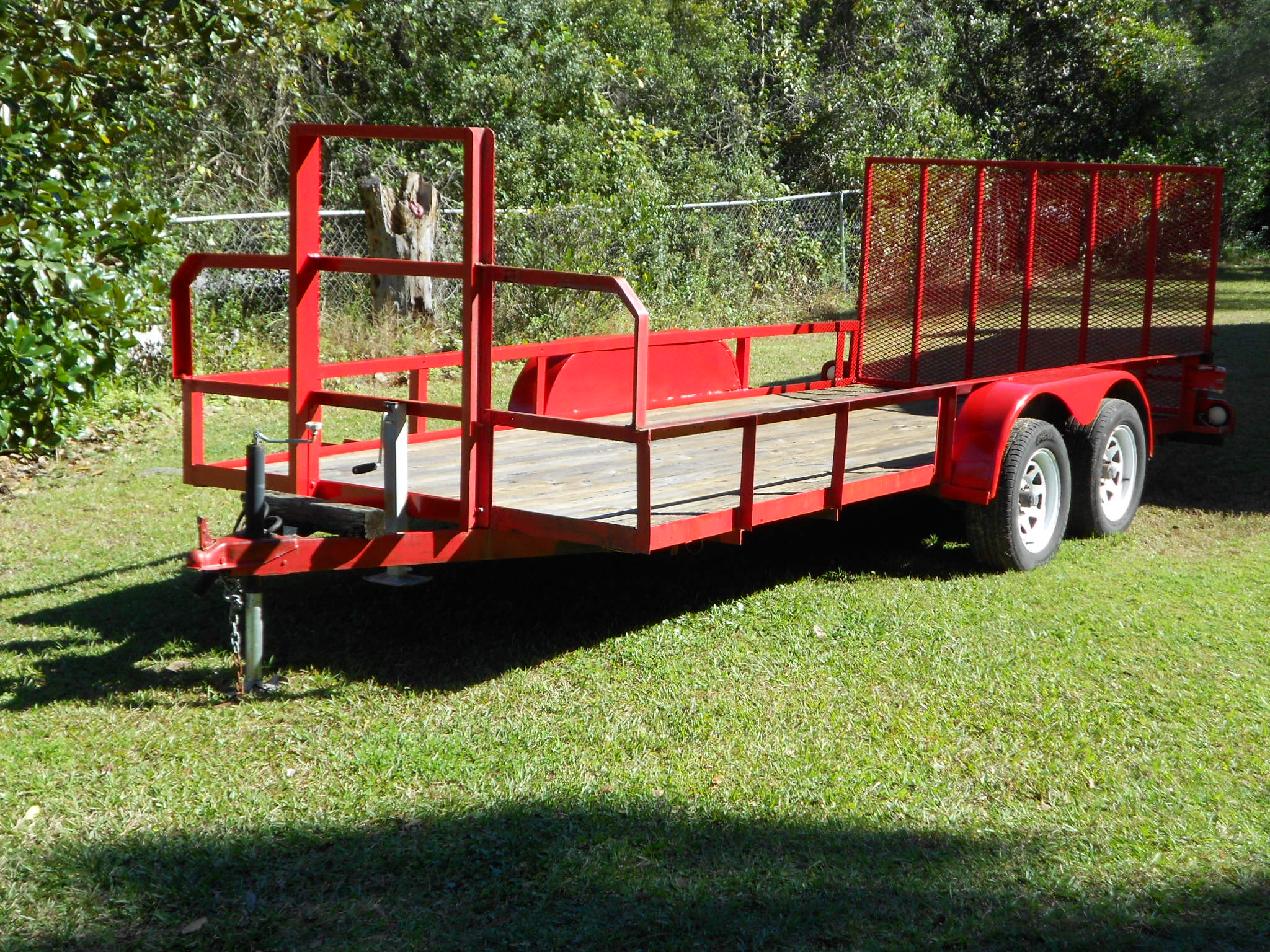

I bought this trailer off of CL a few years ago for $700.
I DID do a lot of work to it and kept the tailgate from my old trailer before I sold it.
Last week I pressure washed it, coated the floor with a mixture of used mineral spirits and used motor oil and repainted it.
If I want to move my 3510 Branson I can put two 2 X 10's on the gate.
I built the Bulkhead on the front for hauling appliances when needed.
I also haul steel up to 24' (square tubing comes in 24' lengths) across the bulkhead and tailgate. When strapped properly it becomes part of the trailer. I have had over 1000lbs up there!
Tailgate also removes for other uses.
I don't see ramps as versatile.

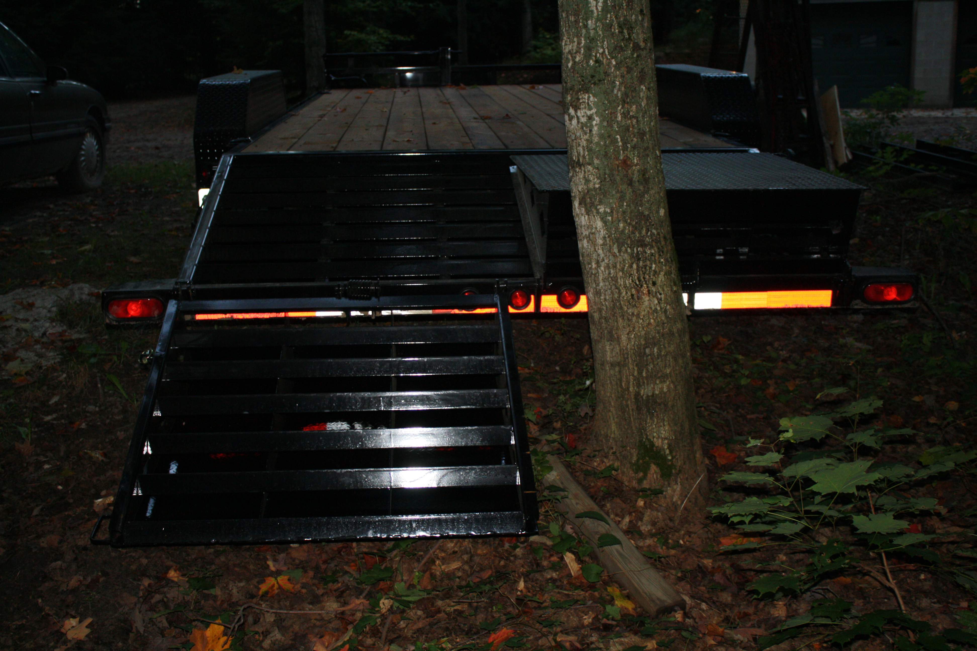

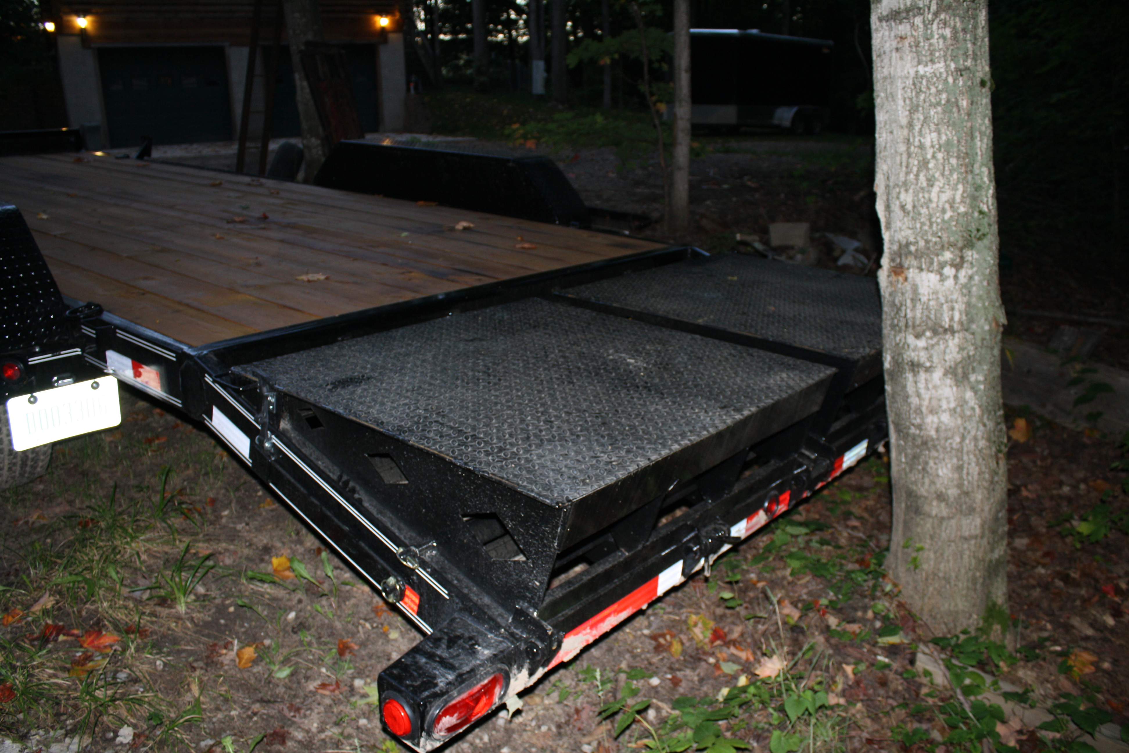

The last 4 flatbeds I have owned had slide in ramps and I either destroy them or have to build a set that will handle the weight. My gooseneck had slideins and the MFG said no problem with 15000lbs, HE he, ya right. Nothing left after loading the dozer. Built a set of flip ups and never looked back. Go to Load trails web site and look at the Equipment Dove. I love mine.pc rocks  trl 012.jpgpc rocks  trl 011.jpg CJ
Oh and listen to Diamond, find a good deal and buy a new one. You will rarely find a good deal on a used trailer.
   / Individual ramps vs. gate? #10
The last 4 flatbeds I have owned had slide in ramps and I either destroy them or have to build a set that will handle the weight. My gooseneck had slideins and the MFG said no problem with 15000lbs, HE he, ya right. Nothing left after loading the dozer. Built a set of flip ups and never looked back. Go to Load trails web site and look at the Equipment Dove. I love mine.View attachment 350726View attachment 350727 CJ
Oh and listen to Diamond, find a good deal and buy a new one. You will rarely find a good deal on a trailer.
Nice ramps.. Me likey! :thumbsup:
