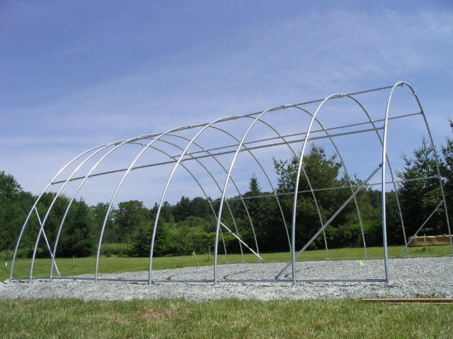

Hi...
I'm currently putting up a "clearspan" 2-car garage from FARMTEK...
See Attachment for picture...
It's 26'widex24'longx12'high... round-top style... 10oz green cover fabric... the main cover has a 3-4' wide clear center part the length of it to let light in... and 2 crank-up garage doors... cost ~$1,500... was a closeout...
Constructing the pipe frame is straight forward once you get the parts figured out... seems top-quality pipe & fittings...
I spent ~6 hours reading the instructions... inventorying the parts... and putting together the 8 main 26' wide hoop sections (4 pipe pieces each)...
My girlfriend and I put all the frame members together... took ~10 hours... and some creativity getting the 1st 2 roof rafters to stay up until I connected 'em with the cross pipes (purlins)...
Worked off an 8' stepladder...
Most pipe connections are "swaged" end pipe... fitting into unswaged pipe end... secured by self-drilling "tapcon" screws...
I still have to square the unit up... anchor it... assemble the rear and front panels and install 'em... then install the main cover...
2 people is the minimum to do the job 3-4 would be a lot better...
Best to set the building on level or fairly levl site... I used 3/4" mixed size aggregate for a level base...
Also bought & installed heavy 6 oz. tarp-like plastic from FARMTEK for a vapor barrier under the stone base...
I compared the clearspan to the Garage-it? brand... clearspan is definately better... but costs more...
You can see a few of their buildings at their place just ouside Hartford CT... that's what I did... there is also one very large clearspan shelter there too... maybe a day trip for you...
This is where they cut... size... and detail and the tarp-like "fabric" for the covers...
I understand they make their own pipe at their place in the midwest...
The round top shelters are best for snow-load areas...
I dunno how of of this relates to the Moo-Tel...
Hope this helps...
Dave...

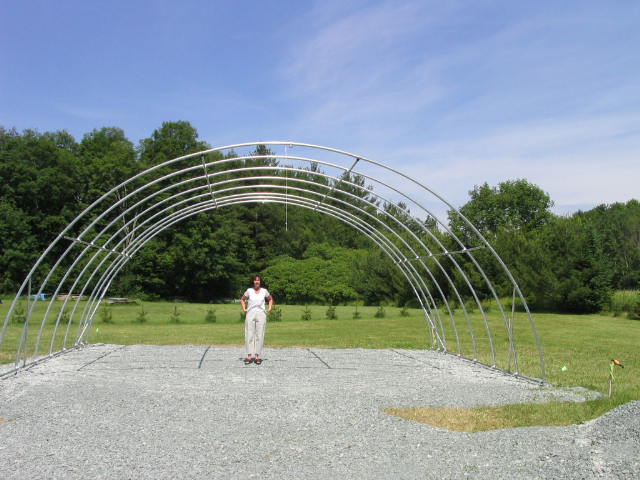

2nd picture...
The roof rafters are spaced 4' apart... I had 1 extra one you see spaced at 2' on the far end... (part of the "closeout" special...) /forums/images/graemlins/smile.gif
Dave...
