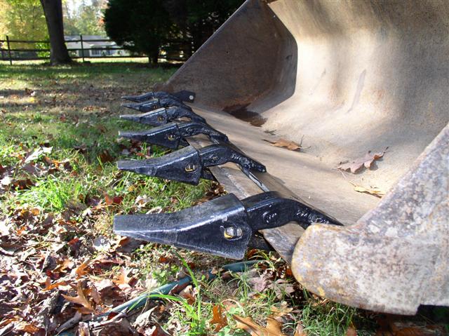

I'll be glad to weld one up for you if you pay for the parts. I takes about and hour.
Guys on Ebay have the Heavy duty cast series 23 cast teeth for $5.40 ea
eBay: Bucket Teeth John Deere backhoe Caterpillar Shank Qty 6 (item 220108562631 end time May-09-07 06:15:00 PDT)
And the shanks are $55 for 6ea + $15 shipping but most dealers have the shanks for about 12ea and you could buy just as many as you needed. I recommend 5ea.
I'm going to the scrap yard this week and I can find the flat bar or buy it at the trailer repair shop.
Here is a pic of my 6ft bar

Shaley,
That is a really nice offer. I am going to PM you to talk about it.

Thanks guys, glad I could help. That's what makes TBN so great.
A couple of other TBN members PM'ed and would like a tooth bar, so if there is any further interest I would like to build them all at one time. I thinkng next week would be good and I can ship at the end of the week. Price looks like $16.00 per tooth + some shipping and flat bar cost. PM if interested.
