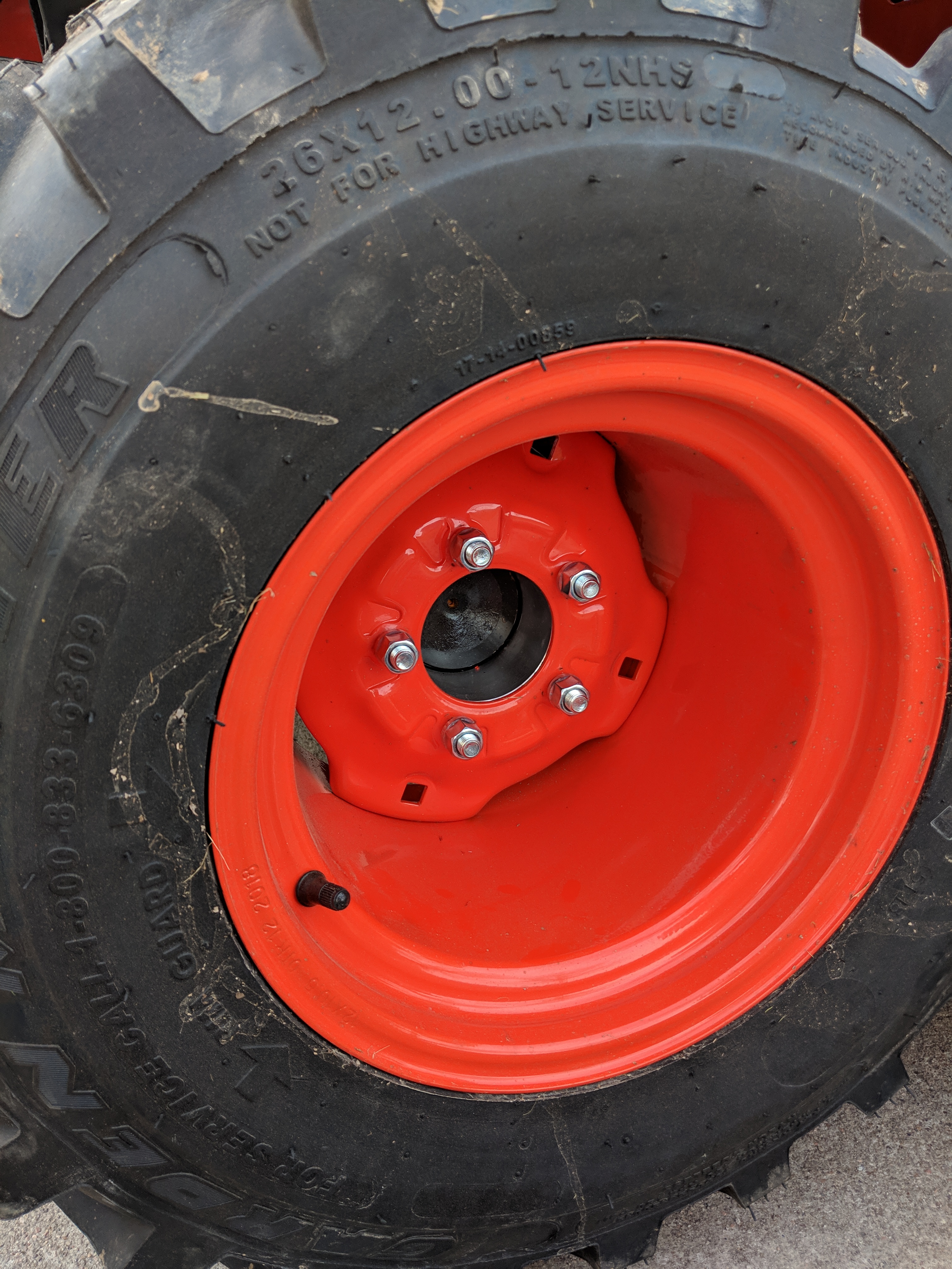

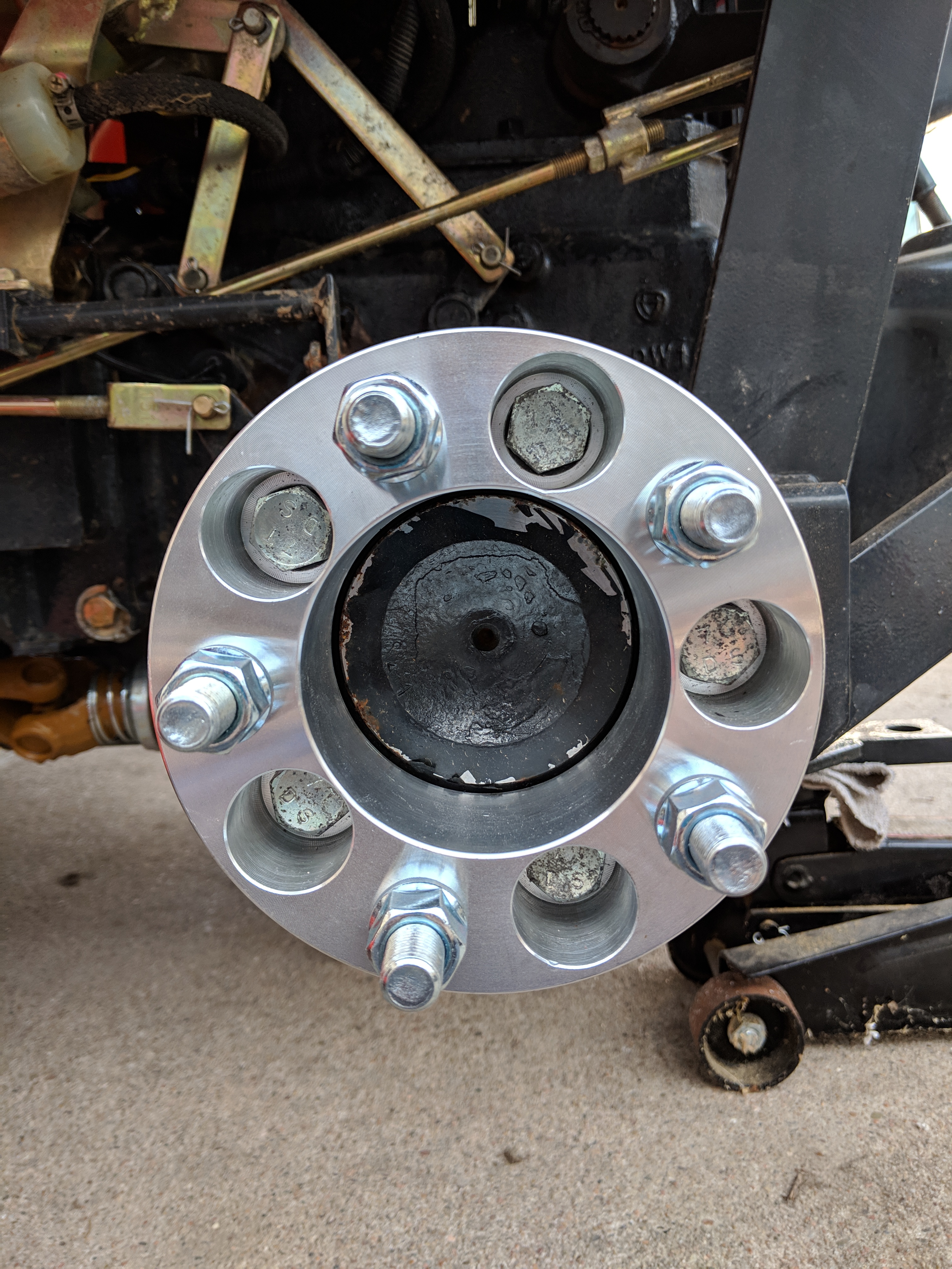

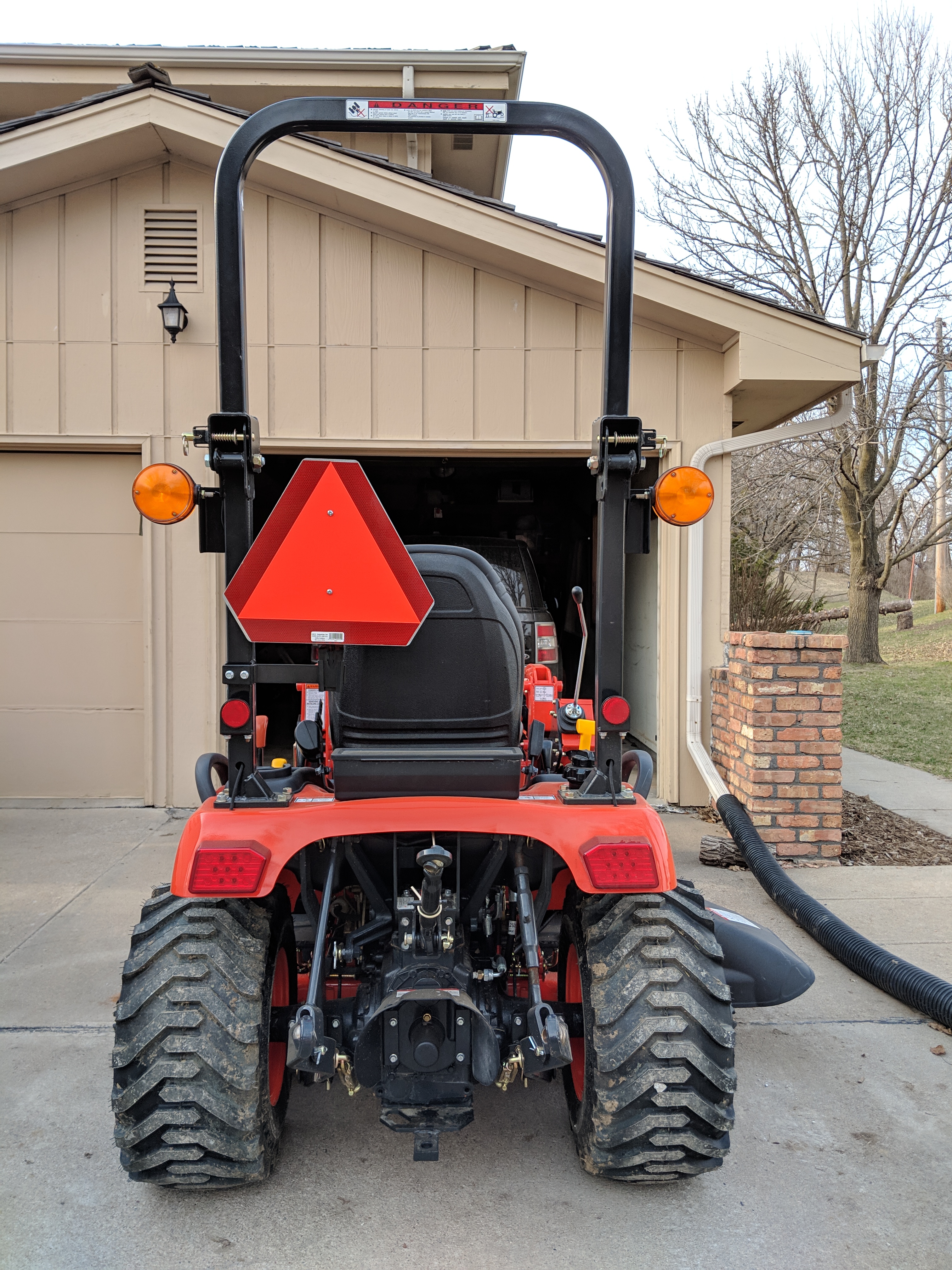

Thought I'd share an option to consider for rear wheel spacers.
The biggest issue I see being that they won't be hub centric, but I'm not trying to pick up 600lbs on the back and go rock hopping, so why not. I measured out the lugs as 5x4.5, with 1/2" x 20 lugs. They coincidentally match that of Jeep Wranglers, so there's plenty to choose from (these were from Amazon). The hub bump measured around 78mm, and I couldn't find any to match this unfortunately, closest was 82mm. But fit is good, will have to see long term how they do if the move or crack, etc. But stability here we come!
ECCPP 2X 2 Wheel Spacers 5 Lug 5 x 4.5 to 5x4.5 82.5mm (won't let me post link cause I'm noob)

No problem. I haven't tested them very long, but the investment is low so worth a shot. I think it will just be important to recheck the lug torque in case the aluminum gets broke in a little with use.

Well one wheel nearly fell off. I knew the aluminum felt kinda soft when first torquing and planned on re-torquing. All but two studs came out on one wheel. I reinstalled and felt much better and firm when torquing, added some blue lock tight for good measure. No further loosening seen. So my official advise would be to snug up pretty good on the first install, run them around for a few hours, and definitely pull them back off and reinstall after short break in. And maybe lock tight for extra credit. Still love having them, made all the difference on feeling secure on my slopes.
