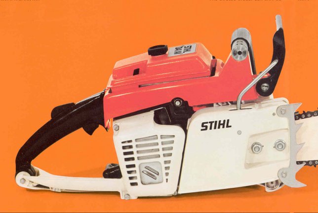

Model Profile: 041 AVE SUPER
Although the picture's at the bottom shows 2 different models , 1 with brake and 1 with-out , Mine that had the brake looked a little newer as far as the mechanical side ??? If that makes any sense ?? I know the older saw "Said " 041 AV on air cleaner , really cannot remember what the newer one had on the cover . But I think they were both electronic , ( if the older one was , then for sure the newer was ) , as I never had any ignition problems .
Fred H.
