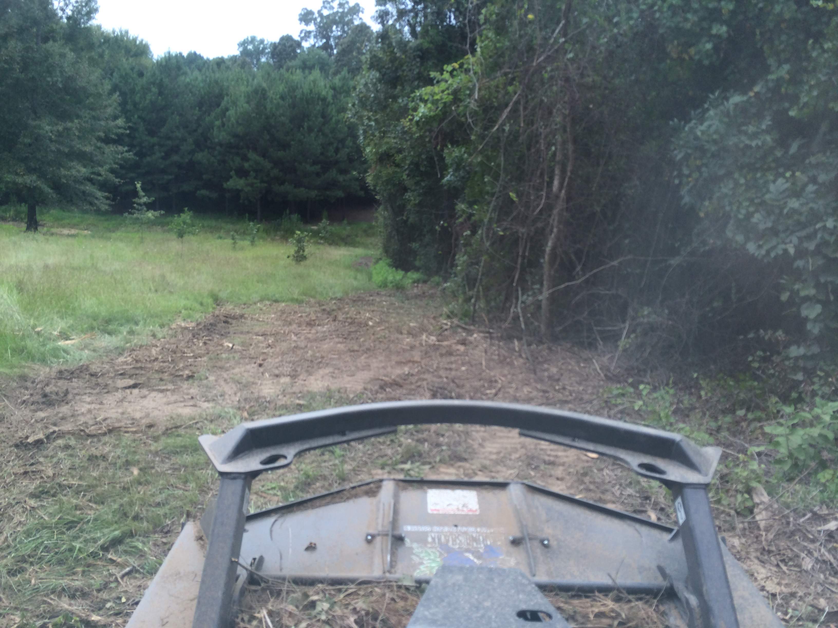

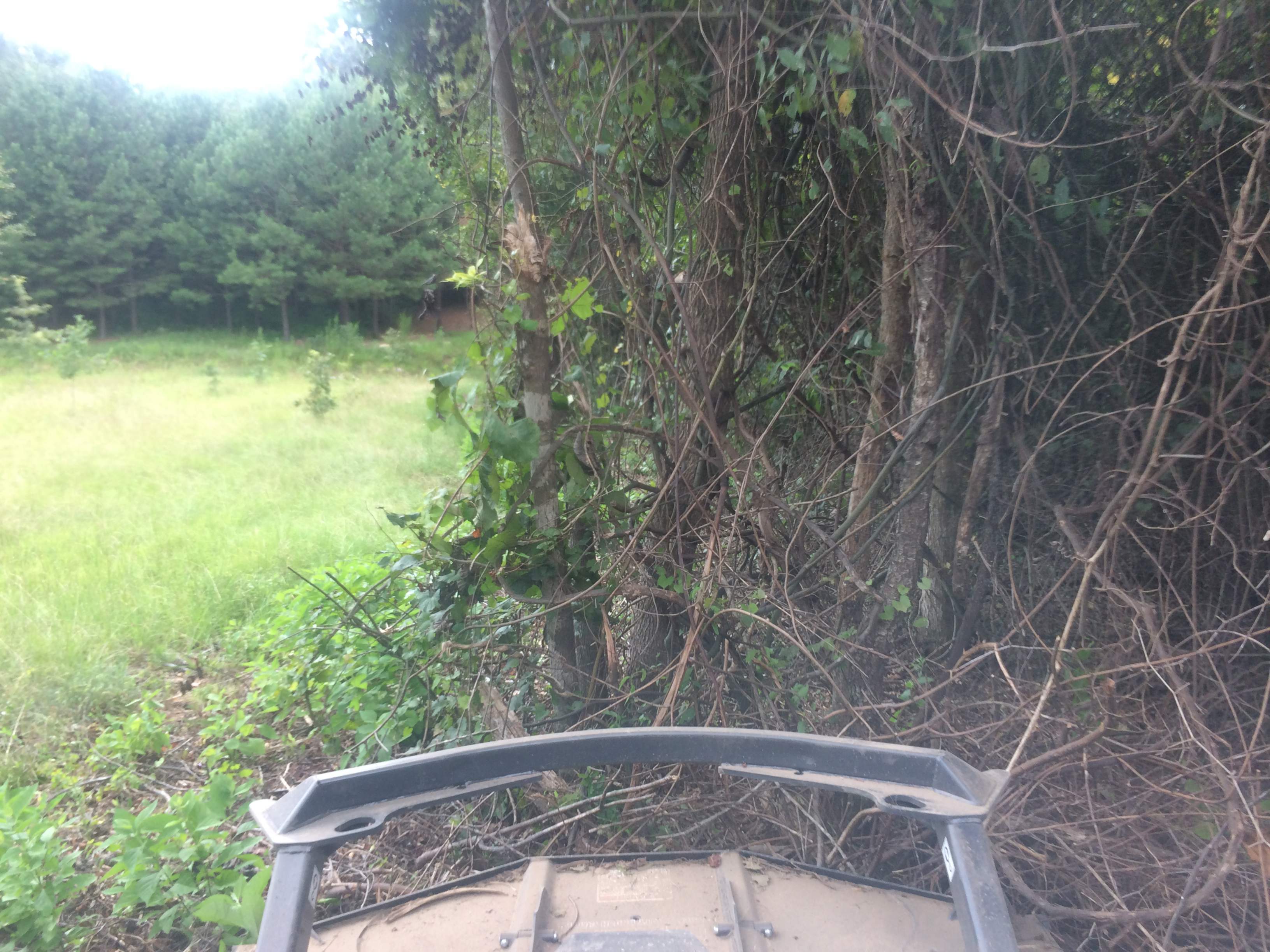

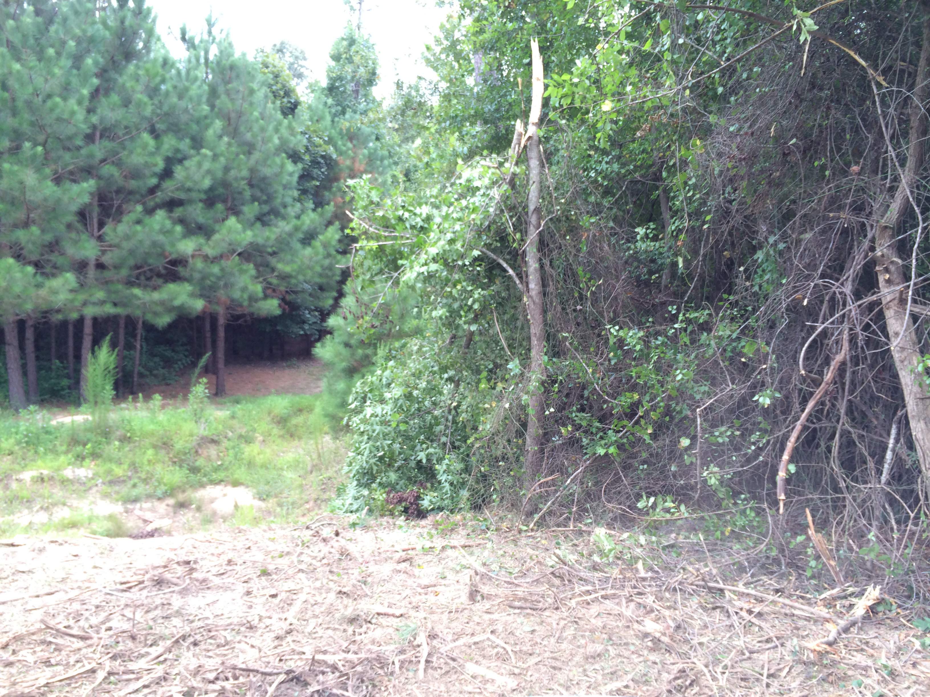

Got my Groundshark in a day early. It can easily do what you're looking for, but it requires high flow hydraulics and a carrier that can lift its 2klb weight. Bradco recommends 2200lb lift capacity minimum.
These pictures are 4 minutes apart.

So how do you compare that to the FH series Rockhound since you are familiar with and used both?
   / Information on Rockhound F-H Flail Shredder #10
I've never used the FH, but comparing it to the 40EX Hammerhead is essentially a non start in accessible areas (Hammerhead is on the excavator). The Ground Shark is a beast of a mower, 4" material is essentially nothing. It's rated for 7" material, but that's conservative, based on my experience today. The blade carrier weighs 600lbs, carrying a huge amount of momentum into the cut to knock down larger material.
For knocking down what you described, it would be tough to beat.
