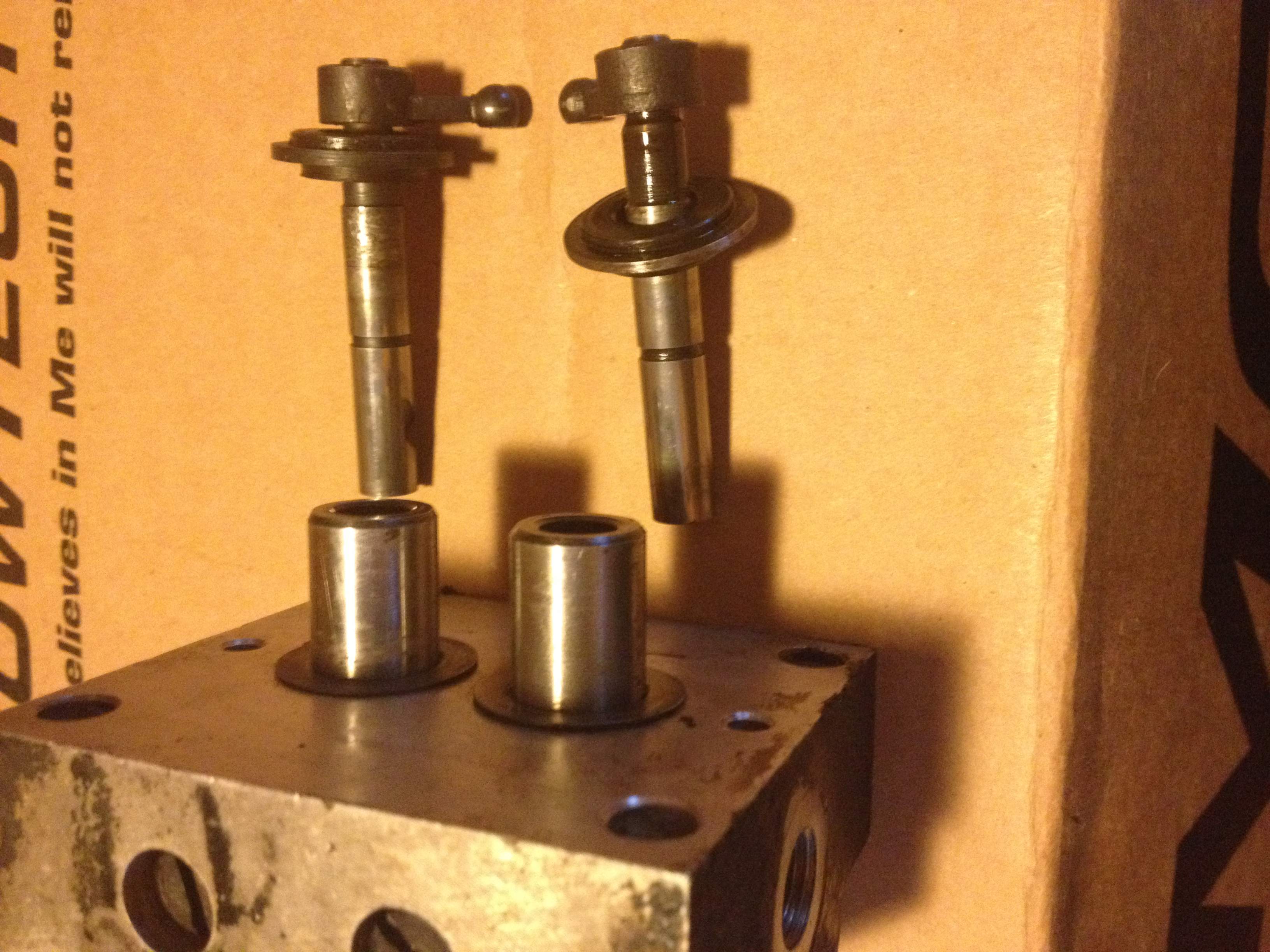

Ok I got the assembly apart and got it cleaned.. I used carb cleaner and ZEP 45 along with a little compressed air... I got them unstuck but as I figured not ever touching anything like this before I AGAIN found myself lost..
Here are the pictures of the assembly. Sorry I do not know the names of the parts but maybe you guys can help with that??/
a pump sort of like mine for reference..
Here are the parts that was stuck up in the tubes

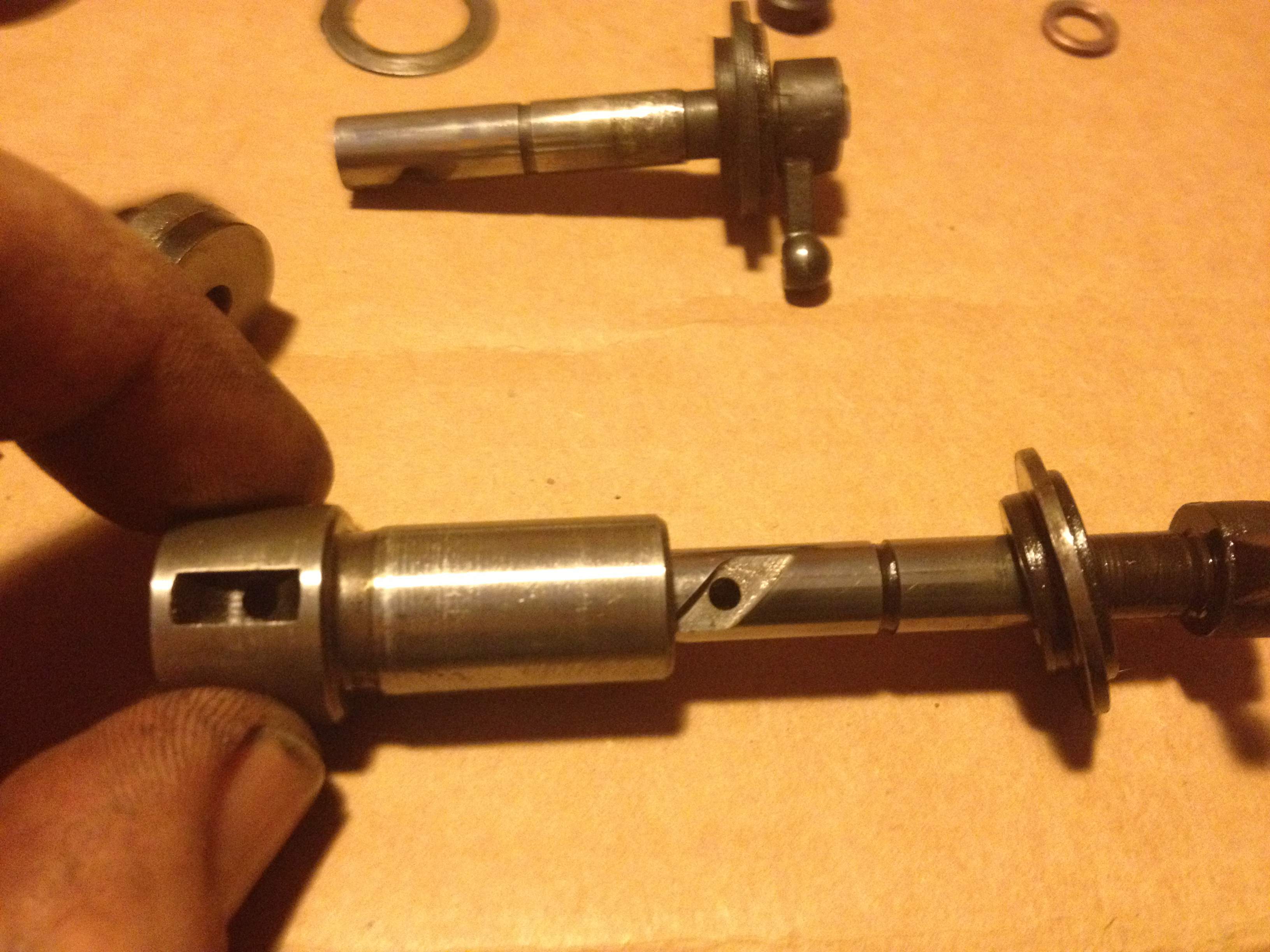

here you can see the shafts that go in the tube.. The tubes have two holes a recess concave hole and a woodruff slot style hole.. There is a pilot screw that you can see in the upper photo with like a dial pin on the end of it.. When I put the tubes back in I am not sure which way they go in.. Does the pilot or dial pin screw go in the slot or the concave hole????????
Here you can see the other side of the tube with the woodruff style slot..

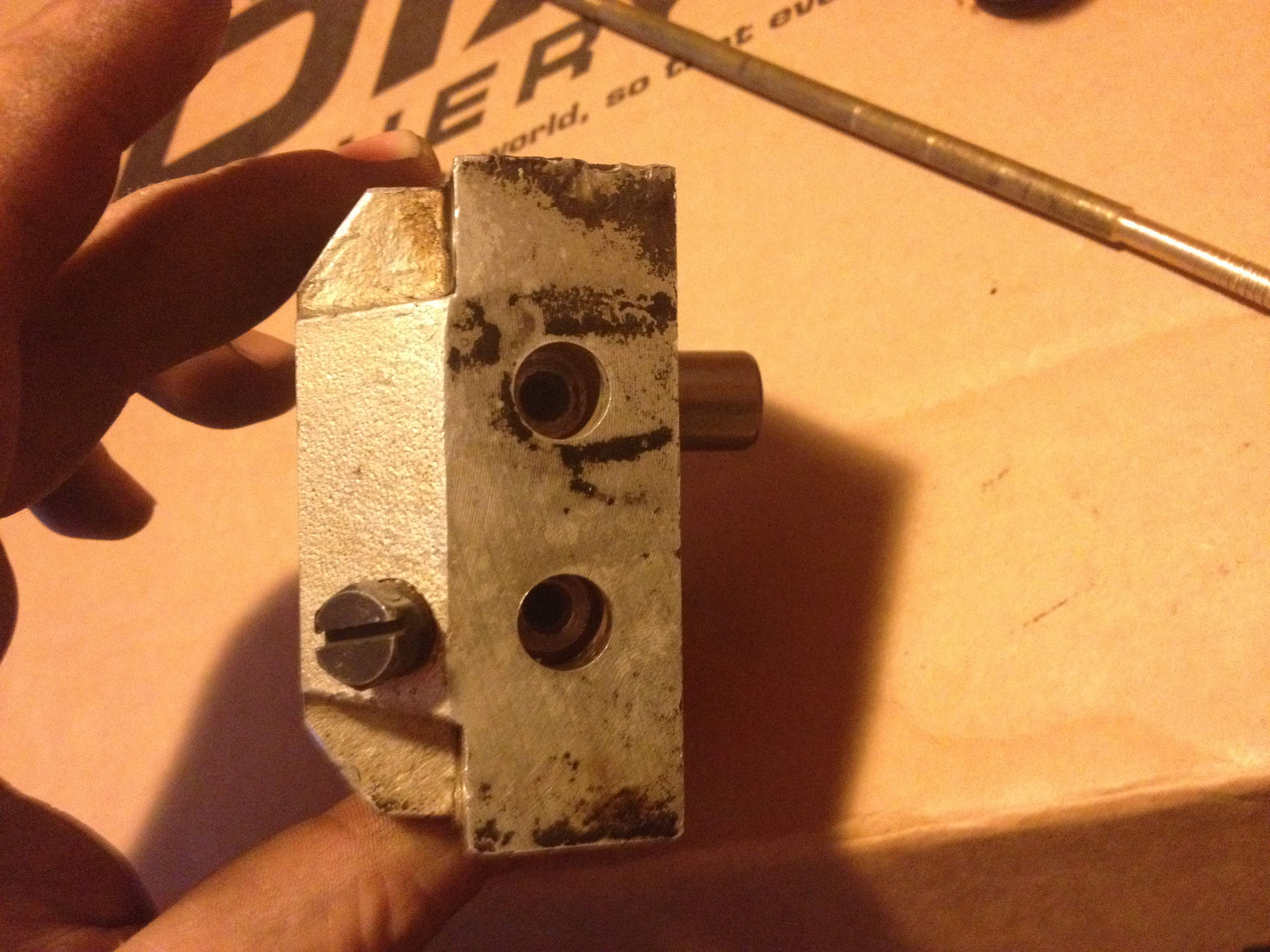

Here is the front of the assembly where the pilot dial pin type screws are installed...
Not knowing ANYTHING about these things I took all the screws and small parts out afraid of breaking or gaulling something.. I have done things like this way to many times and finally learned that things break when you try tapping or pulling them apart.. What I havn't leaned is to TAKE FRIGGIN pictures... I was more afraid of breaking something that I didn't take a mental not of looking in the holes to see how things lined up..
This tractor literally don't have any litrature or manuals.. Its a little jap import tractor.. Stout and durable I have been told but not many places to buy parts or get information..
I am sure that the concepts are all the same just maybe manufactured a little diff or things in diff places but maybe you guys can tell me how these tubes go back and if the whole pump needs to be filled with oil..

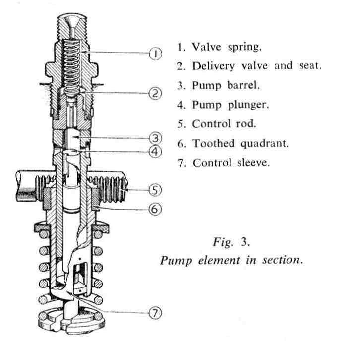

Here is another picture of the pump assembly that I have found on the net.. You can see on the left side there is a concave hole but the other side is flat or in my case woodruff or slit.. The pilot pin screw I AM ASSUMING is the hole the sleeve in place while the plunger goes up and down.. I am just not sure how these sleeves are supposed to set inside the housing and how the dial screws are supposed to screw onto the sleeve?????

You've succeeded in taking apart a very close tolerance IP that you say has sat for years with water in it's fuel tank. Do you even know which pump plunger goes with what cylinder? The questions you ask ought to have been asked BEFORE you took everything apart, seemingly in no particular order, and with no pics or notes as to what went where?!:confused3::eek:
The parts look to be severely scored and/or worn in certain places, especially near the 'collars' of the pump plungers. This kind of work is best left to EXPERTS who do this type of work everyday, have the specs and tools for diagnostic testing BEFORE disassembly, and parts to rebuild the pump IF it can be brought back to proper tolerances, assuming it hasn't been ruined by abuse, misuse or lack of use over time. Rebuilding of these pumps by the manufacturers who made them is often done in a 'clean room'; a place where even microscopic dust is filtered out under negative air handlers and the techs are wearing head to toe suits that also eliminate any particulate contamination.
You may have managed to get the pump access plates off, and free up seized plungers, but I highly doubt that even though you now have a spray pattern out of the existing injectors that the IP is anywhere near delivering the correct amount of fuel at anywhere near the correct piston timing.
I would hazard a guess that the IP gets it's lube from the engine via a pump internal to the IP, but I cannot say for sure because I'm not familiar with your tractor or it's IP.
Do take pics before, during, and after disassembly, of anything like this IP in future.
