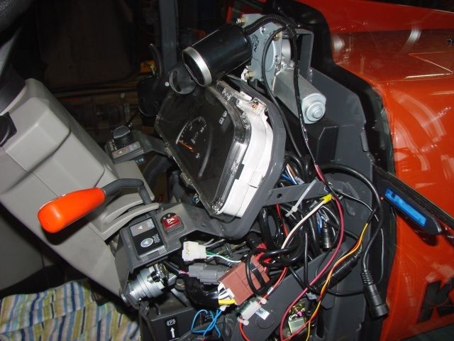

Can anyone tell me how much clearence there is from the very top of my dashboard to the circuit boards? I would like to mount a billiard ball sized compass there, but im afraid of damaging the circuit board with the mounting screwes.

I figure you got about an inch.
   / Inlellapanel 2008 GL 3540 #5
Is the plastic cowling hard to remove? I would opt to go that route and make sure the screws will not hit anything or chafe on any wires. You could even put a little RTV on the ends of the screws, let it dry, and then put the cowling back in place.
   / Inlellapanel 2008 GL 3540 #6
There's 4 bolts and one Phillips screw to remove to get the plastic cover off around the instrument cluster. Each of the 4 bolts take a 12 mm socket. I use a 1/4 drive and they are located in each corner of the cover facing forward to the seat. The phillips screw is up by the display facing you on top of the cluster display. Look close,its there but counter sunk. Takes about 5 minutes to remove. The hardest part is pulling up the cover around the throttle lever. I usually put the lever at full throttle and that makes it easier. To install, reverse the procedure :D
