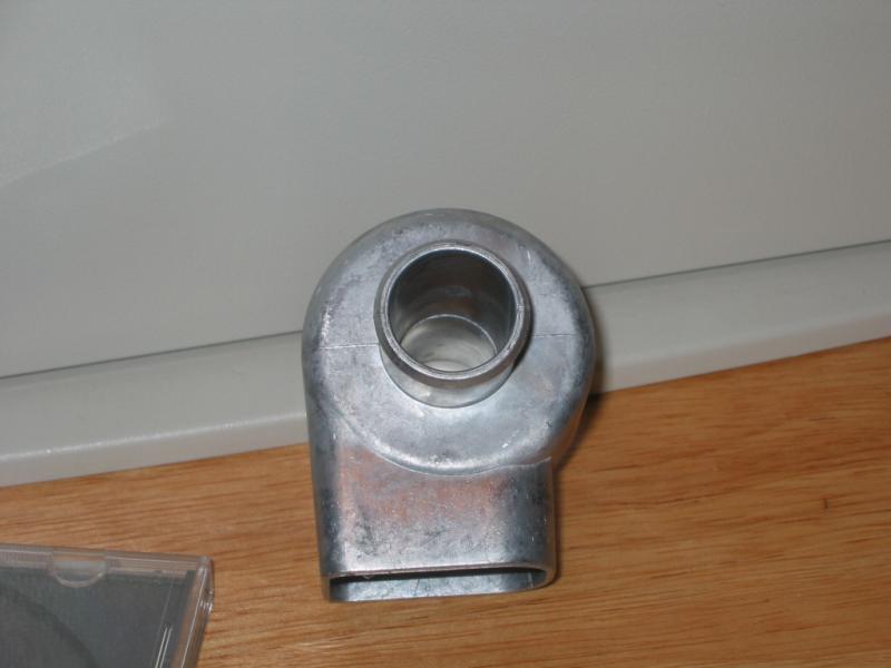

Can anyone post a pick of the Kubota Inline engine heater. I just bought one and want to see if its the same type. My concern is the heater housing has no way to circulate the water throughout the block.

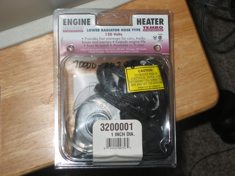

Here is a box i was given as the "kubota part", its not a kubota product and its brand name is zerostart. The kubota part number is 70000-00298.
This is a picture of the box.

Here is a picture of the heater housing itself which goes inline. The housing says it needs specific hose lengths and also specific inclines until it gets to the motor to operate properly. I assume this is not the kubota brand heater and was wondering what there heater looks like.

If I am not mistaken, Kubota makes a freeze plug heater. If you are going with an external heater, why don't you get a tank type circulating heater. JCW has them in their catalog.
   / Inline Engine Heater
The freeze plug kind is for the 1830 and 2230 the 1500 only has the inline kind. I want to know if there is a specific one from kubota or not though. They dont have a freeze plug on for the 1500.

For inline heaters pick one that has the proper diameter for your hoze and the wattage you want. Make sure it is installed correctly for flow direction and it may also require a specific vertical orientation.
Not to worry about heating. It circulates by convection and will do just as well as the ones set into the block.
