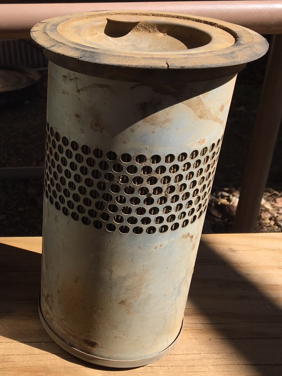

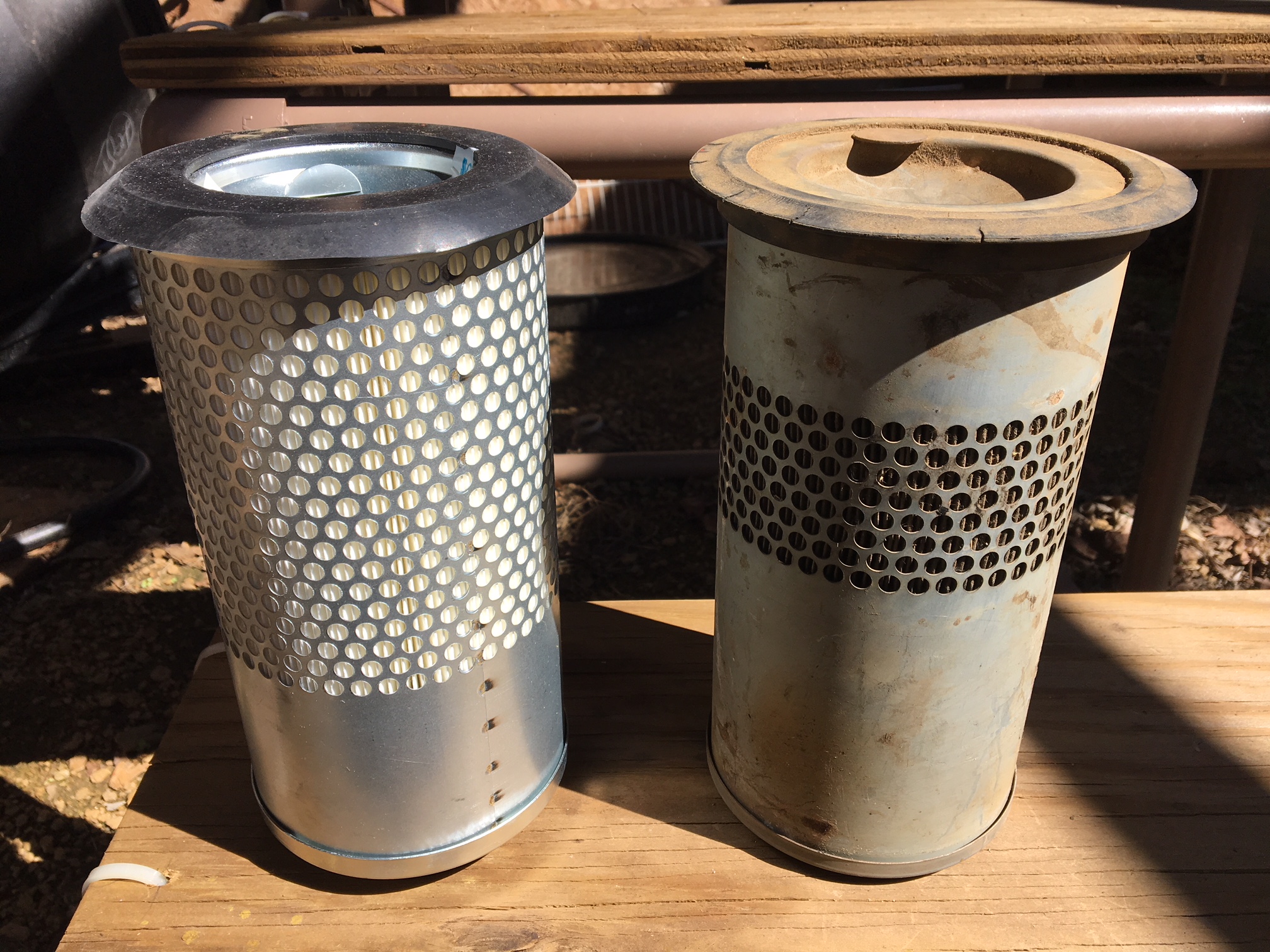

I ordered two filters from an online supplier. Using their website I located the two filters that should fit my tractor. Wwhen ordering I sent them my serial number to verify fitment.
Long story short, the inner filter doesn't fit. The opening is too narrow compared to the one I took out. I didn't try to the outer filter, but the outer rubber seal is slightly smaller than the one that came out of the tractor.
Does anyone have the OE part numbers?
Here is what I ordered, 1688092M2, 1688093M2
Side by Side views
Thank you in advance for the assistance.

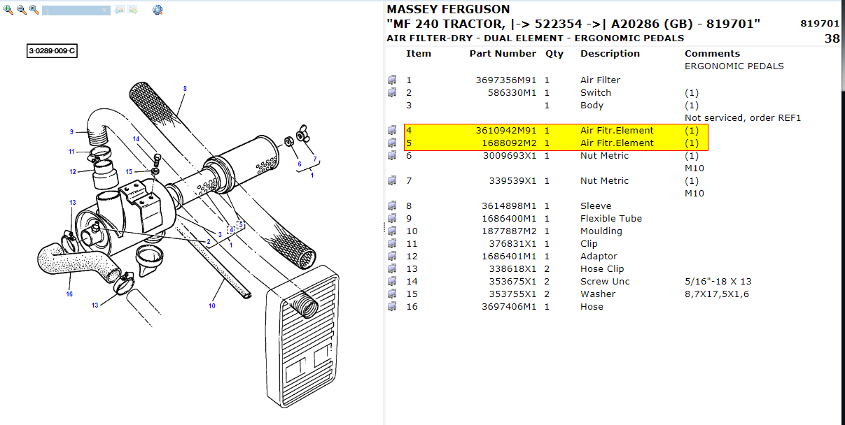

I found this online I am not sure why the parts supplier found something different.
2018-03-06 15_56_42-AGCO AgcoPartsBooks.com - _MF 240 TRACTOR, _-_ 522354 -__ A20286 (GB) - 8197.png

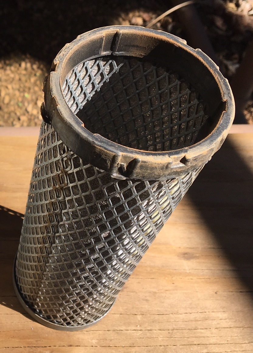

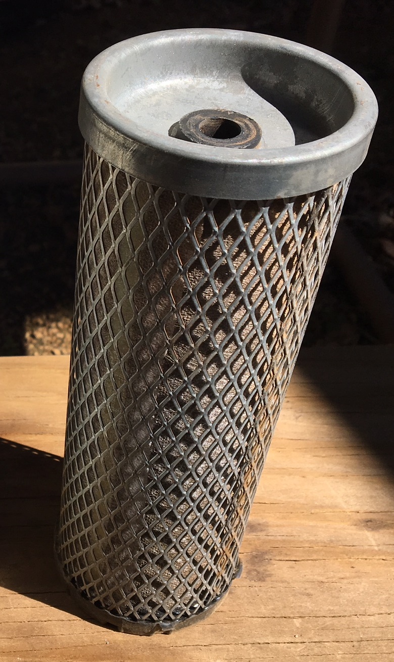

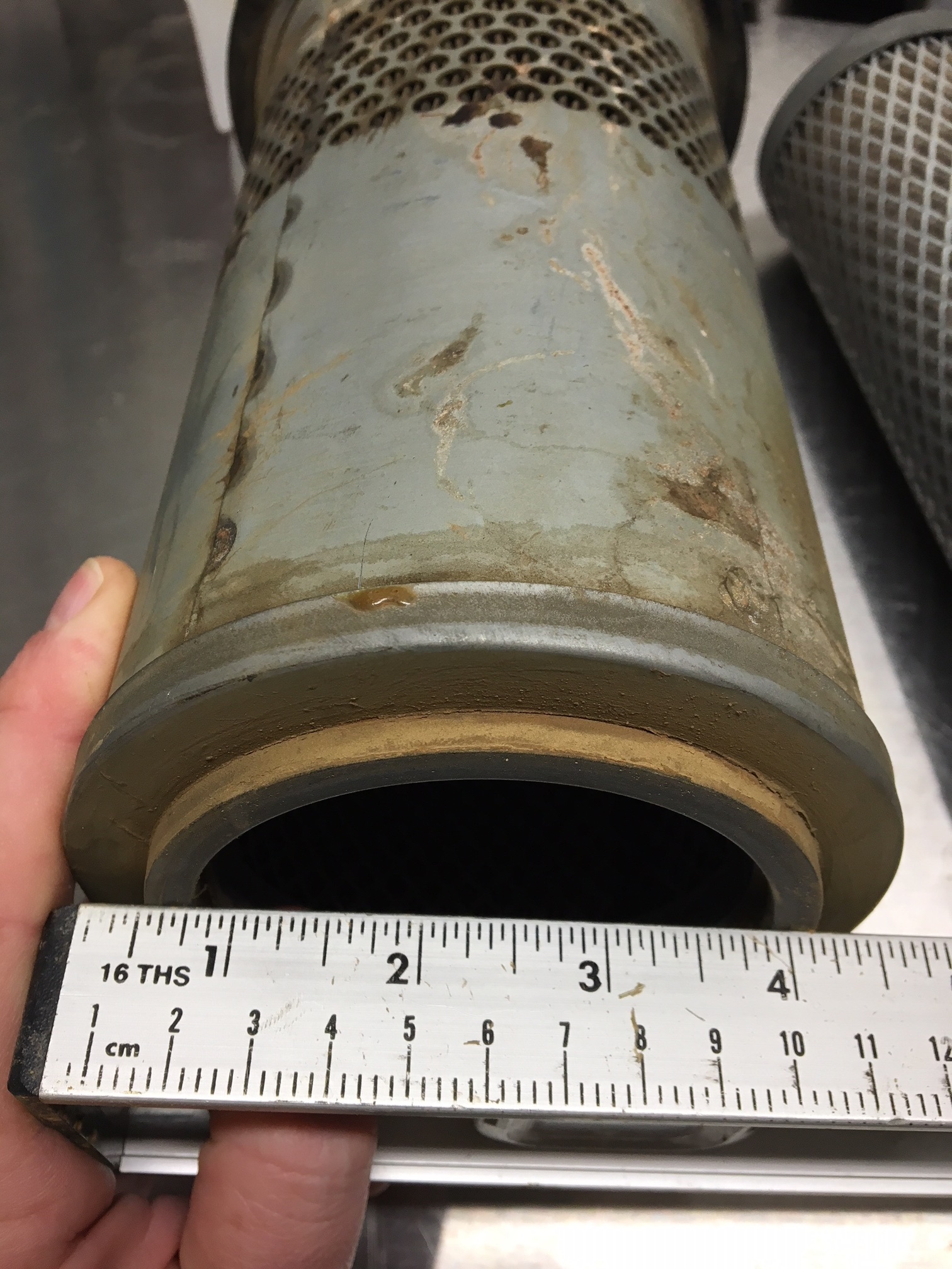

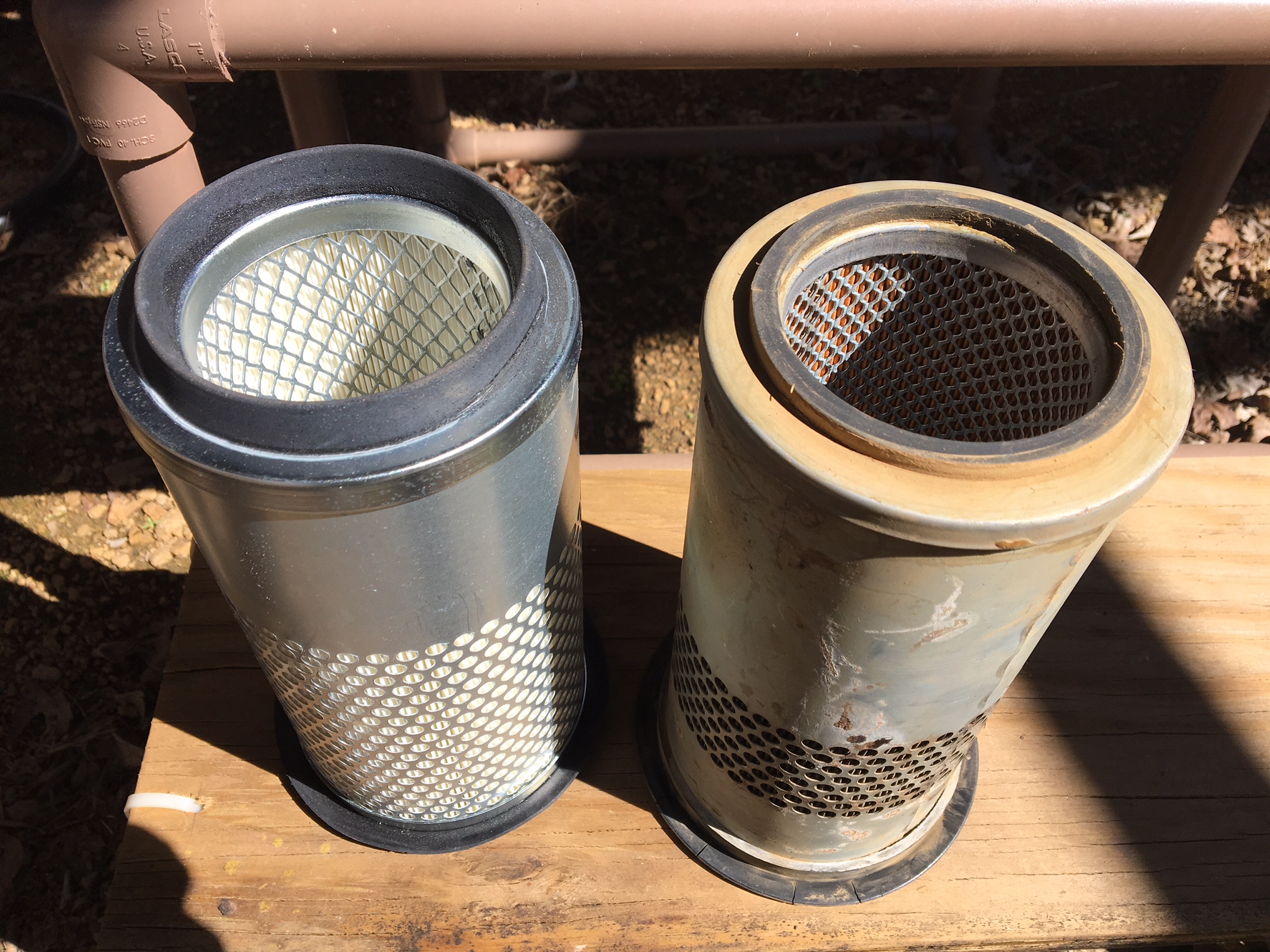

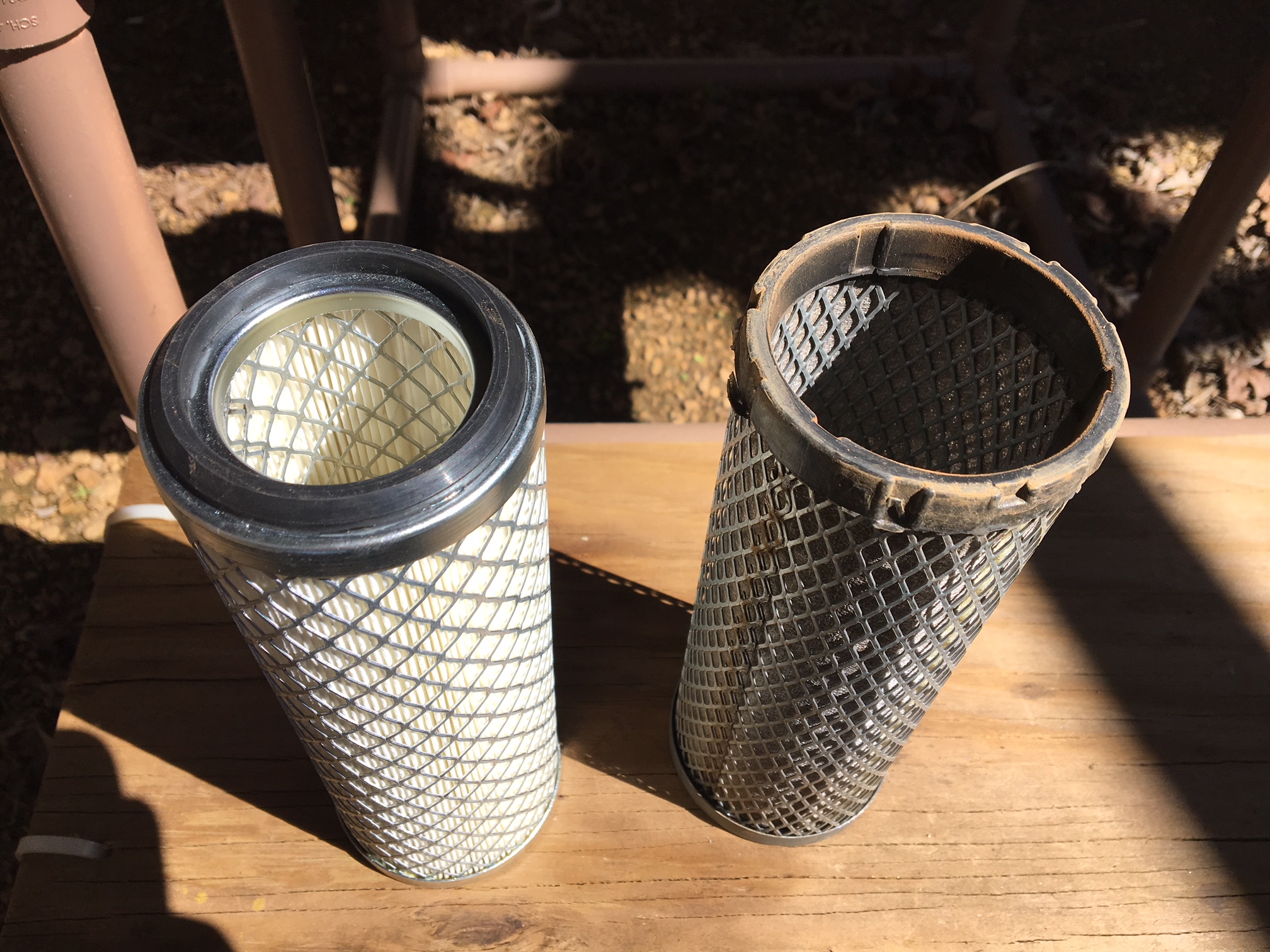

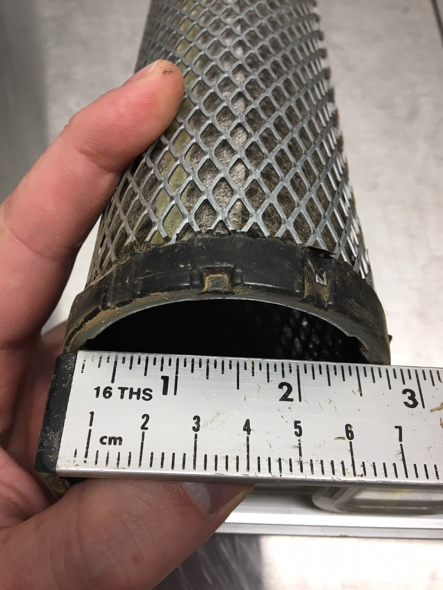

I worked with a local dealer to try and determine which inner filter is required but they were unable to locate it. They recommended 3824032M1 and 3824033M1 but the inner filter had too small of inner diameter to fit.
Here is what I have....
The search continues....
   / Inner and Outer Air Filters for a 1993 MF240 (Part Number?)
I found an unlikely source of Massey Ferguson tractor parts, Godley Auction. While AGCO does not list them as a dealer, they had many OE parts in stock. Larry was very helpful getting me what I needed.
