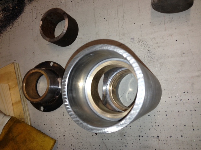

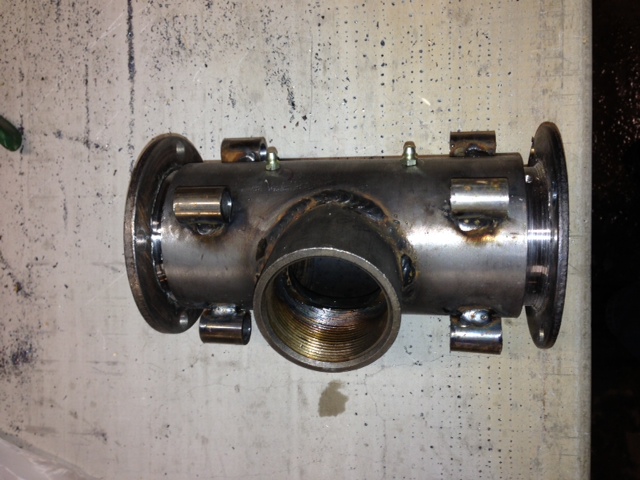

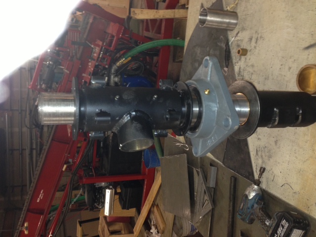

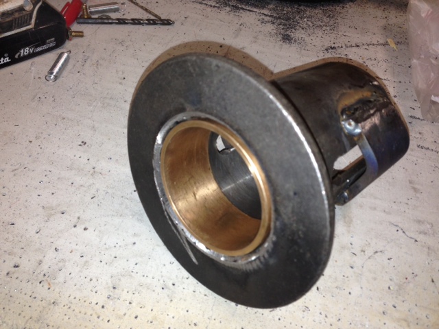

I will attach a few pictures of some sub assemblies I have worked on and one of the prototype control panel. Feb. 4 I start the first production run attempt with my two man green crew and I:)))) They will be made to order as they are not toys and I can not afford to do anything else but make to order:(
The last design choice I have to make is to use or not use schedule 80 2 inch black pipe for the drill pipe? Many have done so with success but Murphy tends to stay near me:)
Gray
