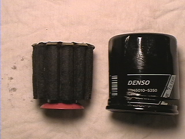

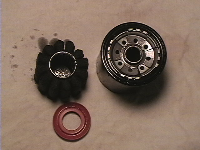

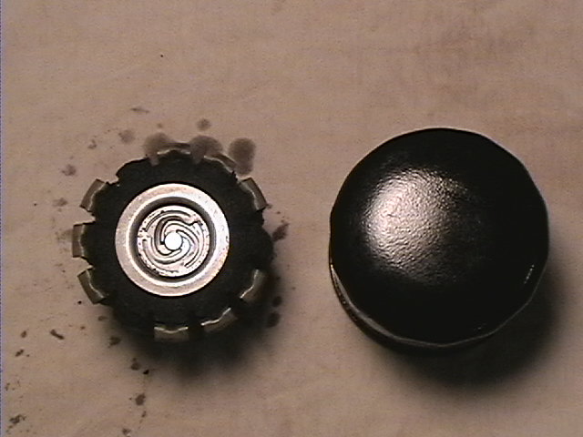

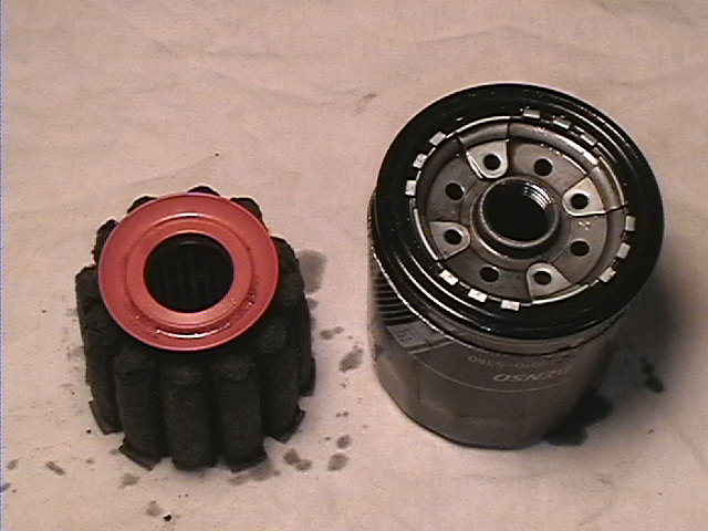

It was time for the annual oil change on my Mahindra (Mitsubishi) 3215 tractor, so I decided to cut open my used Denso oil filter. Was suprised by what I found. The filter material is best described as compressed felt formed in 12 large pleats. It was saturated with oil, like a sponge,firm and brittle. I could easily break pieces off. There are no top or bottom caps like American made filters either. Interesting stuff. I've never seen a filter like this. Wondering what you all thought?

I risk getting all kinds of flack, but to me it shows the whole "you must use OEM oil filters" to be mostly bunk. Give me a known good commodity like a Hastings/Baldwin/Purolator any day, everyday.
Who knows? Maybe that filter is the cat's meow. Shrug.

Doesn't matter what we think, send it to one of the "oil filter comparison" website authors. Despite the fact that it has a different type of filter media than they're used to seeing, (and despite the fact that different medias perform differently), they'll still evaluate it in the same manner.
They'll spread it out on the kitchen table, and then measure it's surface area with a tape measure.
Theories and conclusions will be plentiful, hard data from testing will be conspicuously absent.

There's two versions i believe of the denso(havent seen many) filters some are made in Thailand(US Version,traditional media) and the Japan Made(one you have) but pricy??
the one you have is actually a good filter with silicon ADBV, deep unique pleats capable of long OCI with a rating of IIRC...Nominal of 20um+/- @50-60% so it's above average.
how much did you pay for this filter if i may ask???

$22 through the tractor dealer.

Yea that's what i thought good filters but not Worth $22, you could cross that over and get the same performance or better.
for less...
