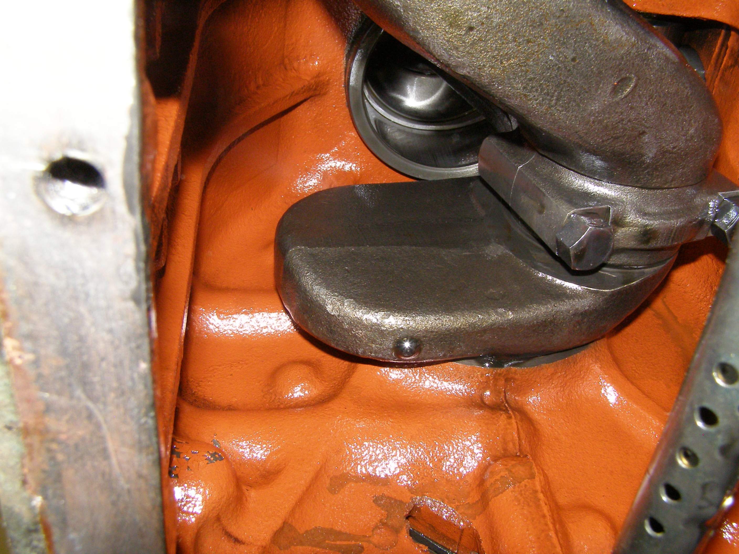

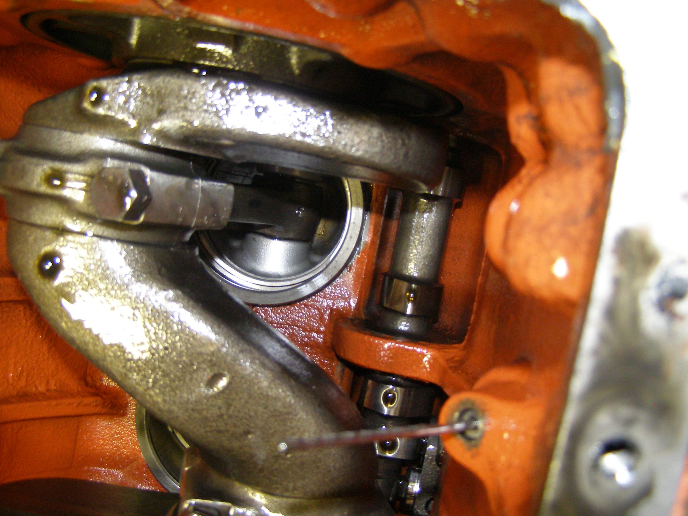

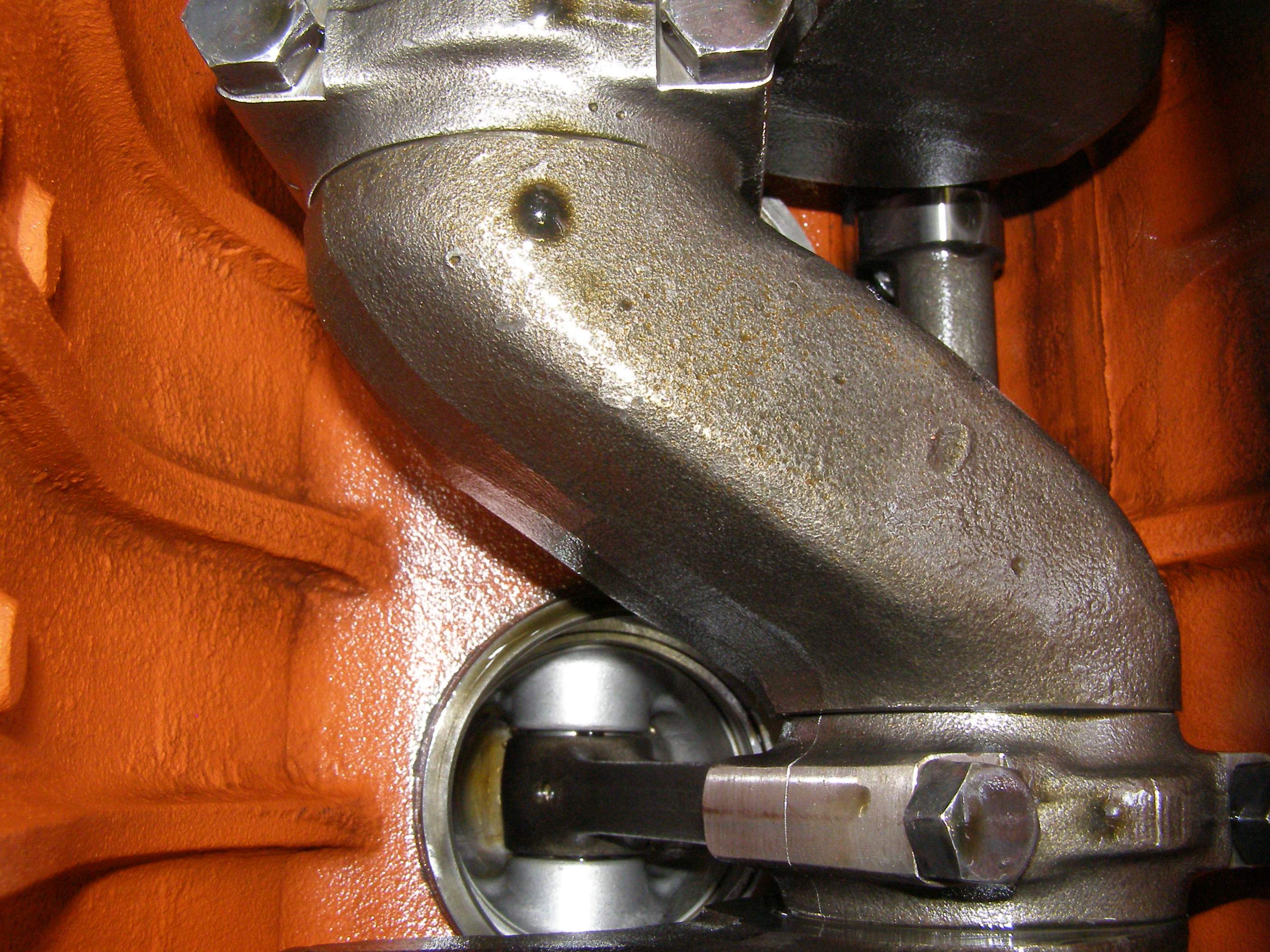

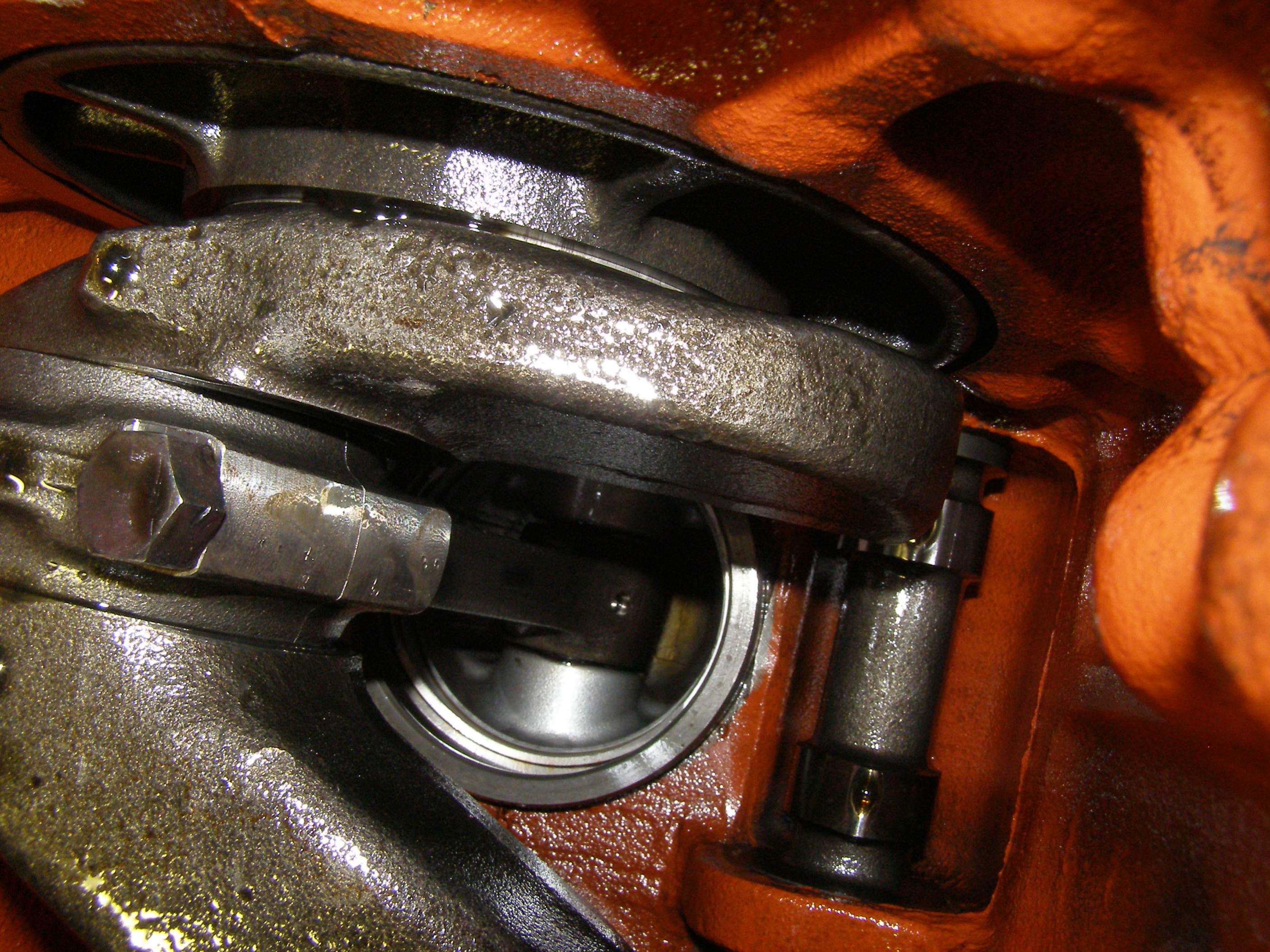

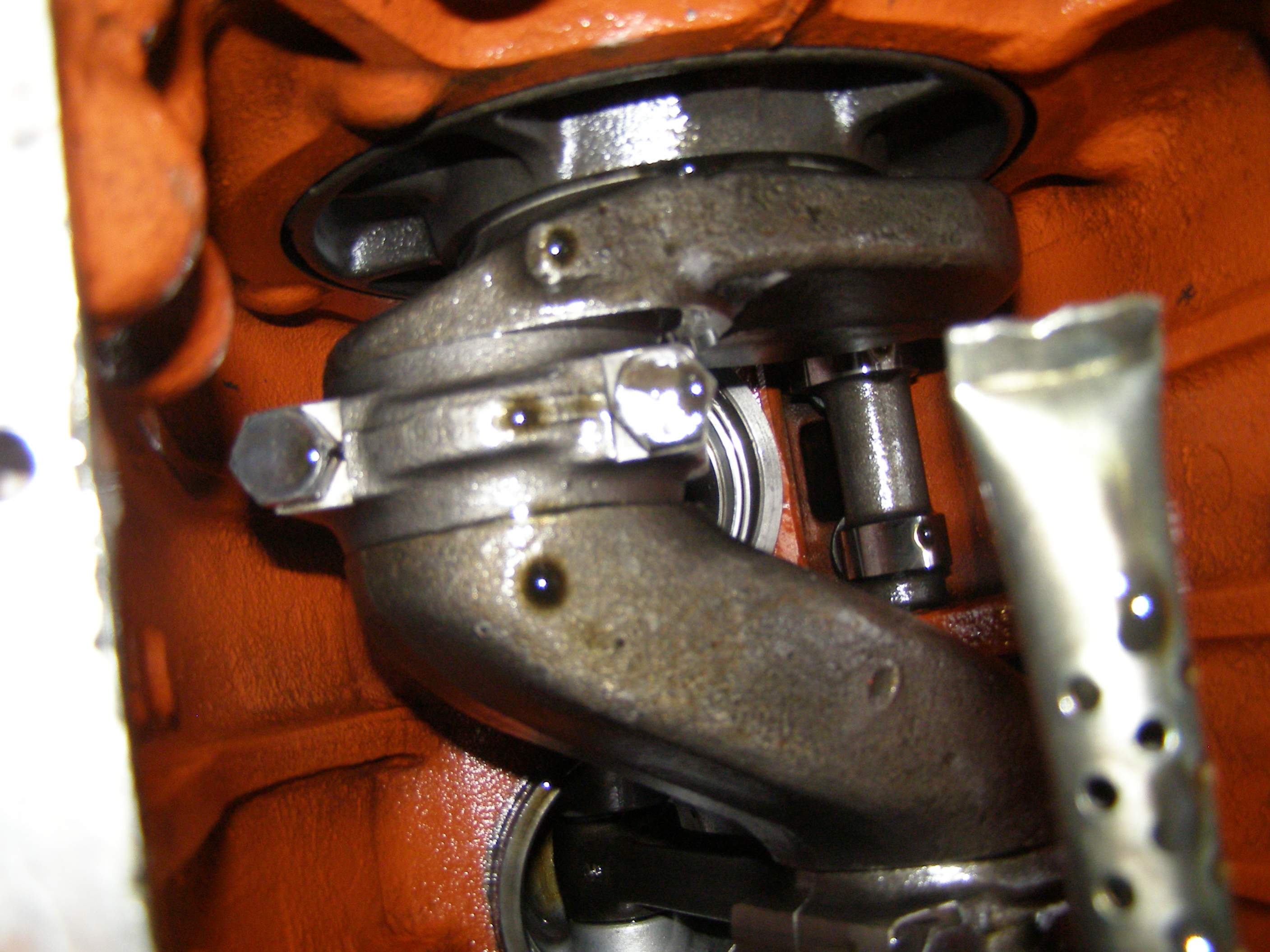

I took off my oil pan for the 1st time to make sure everything was good with the motor. (I know they sound like a hammer) But being my 1st one I wanted to make sure the rod bearings were good no play.
It looked really clean and everything was good - ie no worn bearings.
I just wanted you guys to see how clean it was in there. I was amazed.
Even the lower portion of the sleeves look good.

Gee! That sure looks familiar :) Put that sucker back together and run her. I noticed the Kubota orage paint inside the engine when I rebuilt mine too.

The thing looks like its been gone thru. Do they all look that clean?
   / Inside the oil pan YM1700 #4
Mine and now yours are the only ones that I have ever seen the inside of. Mine looked good down below too. Mine ran hot and had smoked the rings and pistons. I ended up replacing just about everything except for the main bearings. I wanted it to be right and not have to worry about it anymore. I believe the original problem was a blown head gasket. It was a supposed recon. I don't see any way that the head was ever taken off unless the put the old head gasket back on it.
