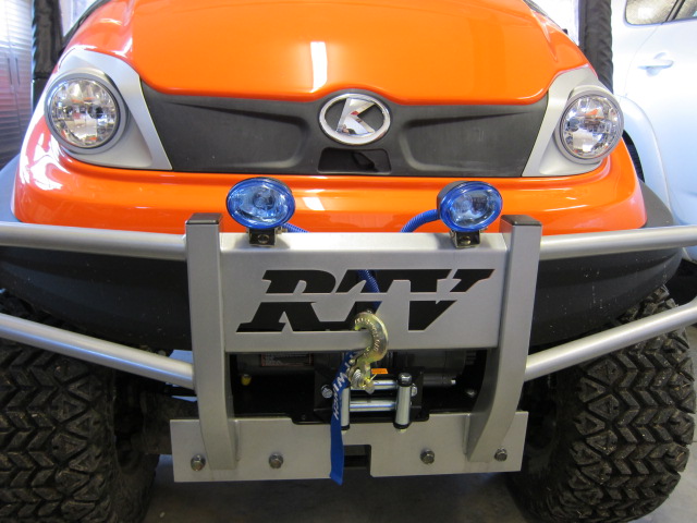

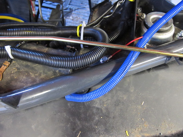

Here is a pic of my additional running lights. These lights are 55 watt and the ground is connected under one of the large bolts under the hood (it's the red wire in the second pic) One of those bolts already has a large ground strap wire under it (it's the bolt in the far left of the second pic). Also found an unused wire under the hood that is hot only when the headlights are on. Used that wire to power the running light relay.
On a side note, I just installed the KFI 4500 lb winch in the pic too!

If the winch works, you should have an adequate ground.
The winch ground goes all the way back to the battery. The ground under the hood is only for the additional running lights. I would always run a solid ground from the battery for something with a high current like a winch!!
